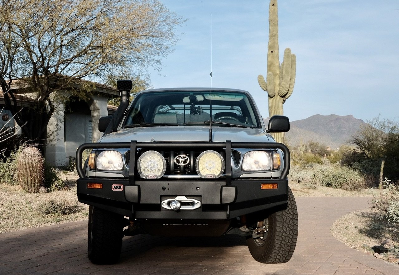

    That’s how she sits

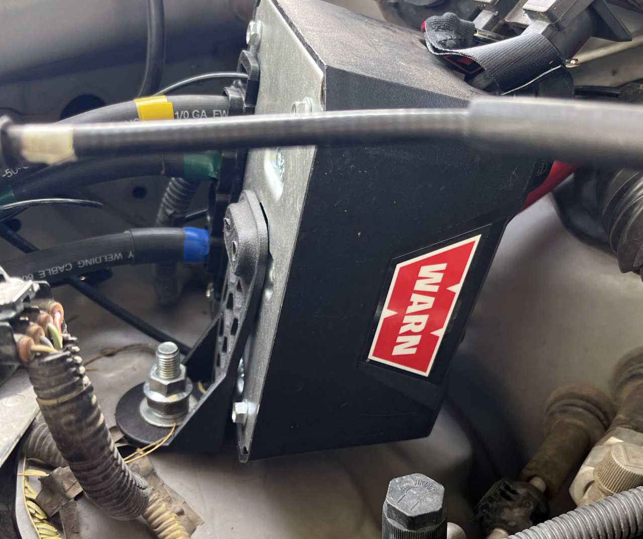

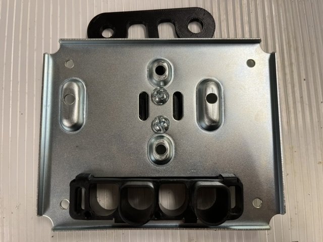

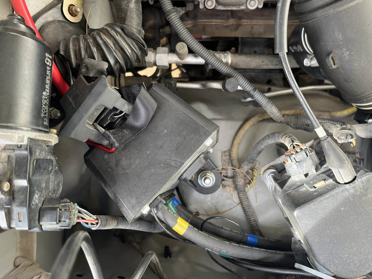

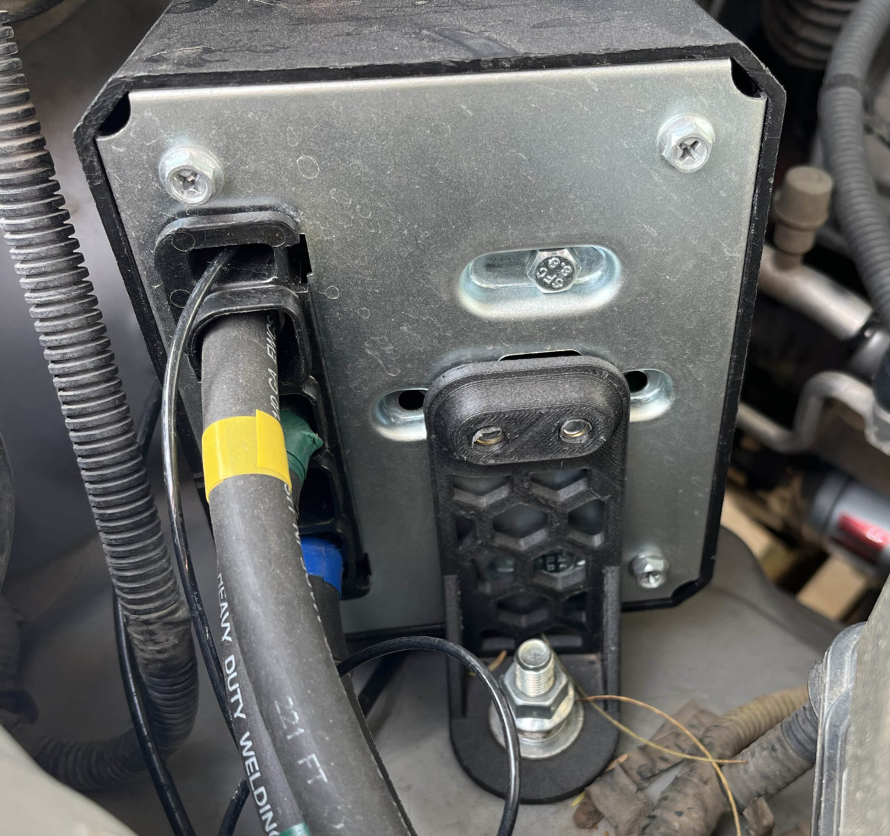

    Any pics of the control box mounted? I need a place to mount the control box for my M8-S too

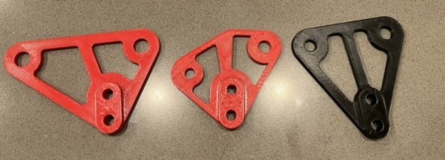

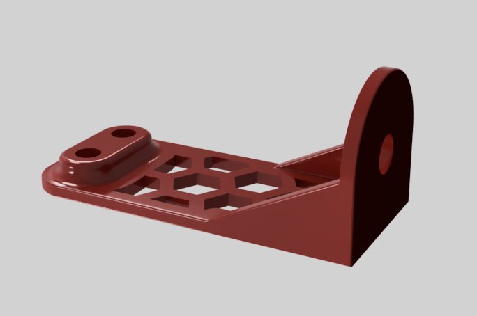

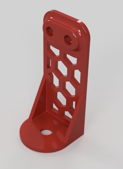

    And FWIW here is the render of the bracket:

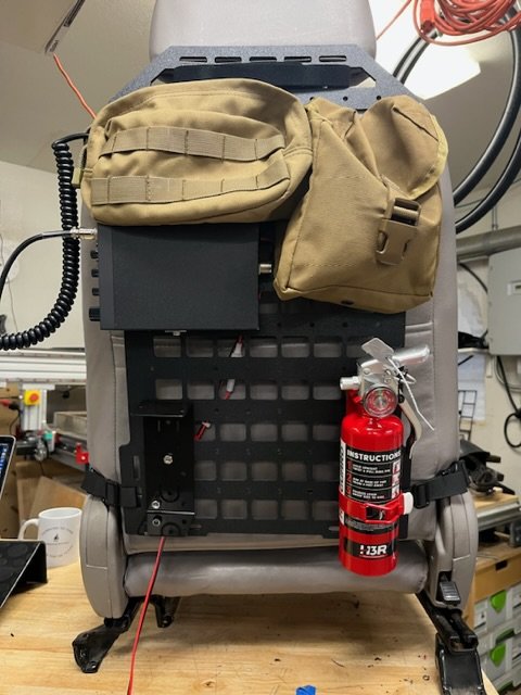

    They fit well in terms of width and length. The install is flimsy because you rely on straps to attach to the headrest posts at the top, then wrap a long strap around the bottom of the back. So the whole the whole thing flaps around when loaded if the car shakes in any way. It will be easy to make a 3D printed attachment at the top, but the bottom will be much more complicated.
    That said, the functionality comes from securing loose items. I will leave my fire extinguisher mounted on. Have bought 3-4 of those fake military pouches and keep small things (maps, camera, binoculars, handheld GPS, snacks etc) into them.
    As for the radios, they swivel and come loose, and the location is not that great, so will remove them. Very tempted to just get rid of the CB radio altogether, and keep the ham radio only -- I use the latter every day on my commute to work and driving around.
    The quality of the panels seems good. I ordered on two separate occasions from the same vendor (reorder on Amazon) and the panels are completely different.

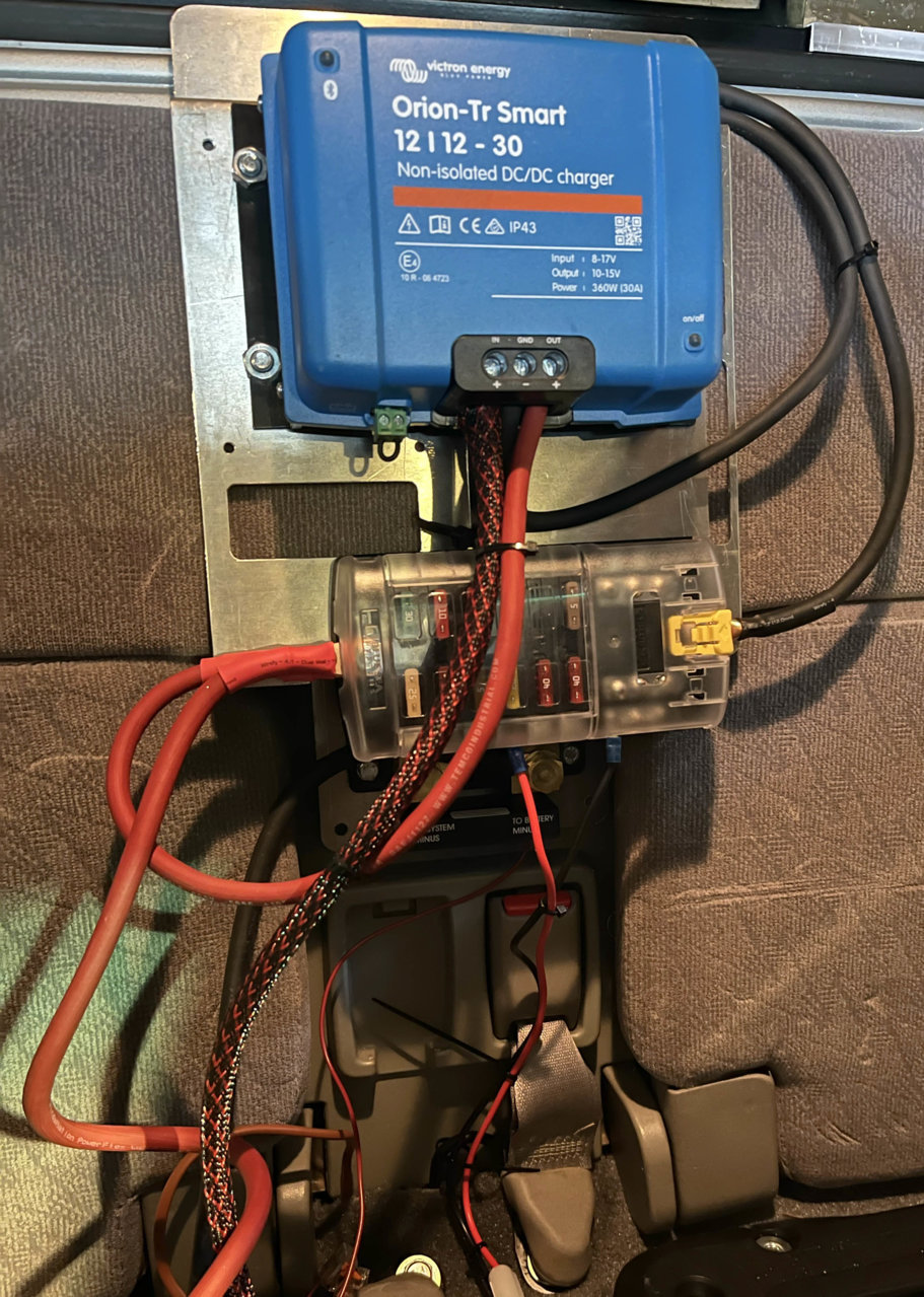

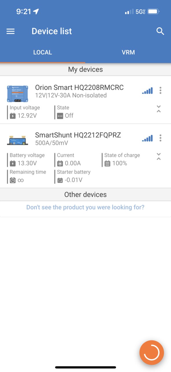

    Changed the electricals a bit. Got a Renogy 100Ah deep discharge AGM batery; didn't go for LiFePO4 because of price. Initially wanted to use a charging relay (Blue Sea Systems ACR) but replaced that with a Victron Orion TR DC-DC charger.
    I have the Victron Smart Shunt mounted just below (and partially hidden behind) the Fuse box. Obviously will need to clean up the cable management.
    The system works very well, charges the house battery and isolates it from the starter, using engine off detection.Can leave the ham radio on with the engine off, and will power a fridge in the future.

    Thanks for sharing! Great work. Could you share the stl as well?
  19. Mar 24, 2023 at 8:31 AM
    #159
    koenbro
    koenbro [OP] Well-Known Member
    Feb 7, 2017
    #209951
    307
    Phoenix, AZ
    2001 Tacoma SR5 Xtended cab 3.4L 5Spd

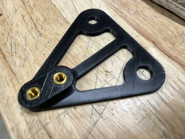

    Here you are:
    Warn winch control box v7.stl
    I use heat set threaded inserts for most of my 3D prints; IIRC I used 94459A370 for this.
    If there is a problem with the download, I also posted on Thingiverse.
    Enjoy!
