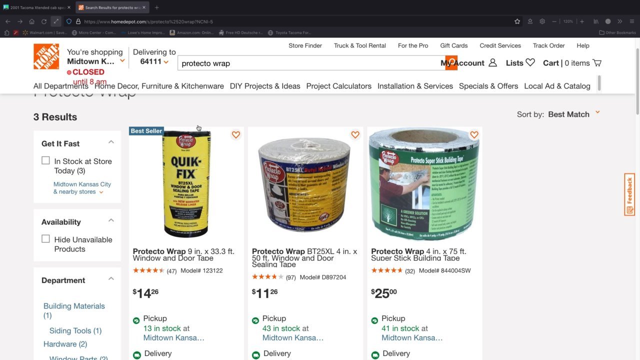

    Im finishing up system for my new truck. knuckels are still scraped up. I did a 3 way set up in the front with a focal 6.5 woofer and JL audio c2 6.5 components. kenwood excelon xr high def 6.5 in the rear doors. Im 6'4 300lbs. The empty space in the door panels are a frustrastion for a big guy trying to blindly fumble around in them while driving. i only need to drink 1 bottle at a time. This is now a home for my speakers. Go crazy with confg, 10" mids 4" tweeters...plenty of room! I started out with a piece of 1/2" mdf cut to shape of the swoosh type design of the storage area. 6.5 and tweeter there, other woofer in factory door location. Currently cutting panel nearly in half to incorporate a panel large enough to hold all 3. Check out the panel, the pattern is already there. As for deadening? Many many auto audiophiles, installers, and parrots "people without original thought" have scoffed at my usage of a product from the home improvment store. Hear me out. I was an Industrial maintanence tech for 10yrs, Boiler Maker, and high level manufacturing tech. I worked for a company that made sound deadening materials for flooring and was a grinder operator in a foundry making train wheels. Grinding stones 3' across 3" thick 124lbs. 3 giant machines, each grinding 900lbs of steel in unisin, is literally earth shaking and deafening. Sound deadening foam is manufactured, then sold to a company that cuts it, adds adheisives, labels it and packages it to theyre specs. So 15 companies, same stuff, labeled and sold in different markets for different purposes. Foam for 3ms sticky wall hanger is the same as foam under your floor laminant. Im not an idiot, I know sound, cause and effect. I also know for a fact that many products are meant to be completly functional and not fashionable because theyre not meant to be seen. A pretty foil backing doesnt improve car audio sound deadings functionality and its always hidden. The orange store has a 33'x9" roll of window and door insulation. Its rolled tar, a poly backing, sprayed on addheisive, and a paper barrier thats peeled off during installation. I did all 4 doors inside and out, all door panels inside and outside of front panels where speaker panel covered, the speaker panel, floor, dual 12" sub box, every piece if trim I can remove ect. Not strips...complete coverage $45

    The foil is a constraining layer & is a critical part of the damper. Its constitution and thickness largely dictate the damper's effectiveness.
    Those materials pictured above won't do anything for resonance, absorption or transmittance - which are the typical goals of deadening treatments.
    And you don't want tar in a vehicle.

    Thank you for describing your experience in such great detail. I hope your upgrade works well for you; I share, however, @rob feature 's concerns about having tar in a vehicle, or at least, having a product not explicitly designed for the small inside space of a car.
    As mentioned I ordered Noico, that has since been delivered by Amazon. It is a two-part system, with a heavy foil-covered butyl sheet and second, foam layer. Will see how it works.

    fellas...not litteral tar. Its thick sticky black shit. my point was its the same stuff. different presentation and advertised purpuse but ultimetly same stuff. i told you i worked for a company that makes sound dampening. "we" as in me and a few engineers that are into audio brought in and tested many products. In a Tifec lab. that stuff does everything you say it doesnt. if youve used it and have a differing opinion ill listen but youre repeating the exact mistakes i told you about. keep burnin through that cash or do what most do...half ass it. Ive tried worse things for $15
