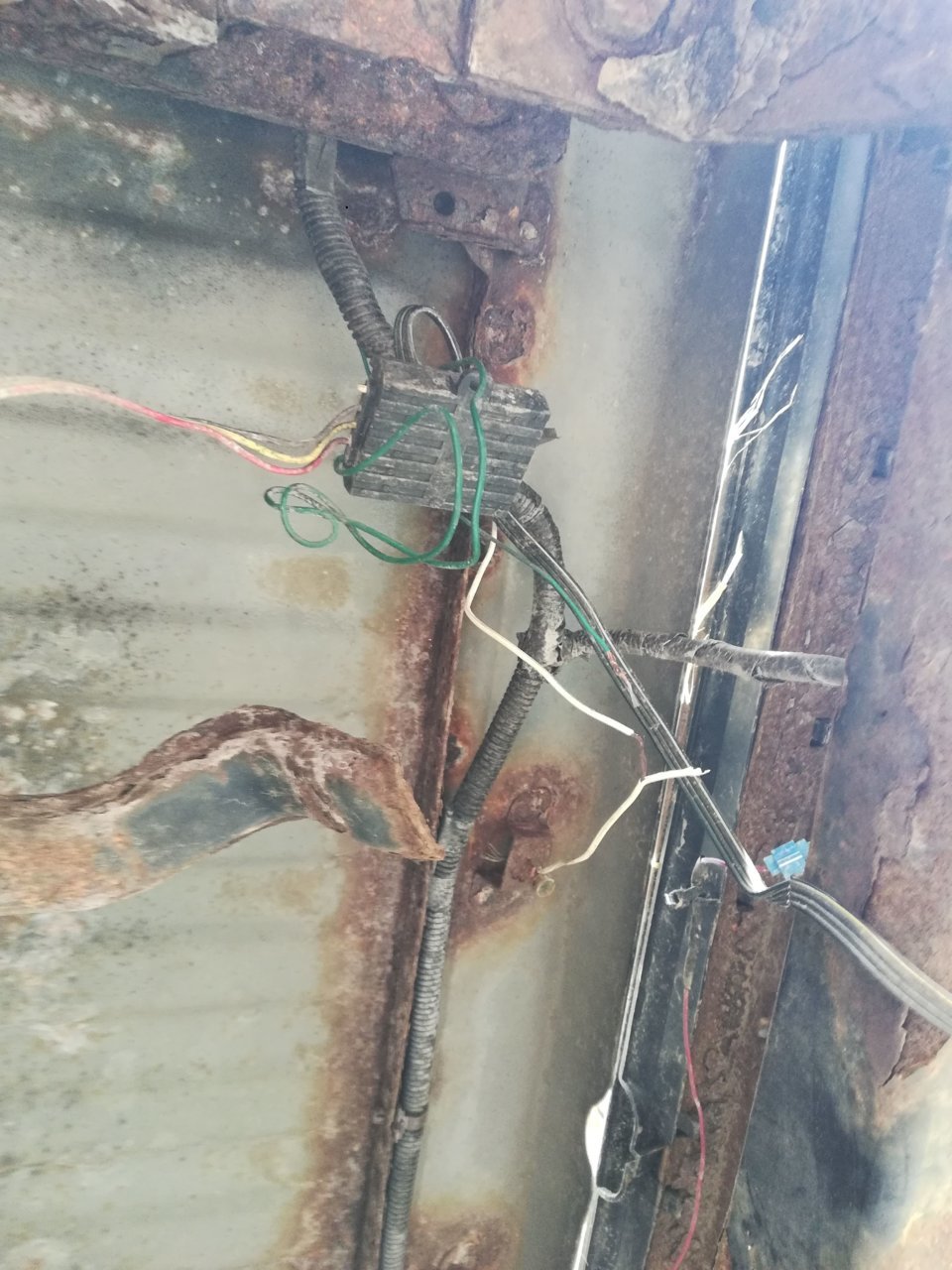

    this. 99% of the time when someone gets weird behavior from lights, it's because of a trailer harness. Rip it out and re-test. If it works, replace the trailer harness.

    IMG_20190303_111014.jpg the trailer harness p.o.s. Finely cut out this pos . and it all fixed..
    hope it helps someone else.
