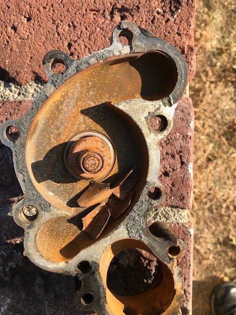

    FIXED...Can you guessWP.jpg what the fault was?

    I don't think that water pump is supposed to look like this.

    "Well there's your problem" lol
    Hopefully that job wasn't too much of a pain in the ass.
