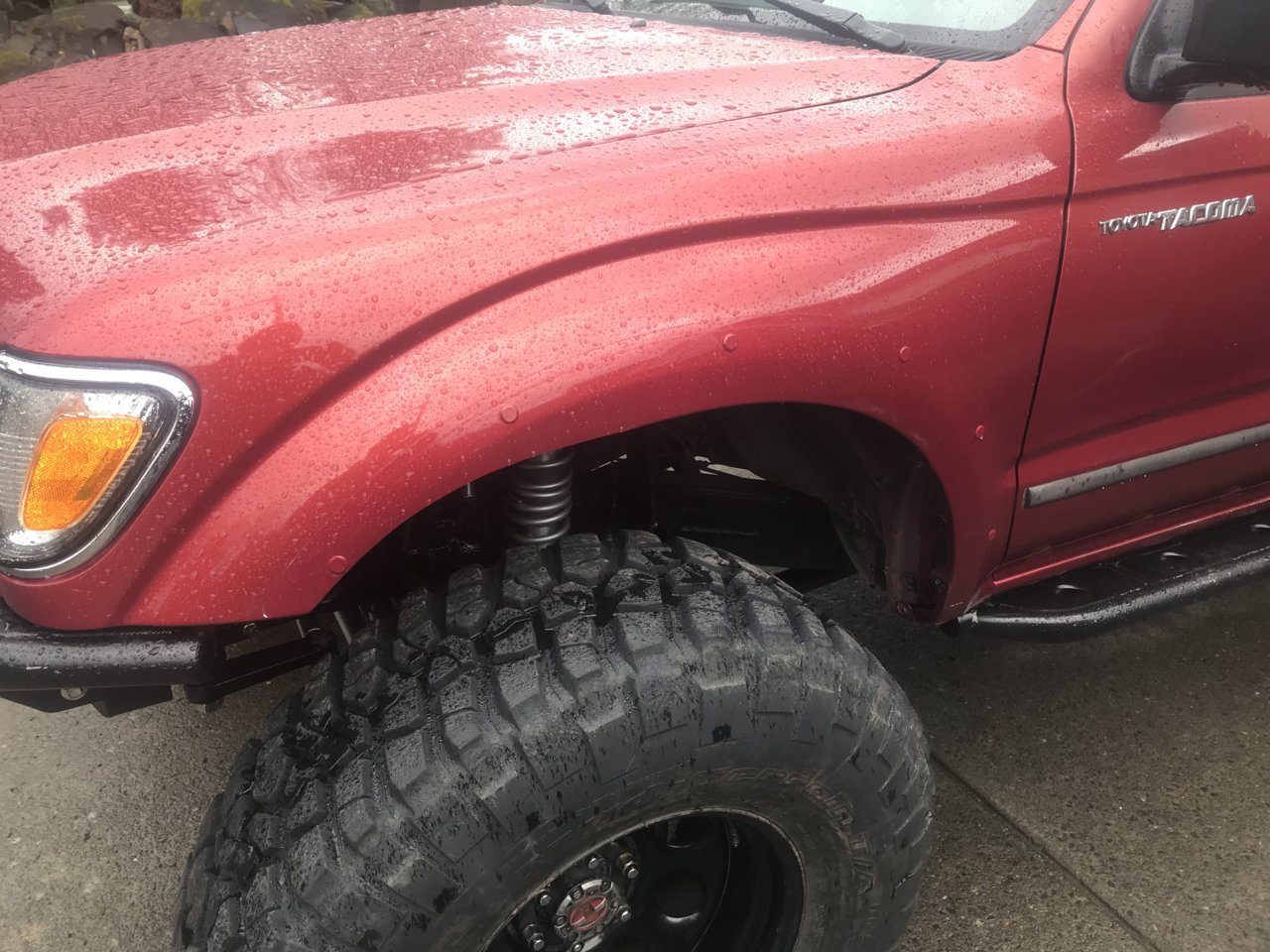

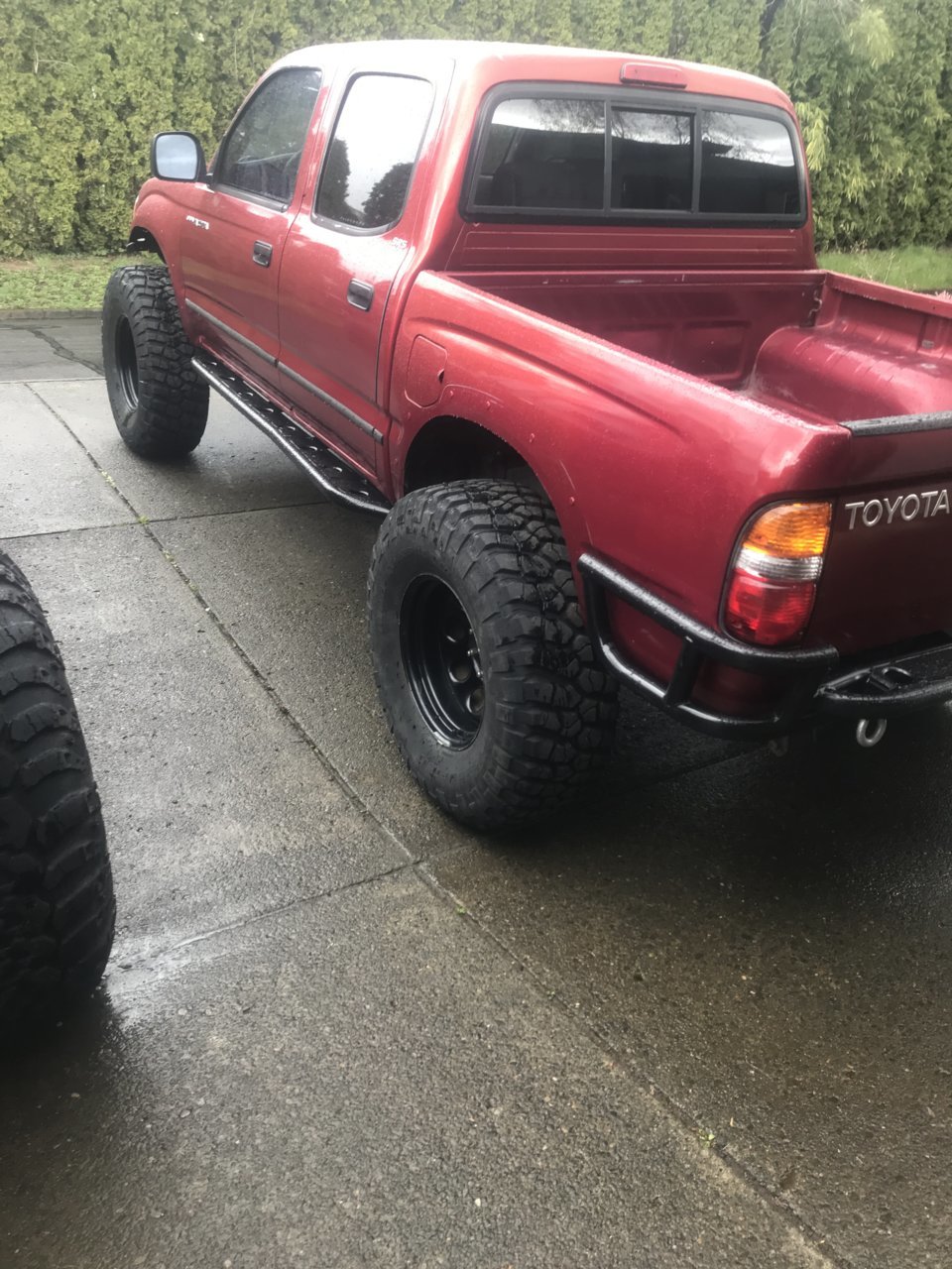

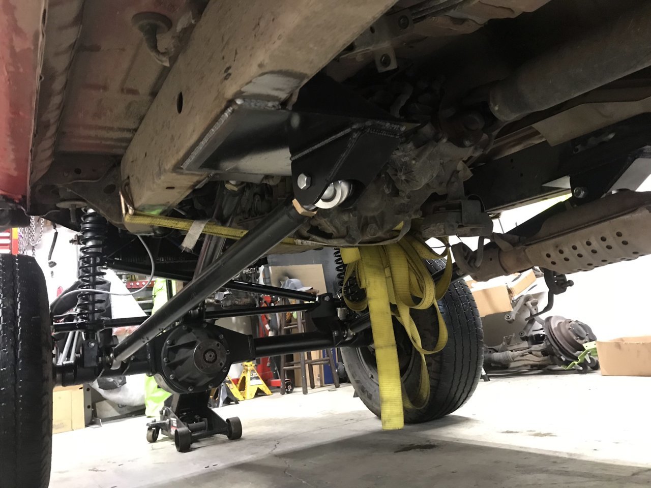

    With the flares removed I was able to ✂️ 1” following the factory fender line giving me enough clearance to remove the extra leaf I installed. Frame is right at 21” with the 37s

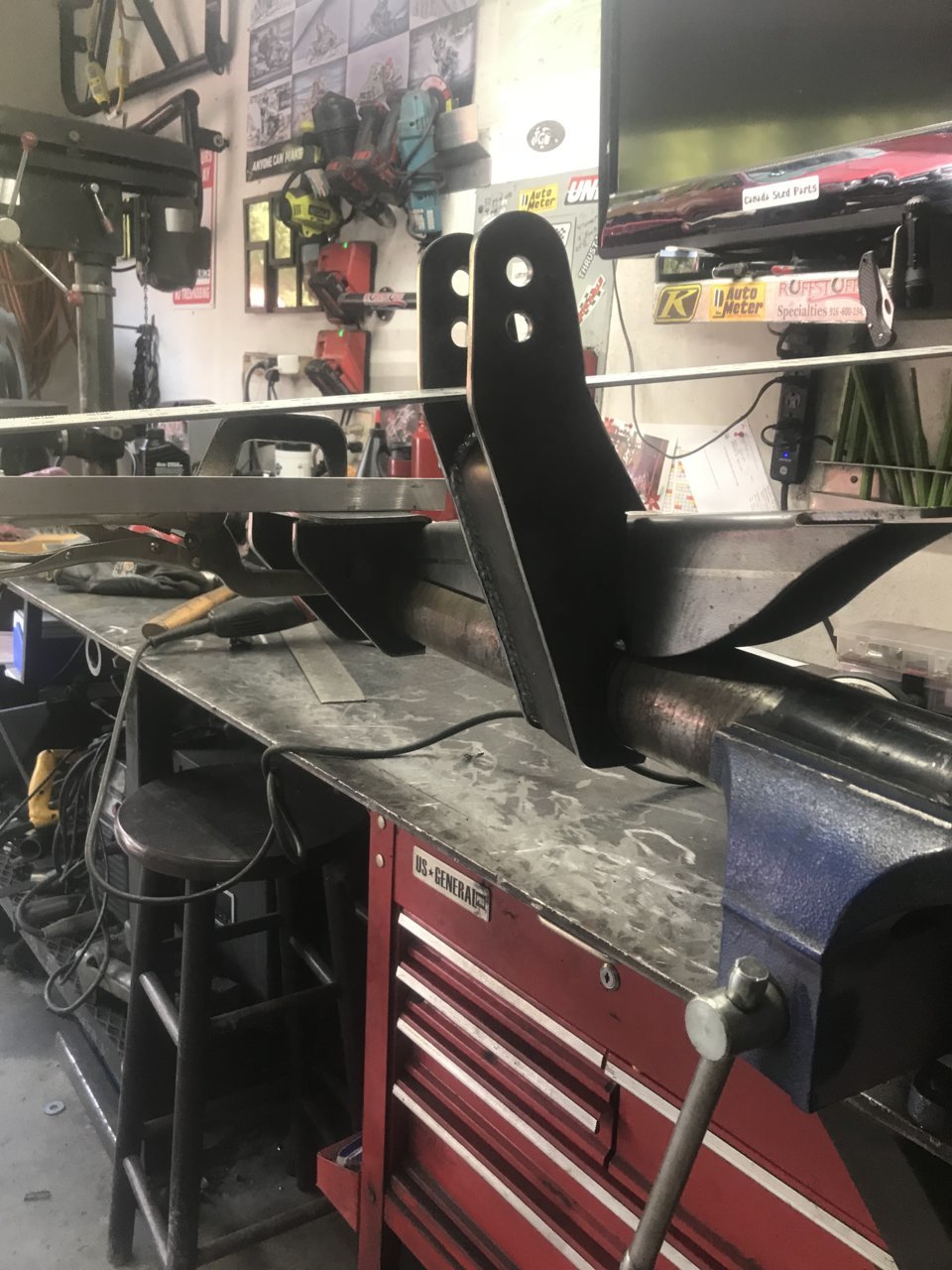

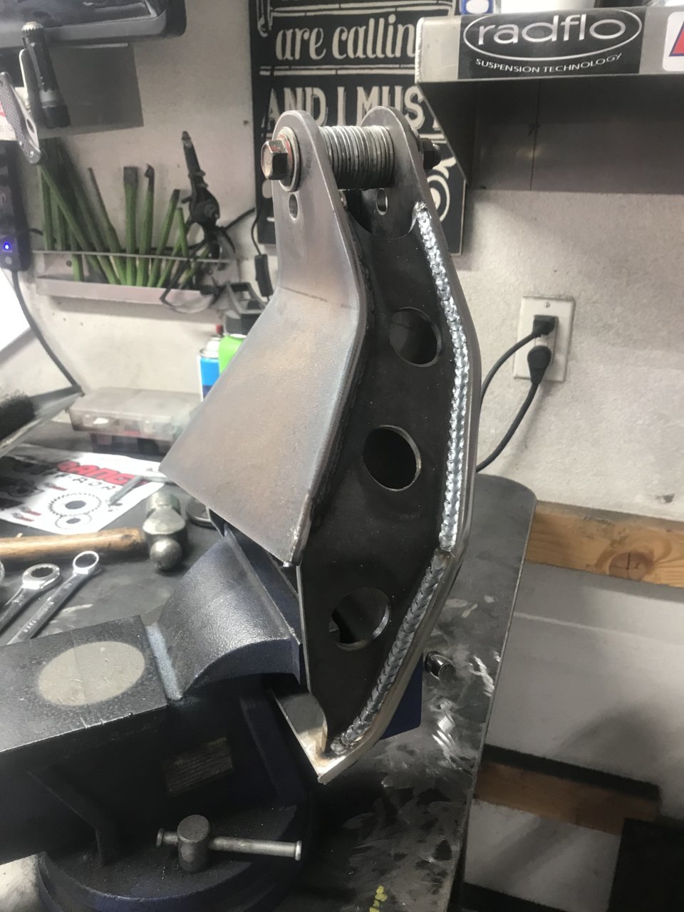

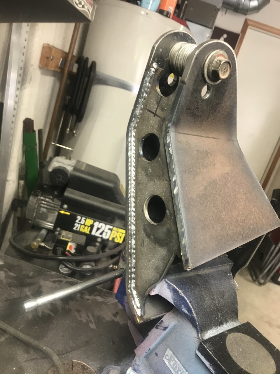

    Started on rear link brackets for the axle side, thinking with the stimulus check coming I might as well put that towards coilovers and air bumps
    cruiserguy and COMAtized99 like this.
  3. Apr 2, 2020 at 7:53 AM
    #83
    02hilux
    02hilux What do you mean there’s no road, I’m here
    Sep 14, 2016
    #197244
    6,314
    Planet: EARTH
    Mind sharing?
  4. Apr 2, 2020 at 7:55 AM

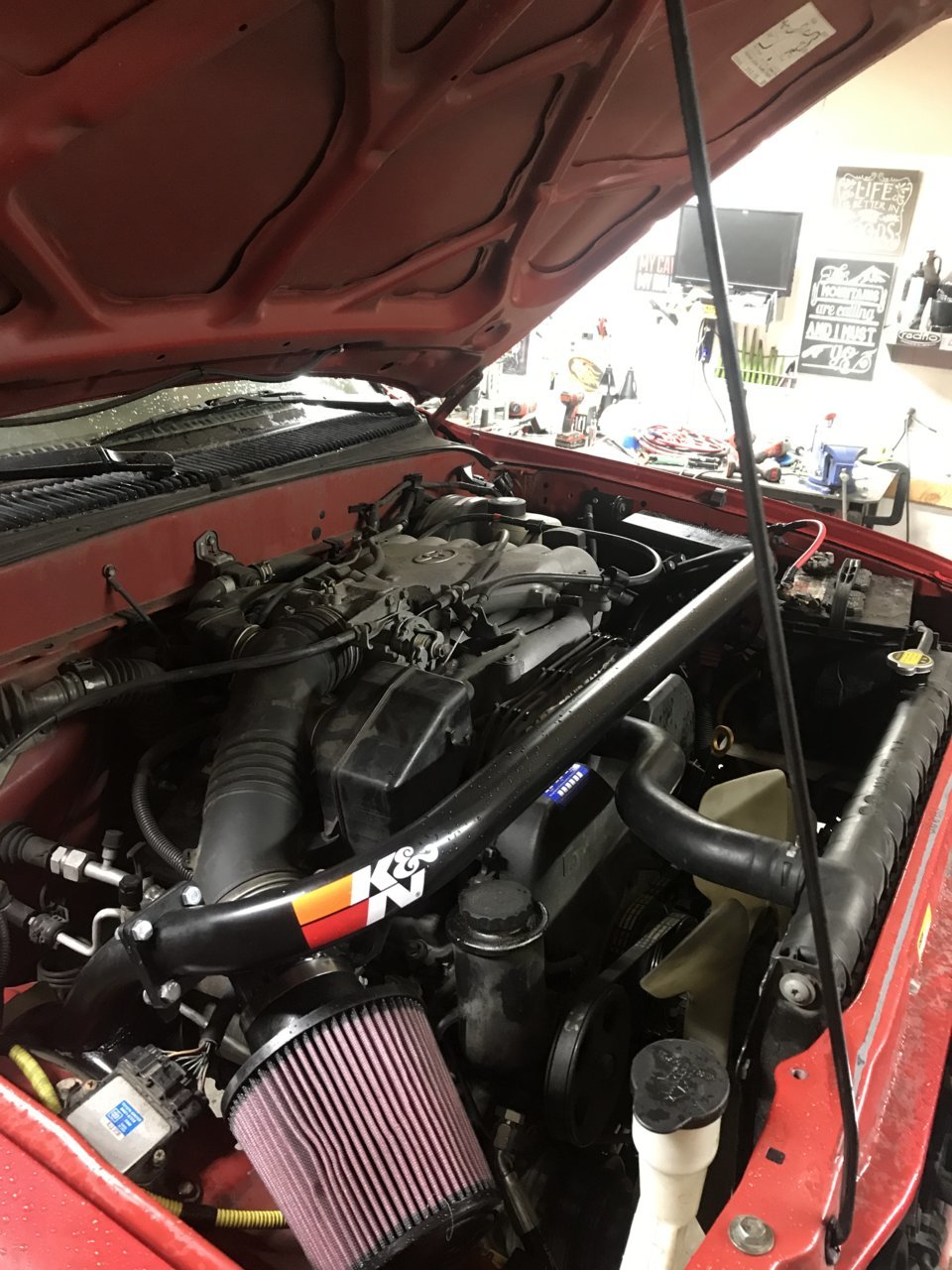

    This is arguably the best 1st gen SAS build on TW.
    The notched front frame to keep the height down to a reasonable level makes me thing this is possible.
    Now how to do it with a 3.4L V6 in there....

    Too many, See Build
    Sick as truck! Love it!
    Nothing wrong with the 4 banger.

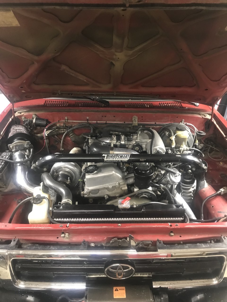

    Hell no there isn’t just wait until I rob the turbo setup off my 3rd gen

    That will be the last thing on the list as I’m still wheelin that truck currently

    mind me asking what manifold that is?
  18. Apr 6, 2020 at 6:37 PM
    #98
    Kkrause09
    Kkrause09 [OP] Well-Known Member
    Jan 20, 2020
    #316705
    171
    Kyle
    Tacoma sas
    Paradise racing
    Saiko[QUOTED] likes this.
