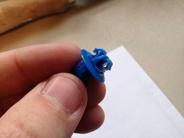

    This is what the stock clips look like.

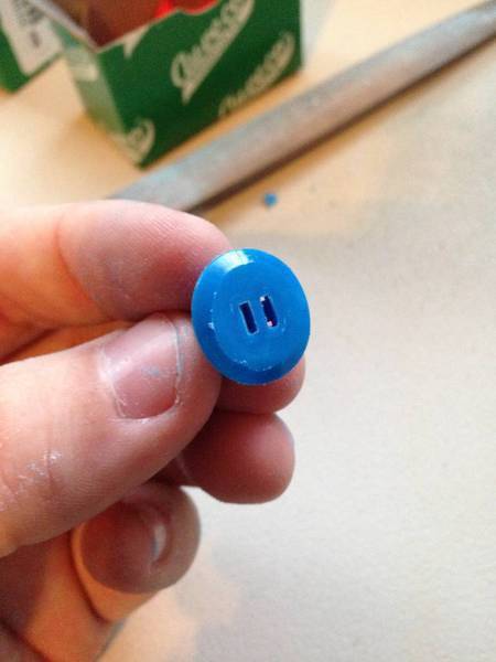

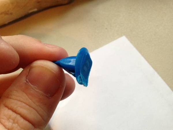

    I figured these were a perfect platform to build off of for the plugs. The first step was to file off the outside clip and see what I was left with.
    I was hoping to find a nice flat surface under the clip, but that wasn't the case. There are two slots that are revealed after you grind the outside clip off.
    Here's what you're left with.

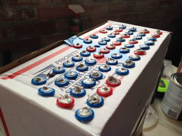

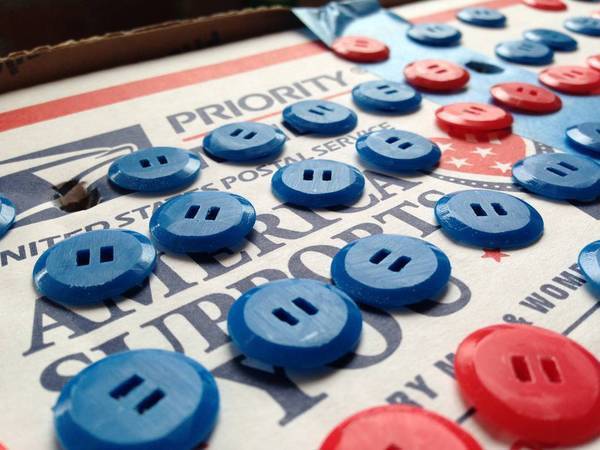

    The next step I took was to fill the slots with bondo. You could use epoxy or some other plastic filler, but bondo is pretty easy to work with.

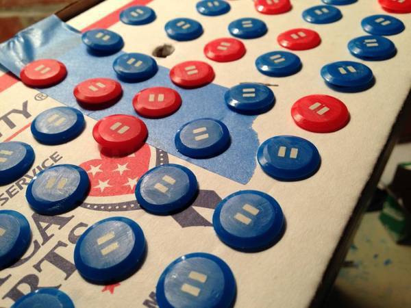

    Here's the set of clips ready for bondo.

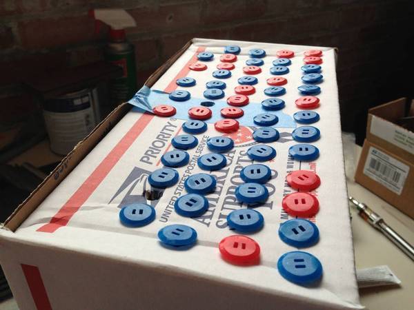

    I used a box I had laying around to hold all of the clips in place while I worked on them. This was also my painting platform.
    You can see that the sanding doesn't have to be perfect. With the flake in the MGM paint you can't see any of the little imperfections.
    Then fill the slots with bondo. Just make sure you push the bondo down into the slots.
    The bondo will set in about an hour and be ready to sand. It's easier to work with now rather than waiting a day. It will get harder as it sets.
    Here's what the clips look like after the bondo has been sanded down.

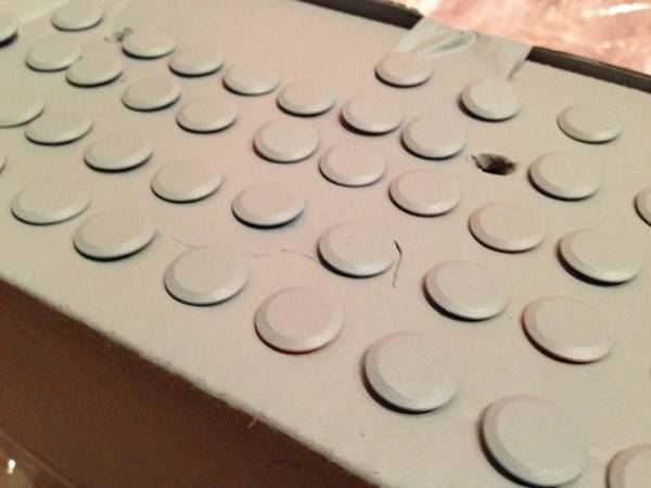

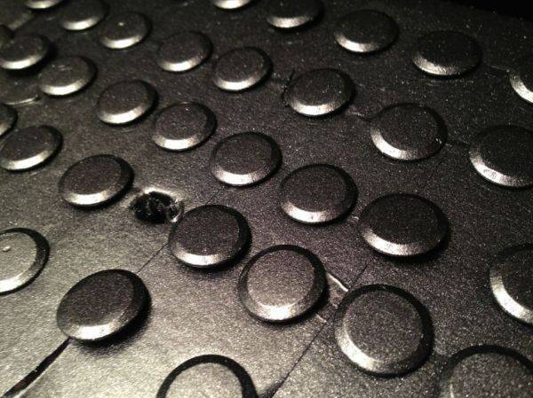

    Since we're dealing with plastic I chose to use a plastic primer as the first coat of paint. I followed that with primer, black gloss, color matched MGM, and clear.
    Primed
    Final product

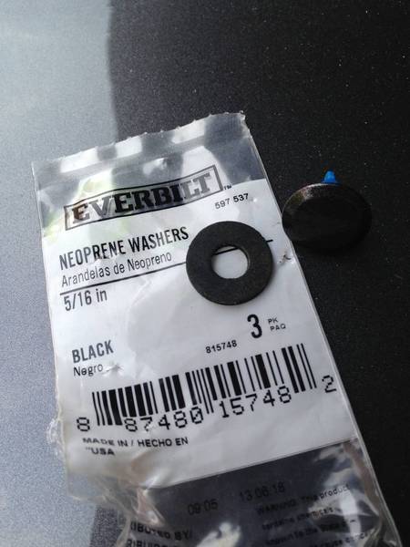

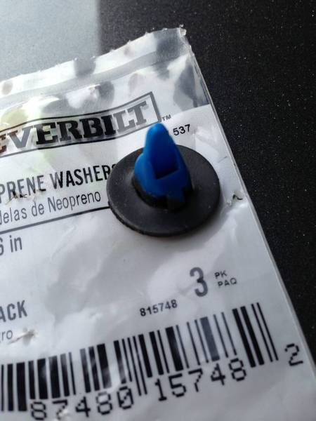

    You will need one of these neoprene rubber washers for each clip. I found them at home depot, $0.74 for a three pack. I'm still short six of these after cleaning out three home depots. :)

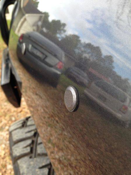

    I will have to take pictures of this set when I get home as I put the last coat of clear on this morning. But for now, here are pictures of the two test plugs I made earlier. On this set I didn't use the gloss black before the MGM so the color match wasn't as good. This next set turned out a lot closer to the actual color. I'll get details on the part numbers you need as well as the required rubber washer that sits between the fender and the plug a little later. The rubber washer helps lock in the plug, otherwise the plug is free to slide around in the oversized hole.

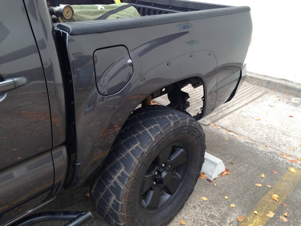

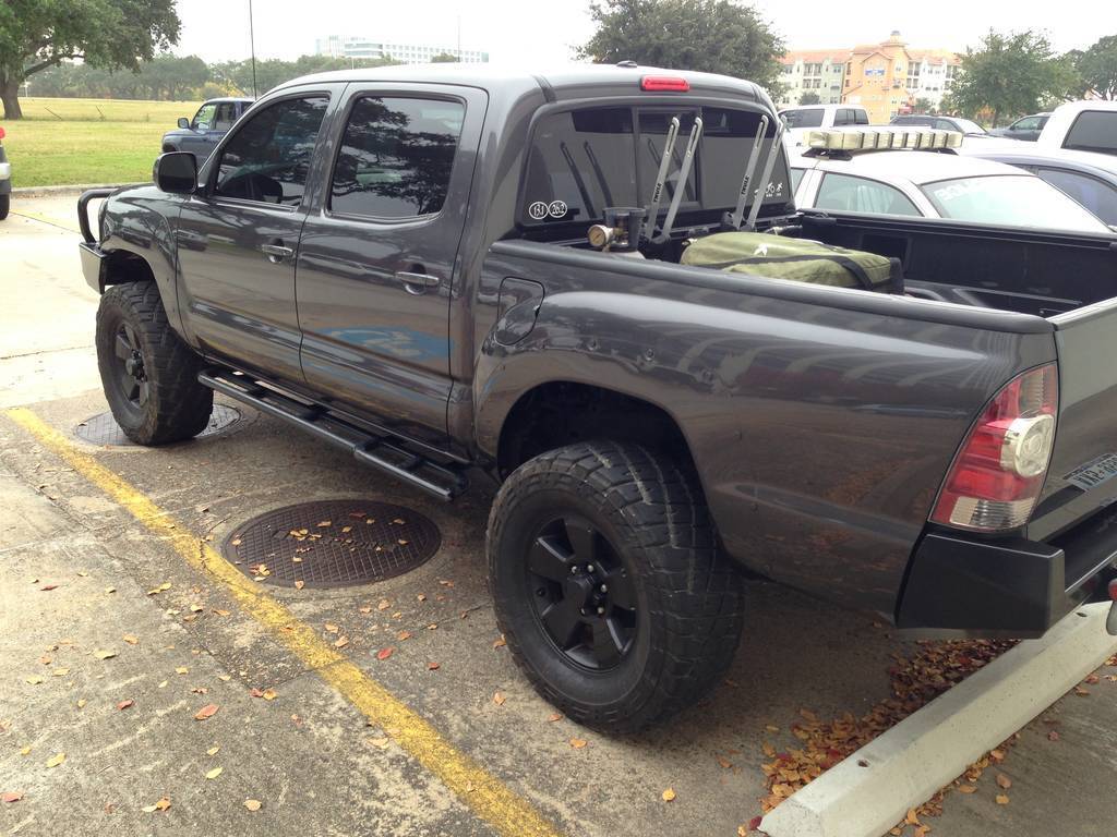

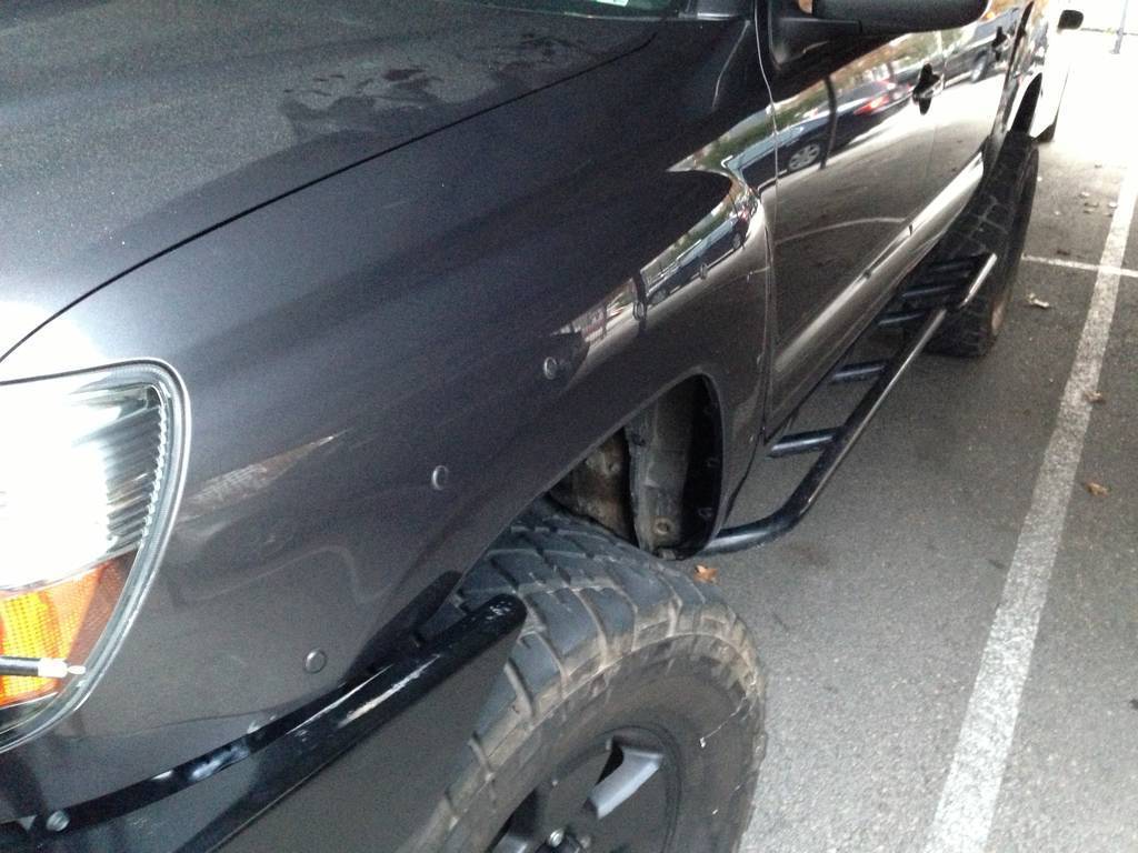

    Well, I got home tonight and was able to install all but six of the plugs as I ran out of the rubber washers. The light was fading by the time I finished the front fender and pitch black by the time I finished. Here's a teaser shot to hold you over till I get some better light on this thing.

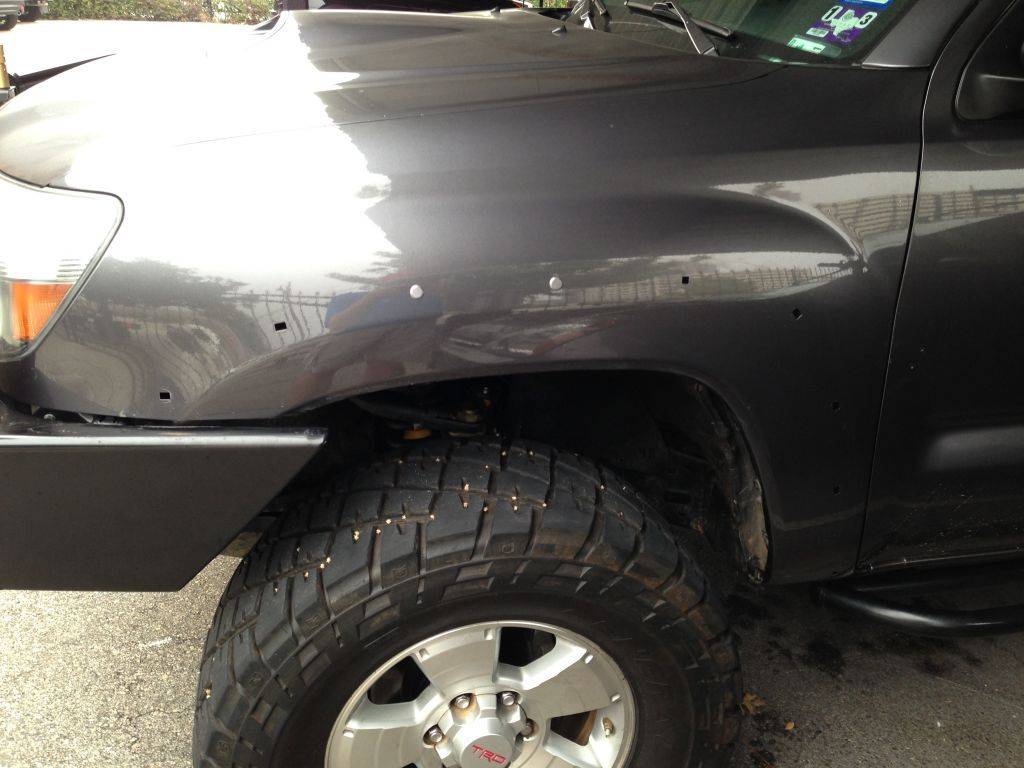

    I took a few more photos at lunch today. It's overcast today and I guess I did a good job of color matching, because the plugs blend in pretty well.

    Nice! That's a great idea! Can you throw up a pic showing the whole fender?

    I haven't filled an entire fender with plugs yet as I just finished them, but this will give you an idea.

    Like the idea but can you get a side shot of the whole truck with all the clips? One of my fenders got screwed wheelin and I've been wondering what to do but I wanna see what this looks like finished.
