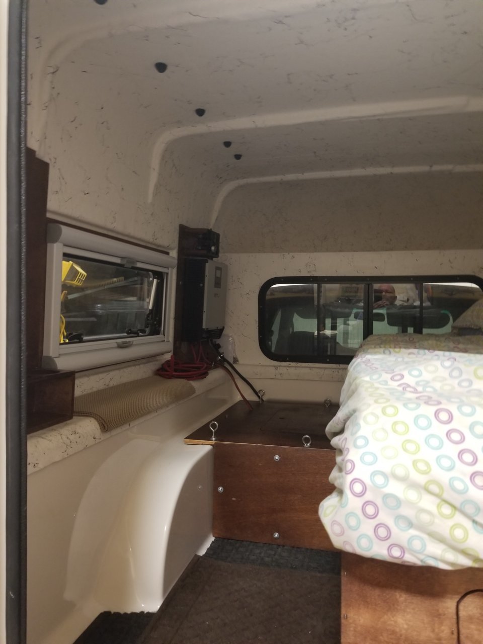

    I built the box right at 70" to make sure it would fit in there the way I wanted it. My foam mattress was 72". I cut it back to 70" as it was tight against the back door frame. Now there is enough slack to lift it and put on sheet and close the door and operate the lock without any issue. I put the bed on that side trying to keep everything balanced out weight wise. My 185lbs is on drivers side. The bed and whatever I store under it plus weight of the wood on passenger side. When I put the fridge in I should be pretty well balanced left to right. I also considered the awning and road shower up top as part of my balance. All the wood components are bolted in and fit snug. Undo a couple of bolts and all the wood can be removed pretty quick.

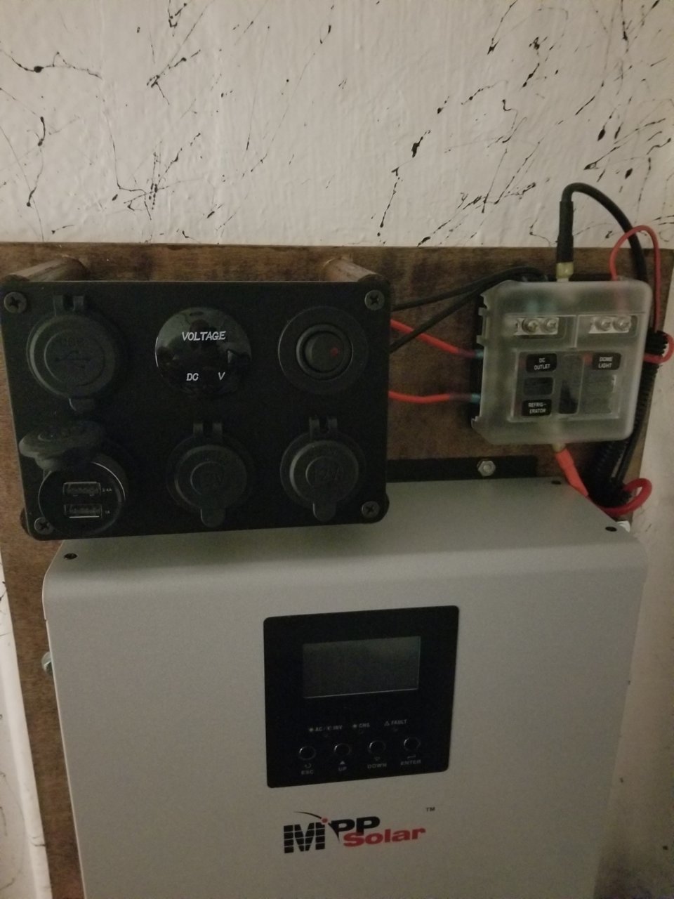

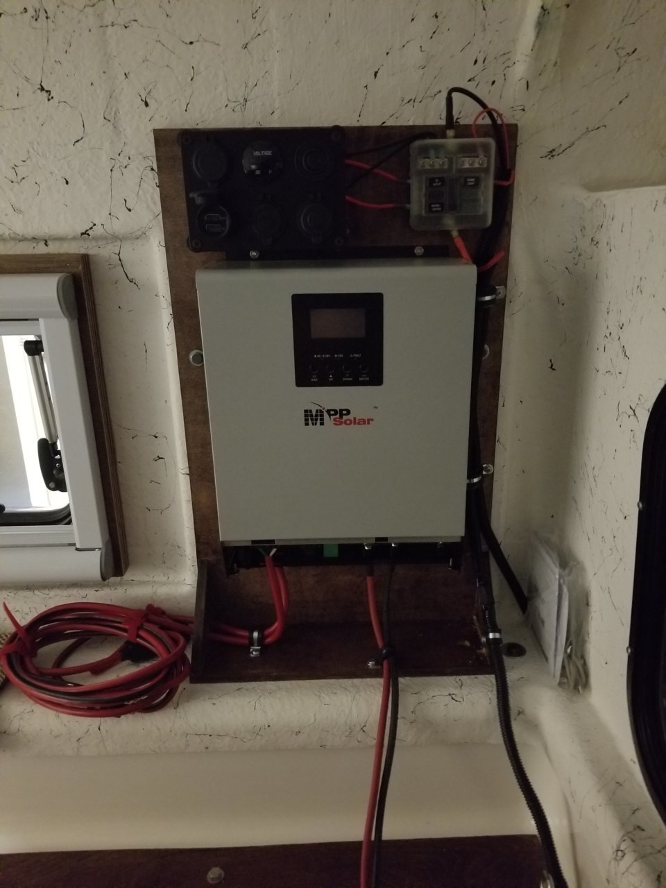

    The final step of my build. Install the solar power. So after countless hours looking at solar set-ups and how to videos I settled on a all in one setup. Everything is in the box and saves a bunch of wiring and calculating. So bought an MPP all in one 1000W system, 175W panel, fuse block and various wires, connectors etc. I haven't purchased the battery yet but will be purchasing a Battle Born 100AMP hour Lithium. The MPP all in one was purchased from MPP USA. They are made in Taiwan not China. I have heard the ones on Ebay etc. are China knockoffs. So the unit has a 1000W inverter, all the fusing and overload circuits are built in.
    So I built a little station to house it all. Has 1000W inverter. 3 12V cigarette outlets, 2 USB outlets, a voltage meter and off/on switch. This will power my fridge, computer and charging accessories.

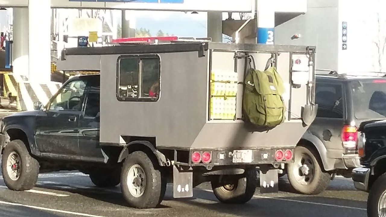

    I'll keep the stock box, but I removed it this summer and realized that it weighs about 300 lbs with the tailgate. It's not that hard to remove, and is essentially useless when a camper is in it. If I could mount a 700lb unit on the frame, it would only be a net increase of 400lbs. I saw this unit waiting in line for a ferry recently.
