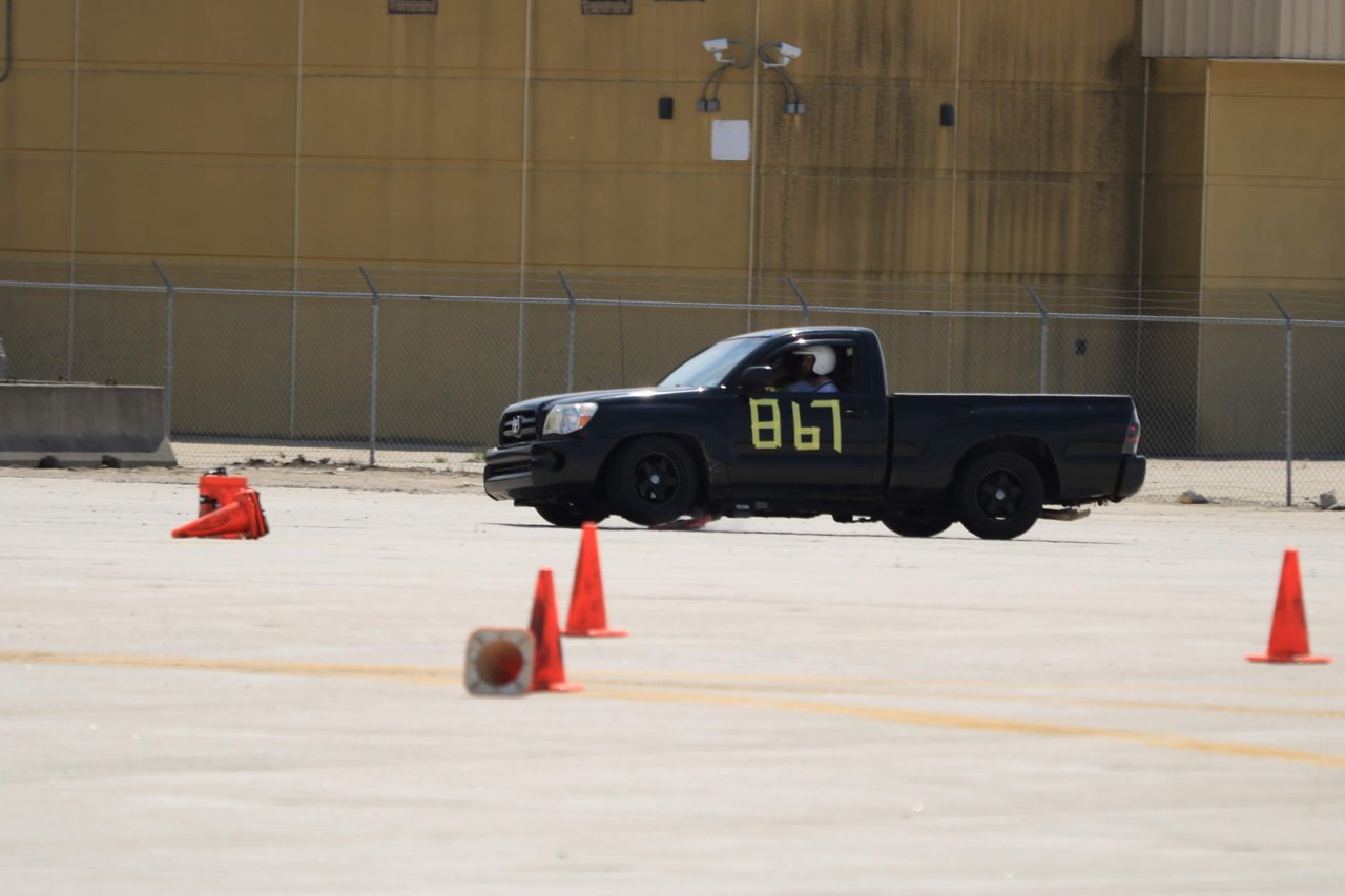

    Photo credit to: Skylar Somerville9B3F2D68-5C4A-4B53-A6A0-9F4EA626461D.jpg

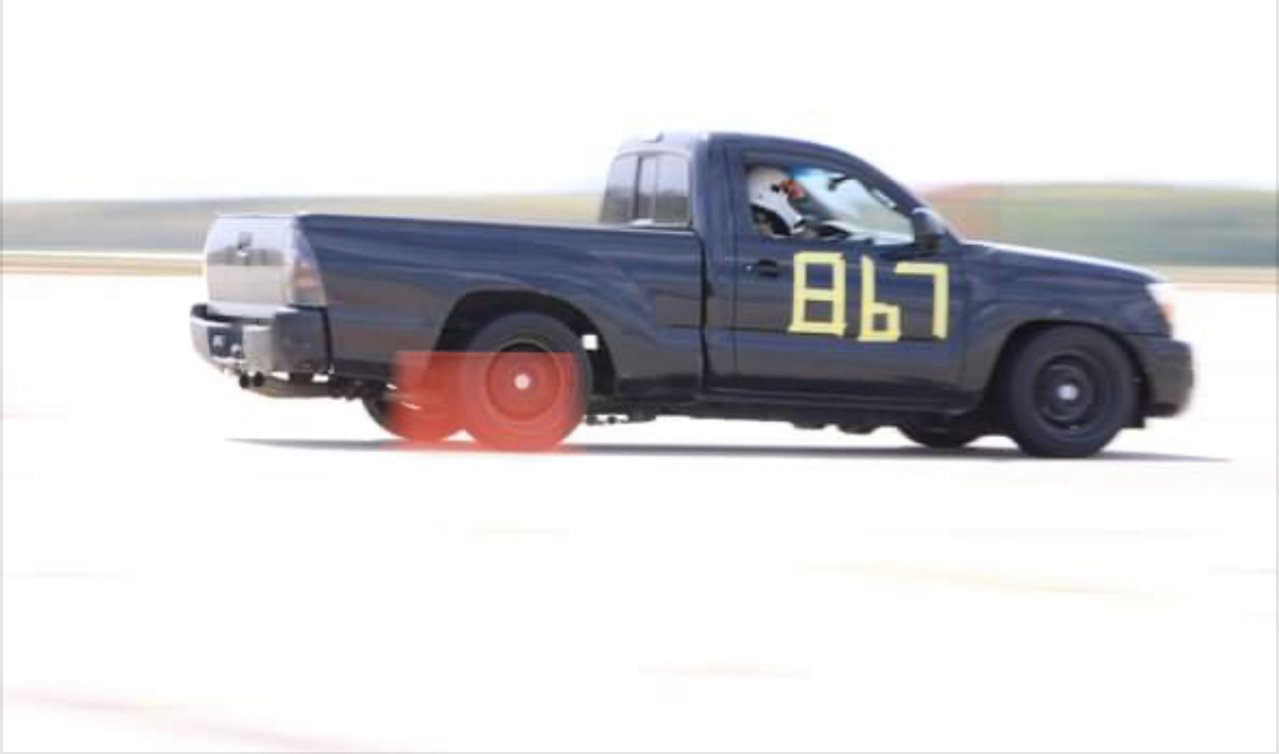

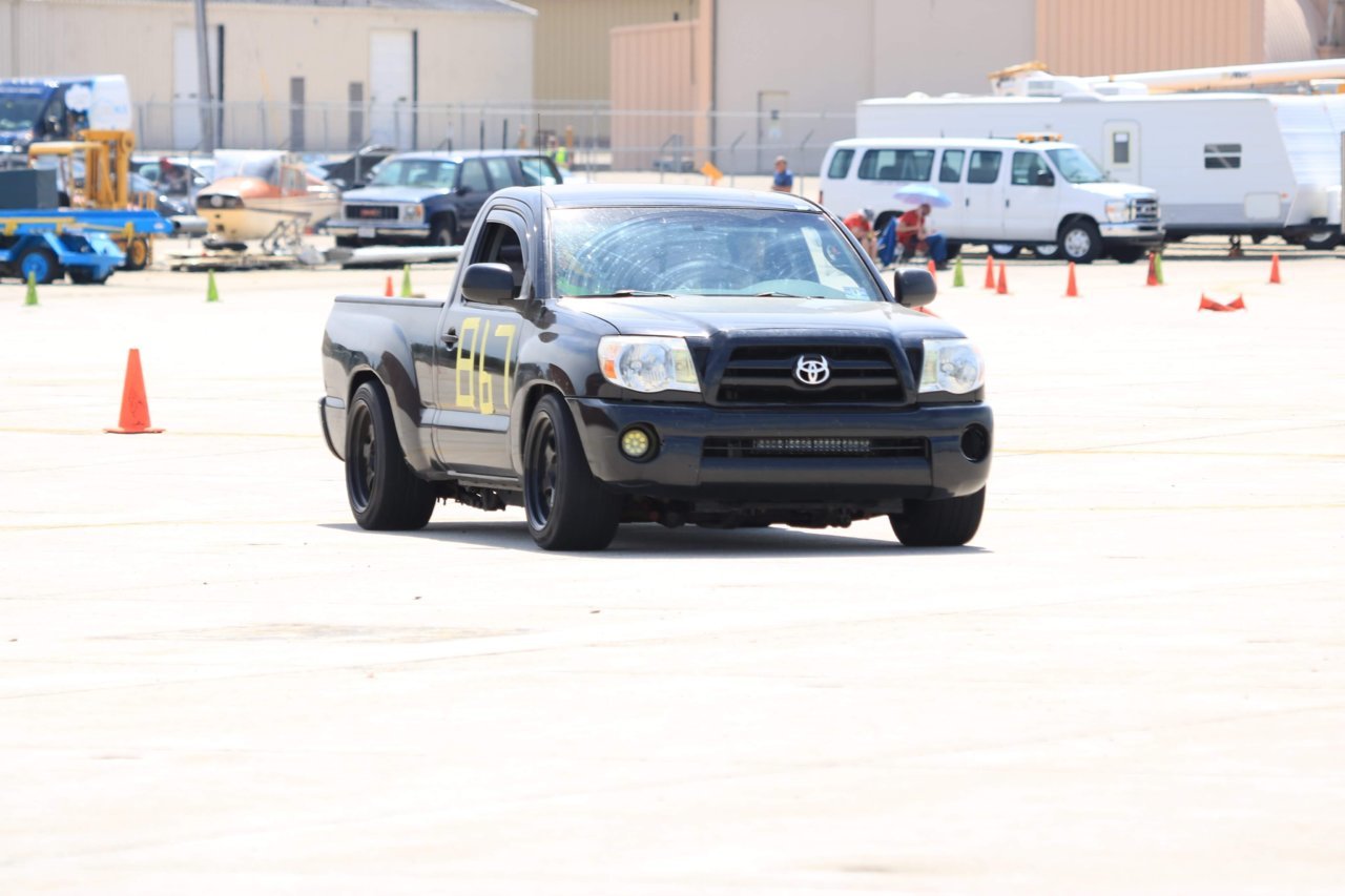

    A couple more photos from the race weekend. Captain cone muncher reporting for duty2C20D4F5-6418-4A44-A5B5-C9C4D3E990DB.jpgE3067770-5EB8-49F6-9D55-D9AD11E72A5F.jpg

    Proper street/race truck stance. :thumbsup:
    I need to get back out on the track. I miss it a lot.

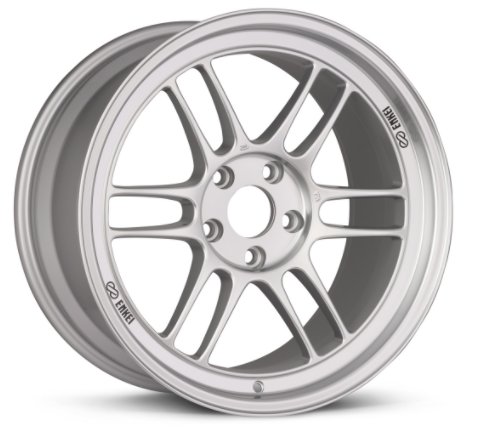

    Thanks for your vote for Tacoma wheels/tires! May as well get the Tacoma a bit more up to snuff since finding the right Z06 in under 3 weeks would be a bit rushed.
    I am looking at the Enkei RPF1 17x9 +45, nice light 15 pound weight, should look at home on Trudy and fit a wider stickier 200 treadwear 255 tire. This size wheel was local and in stock for $950 a set. The STX class allows up to a 265 tire so I may want to go wider, but havent quite found the proper width/offset combination yet. Open to suggestions..
    I could go up another mm in front sway bar with an Addco, and wonder if the rear s-runner sway bar may help. Wonder also if I could figure out the mounting for that thing if possible for the next event.
    As for larger brakes, I found Stoptech has quite a few offerings for the old Tacoma actually even up to $2500 front kits. I am leaning towards the larger 11.68" rotor(s) a set of sport pads and adding some stainless steel lines.

    Sway bars and some sort of panhard bar, or spring perch to axle links. Would definitely help keep the the whole truck more planted. Pushing into the need for better traction.
    Tires and wheels will be the easiest and possibly most noticeable upgrade.

    Your truck doesn't just roll, it pitches/dives because your springs are too soft. Springs affect most aspects of a car's suspension. Sway bars isolate roll stiffness alone. So, if you only want to decrease body roll without other changes - go with sway bars. If you want to decrease pitch/dive, or change the ride height, or modify how the truck deals with single or multi-wheel bumps, consider changing the springs. One caveat is that springs have to be appropriately damped, so a change in spring rate may also require a change in shocks. Also, keep in mind that it's very easy to adjust the front/rear roll stiffness with sways, which means the handling balance. Toyota did a great job of finding this balance with the SRunner, so I run SRunner front and rear bars.
    The 17x9 RPF1 will do great on your truck. The 255 will be a tiny bit bulgy on a 9" wheel, but that's not bad for autocross. If you can still lock the tires up once those are on, you really don't need a brake upgrade. Larger brakes really become an advantage on a road course where you will heat the brakes up much more. Even on a faster course, you only do one run at a time so you would have to be insanely fast to boil fluid...unless your fluid is old and full of water in which case you should be flushing that out regardless. Maybe improve your pads and fluid and get stainless lines. As for transmission coolers, I can see you doing that for tracking but not really autocross where at most you might see 3rd gear.
