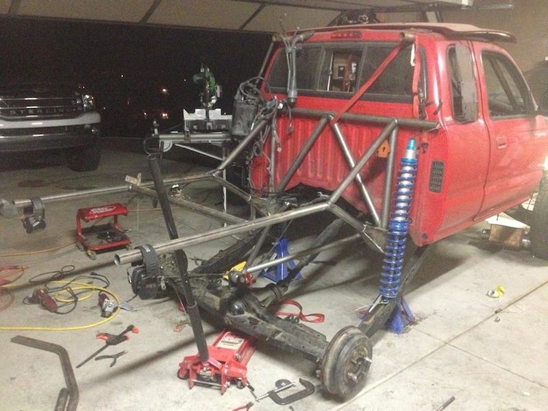

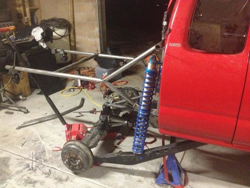

    well the rear frame horn boxes are done. should be working on tying the bed and cab together as well. long weekend so we shall see.
