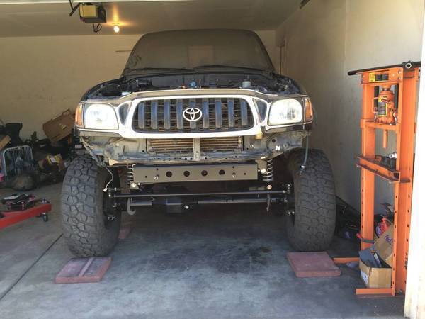

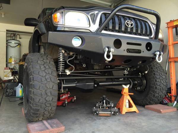

    More pictures of the lower link frame mounts? I think I'll be buying them for my truck. Are the clearances good with the transfer case and exhaust?

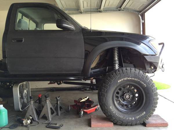

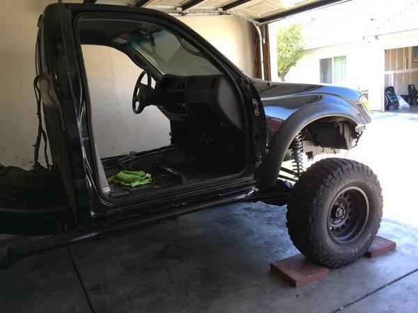

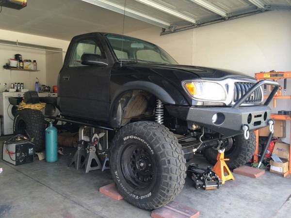

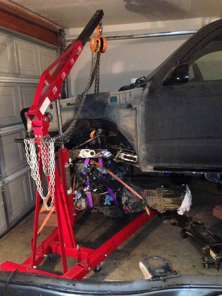

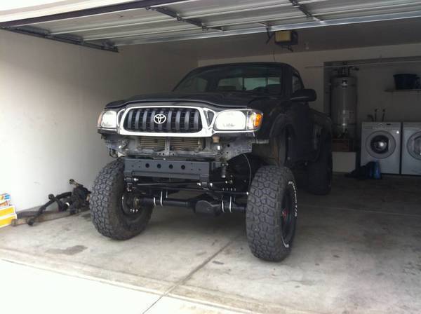

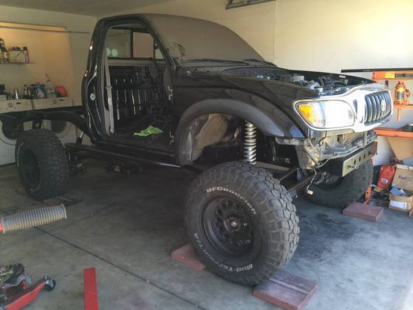

    Mounted the cab onto the frame. Engine is installed. Just have to connect the wirings and hoses now. With 33s the frame height is currently 23.5".

    Oh yeah this is badass. Definitely looking forward to the finished product. Always like the 4wu kits.

    There is not a lot of room but you should be able to fit a custom exhaust in there.

    Did you bend the old frame in the front from the additional stress of the SAS? How did you bend it just out of curiosity? Thanks man,

    Curious about how you bent that frame as well?

    Bent the frame driving over a tree stump. On the drop the driver frame rail took a pretty good hit from the stump and bent.

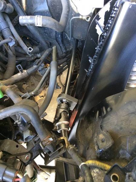

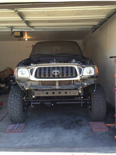

    The shock tower was in the way of the steering link, so this was what I did.

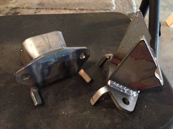

    I tried to contact him on ttora, unfortunately was unable to so......in a round about way, I ended up getting the same ones.
    The pitting is where the previous owner tried to repair them at one point. Check out the penetration of his welds! lol

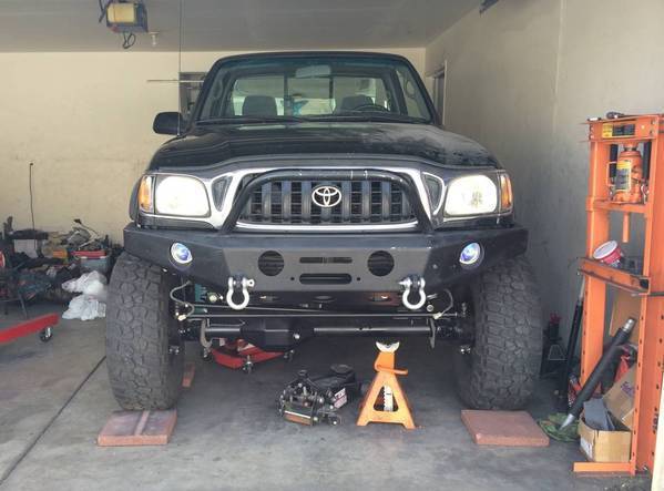

    Installed the front bumper, door, hood and interior.
