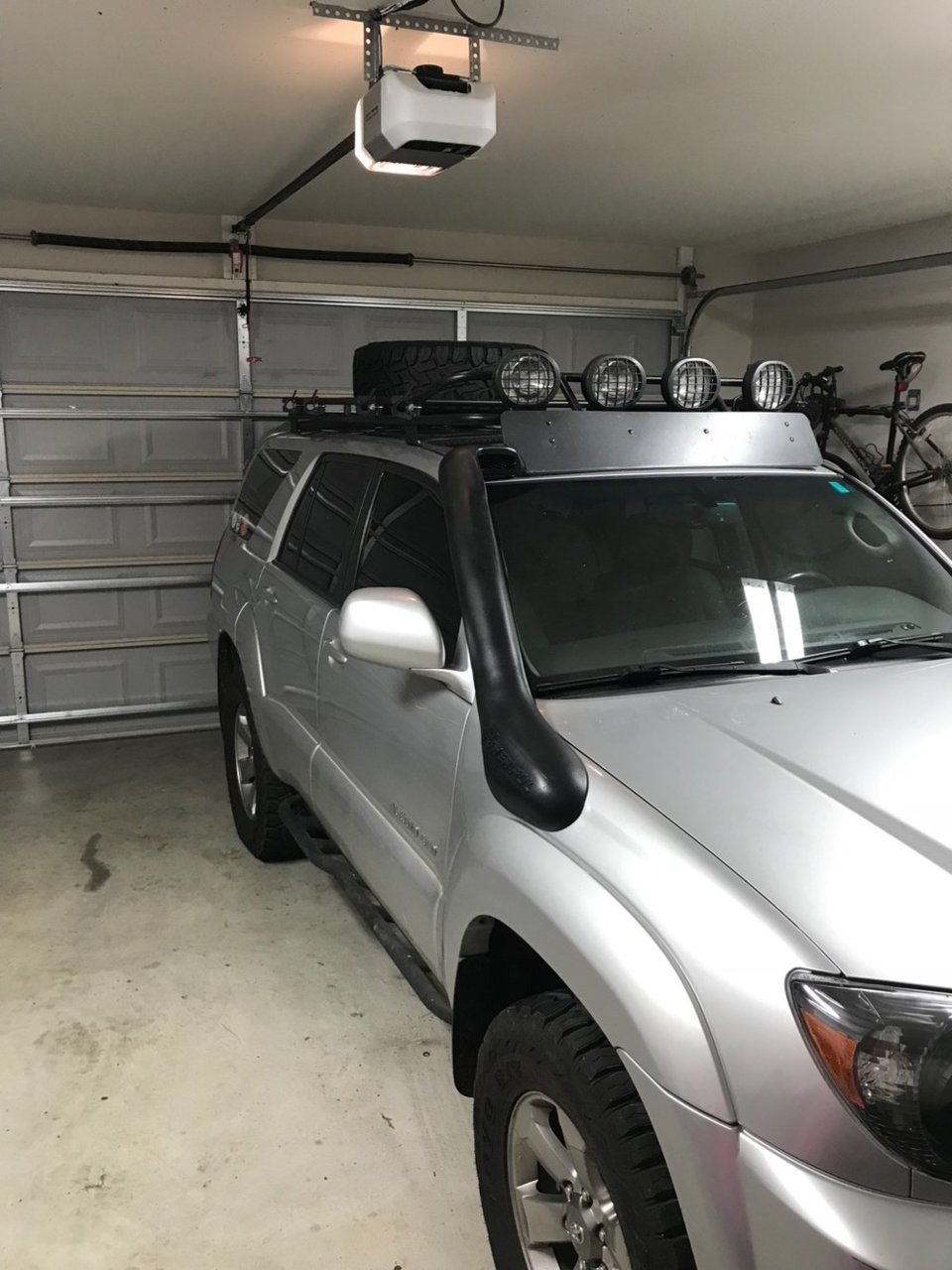

    IF I do a snorkel, I'll get one from a LC100 that is low profile. Like this one.
    Kwikvette[QUOTED] likes this.

    Ooh that looks good.
    Yeah we'll see how wheeling is later this year where I'll be moving.
    Granted Stephanie would love to make trips out to AZ and stuff, I may need a snorkel when I come visit your ass.
