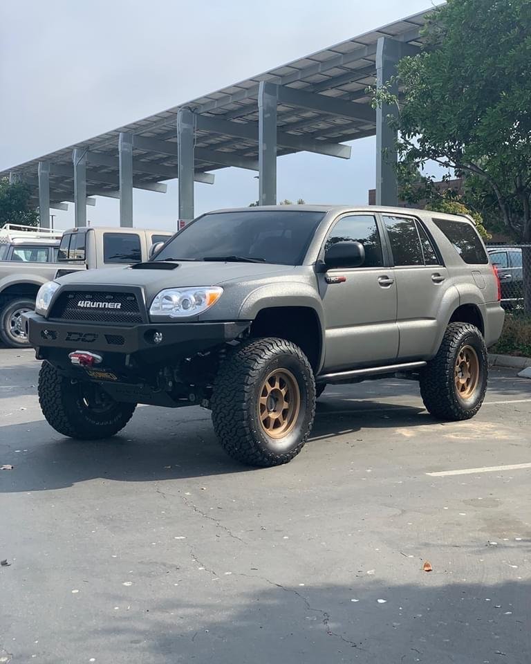

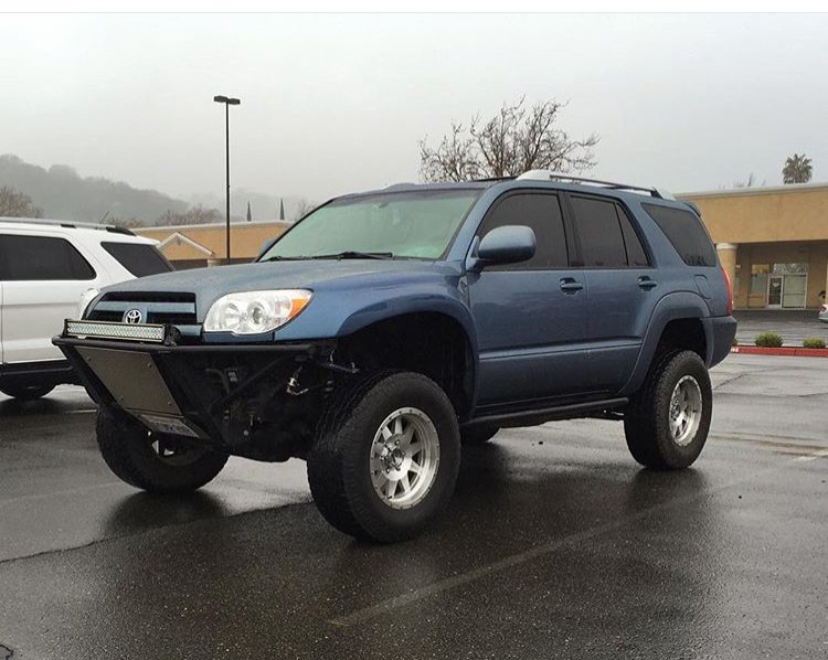

    So, after looking at replacement fender prices on ebay, I'm starting to think this might be a good excuse to get fiberglass fenders instead.
    Really like the look of these - https://www.mcneilracinginc.com/collections/02-09-toyota-4-runner
    This is the OEM style. I'm leaning more towards these.
    And this is the Race style.

    I like the OEM style mcneil fenders, and I think they would compliment the square 03-05 wheel wells nicely with their more squareness. I'll be interested to see how it turns out if you go that route
