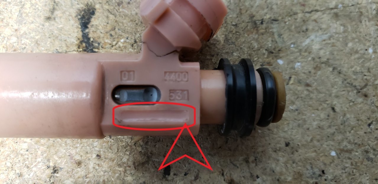

    I'm kind of wondering tho. The injector I posted doesn't have any Toyota part number on it. Is that normal for an OEM used injector? I should look at the other 2 sets of stock 4runner injectors I have.

    28,297
    Dan
    Northwest Indiana/Chicagoland
    It’s not an oem injector. It’s a denso aftermarket.

    Looking at it closer, it looks like the part number was actually removed. Maybe Keith is doing that to try and prevent people from sourcing injectors themselves.

    Empty_Lord
    Empty_Lord Toyotaholic
    Mar 13, 2016
    #181186
    28,297
    Dan
    doubt he is. theyre just injection molded without the OEM part number because its a denso aftermarket. same mold. just no toyota on it for gobs more money

    Take a look at this. This is why I was thinking the part # was removed. Note the arrow pointing at what looks like the remainder of a part #, a partial 0. That would match the Toyota part # I found listed above, 23250-0A020. Just speculating.
