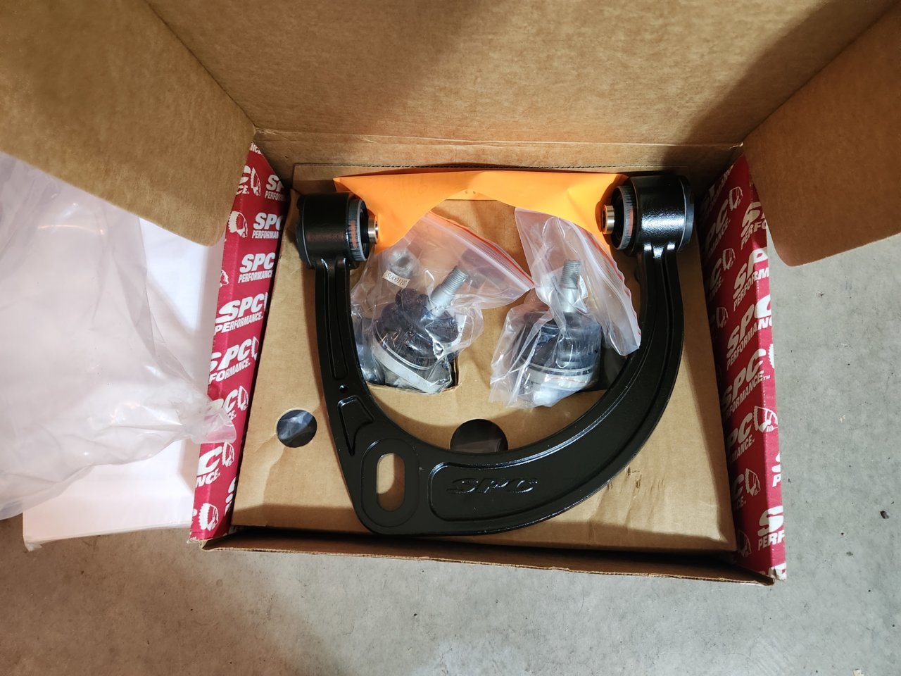

    Well, I'm going from a 285/70 to a 285/75. Toyo lists the 70 at 32.8" diameter and the 75 at 33.9" diameter. So I'm gaining about an inch in rolling diameter. I've already done the body mount chop and I can do the relocation if I need to. I'm also running 1.25" wheel spacers.
    Toyo lists the 295/70 at 33.3" diameter, so really not a huge change in either direction, just slightly wider. It's interesting because the 285/70 is listed at 11.5" width, the 285/75 is 11.3" width and the 295/70 is only 11.8" width. Not a significant difference between the 3.
    So I technically shouldn't have much of an issue. I don't have any wheeling trips planned anytime soon so it might be a bit before I can really flex the suspension out. I know I'm going to have to clearance the rear bumper wings as even with the 285/70, they were rubbing on those a little at full stuff. But that's easy and just a matter of doing some work with the grinder. Might be the excuse I need to finally finish those off inside the wheel wells. The front will need the body mount relocation at the most. I also have the SPC UCAs and the SuperPro offset bushing LCAs, so I can play with those to gain some additional caster and move the tire further forward in the wheel well. But that won't happen until I get back from the Seattle road trip.

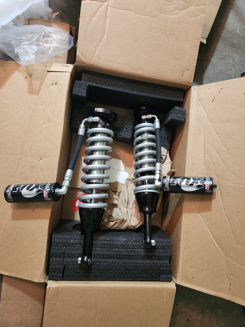

    Hey man, right off the bat that fox misalignment spacer is trash you’ll want to switch to a king to center the rod end unless you like self clearancing. Go with a 35” tire and move both control arms as far forward as possible. A ton of caster is false. No point in wasting time with 33’s. Hit me up with questions.

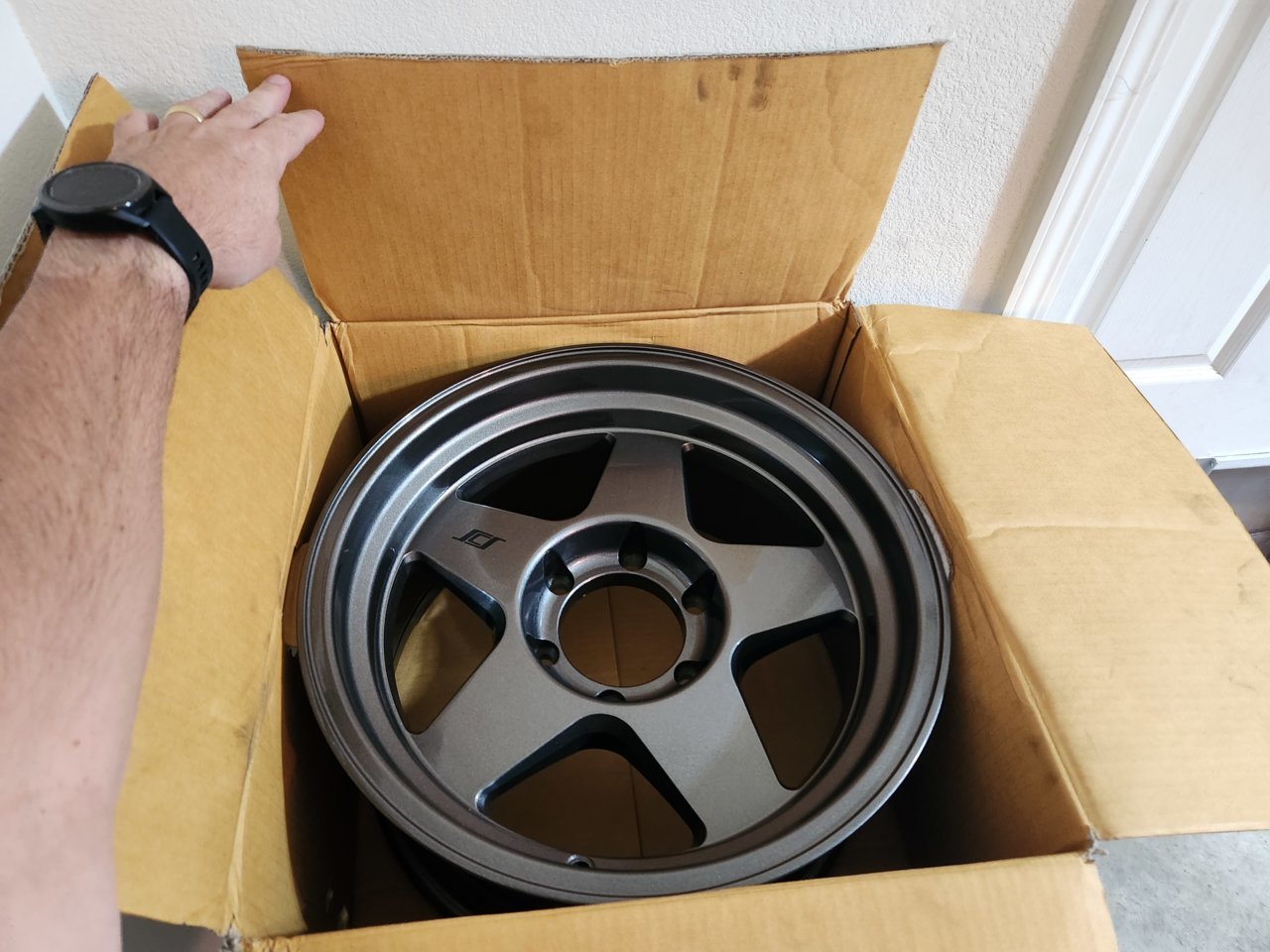

    Thanks. I have a feeling that I'll be doing much of the same. No spacers, but have -10mm offset which should net me 35mm (about 1.4") assuming your wheels are 25mm offset. BMC planned soon and pinch weld in front. Not sure about the rear clearance yet either.
