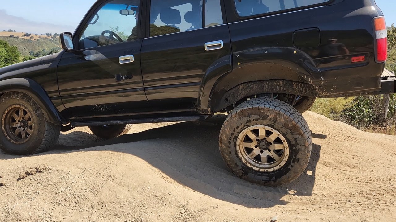

    Yep just over a month ago.
    The LC was ridiculous easy to wheel with, especially with a center and rear locker and +10" shocks front and rear. That made me decide I wanted a dedicated trail rig (single cab) and get a daily driver instead.
    Sway bar still on in the rear, and accidentally had left my extended bumpstops limiting my travel.
    Got rid of it for the GX and you can see little dude enjoys the rear air back there.
    Would be easier getting into a project that needs work too since I can just easily make my own parts when needed at home. Been churning parts out for two local shops as I'm their parts maker from home.
