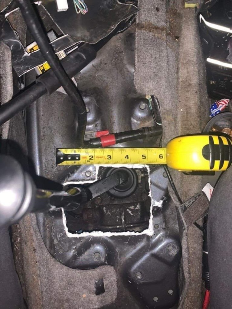

  5. Jan 23, 2025 at 11:30 AM
    #725
    locked up
    locked up New Member
    Jan 23, 2025
    #464669
    4
    Awesome truck!
    Looking back on this. Do you think that if the hole was cut to the size it is now, after you filled some spots in, the shifter you made would clear the bottom of the tunnel?
    I ask because I'm looking at doing this and want to leave as much of the tunnel in place as I can. I just can't tell if the part that sits right on top the tcase wold have hit the tunnel bottom.
    thanks
  6. Jan 27, 2025 at 8:13 PM
    #726
    xtremewlr
    xtremewlr [OP] Well-Known Member
    Oct 25, 2018
    #270626
    8,390
    Todd
    Tucson, AZ
    2003 4Runner V8 - 2012 b00sted XRunner
    I have mods
    It would clear the tunnel more than likely but anytime you needed to remove the shifter from the tcase, like to re-weld it, you would have to drop the tcase. You need the hole to at least be large enough to expose where the shifter goes into the tcase. You do not have to cut the hole further back, as I did, for the shifter movement.
  7. Jan 28, 2025 at 6:19 AM
    #727
    locked up
    Jan 23, 2025
    #464669
    4
    I was thinking that we could weld flat bar, similar to this picture, but tap the end (or weld a nut with a hole).
    So we would install the t-case with the flat piece already on, then screw in whatever we come up with for the shifter.
    So the shifter could be unscrewed. That way I could revise the shifter just by spinning it off.
    Terrible idea or ... ?
  8. Feb 18, 2025 at 7:50 AM
    #728
    locked up
    Jan 23, 2025
    #464669
    4
    So I unplug those 2 wires and route them to the FJ t-case switches ... but (forgive my ignorance) where does the other end go? Ground? Hot?

  10. May 5, 2025 at 2:52 PM
    #730
    locked up
    Jan 23, 2025
    #464669
    4
    Handle is welded and in place. I do not have pictures of the handle itself but will take some when I go to do dynamat. For the wiring, we interrupted the 2 wires coming from the 4xputer... but my lights flash instead of staying on. I'm pretty sure we just need to ground them instead of interrupting the computer but have not had a change to test it out.
