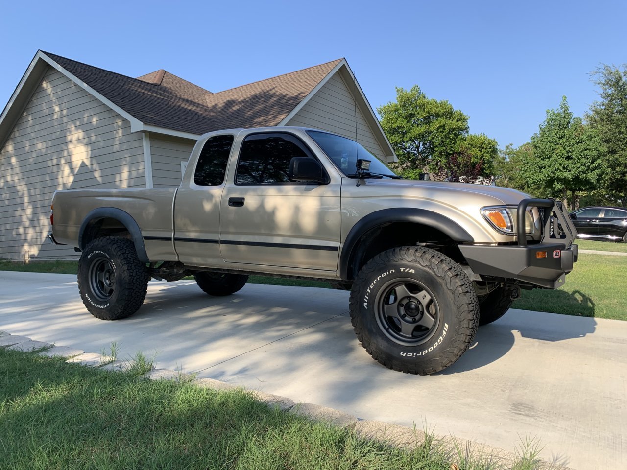

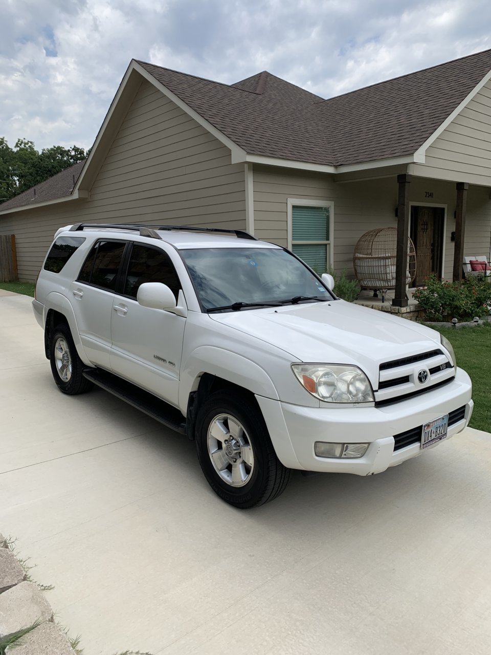

    Just picked up a 05 limited V8 4x4 for $6k definitely gonna read through your build for some inspo and ideas!
    here are my rigs
