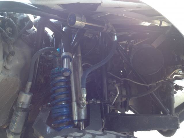

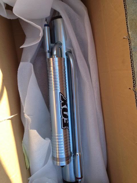

    Batteries are mounted and the 3.0 x 18" Fox triples are about to be put on the truck.
    Next is a full floater, 35's, and re-build of engine cage to make room for the turbo.

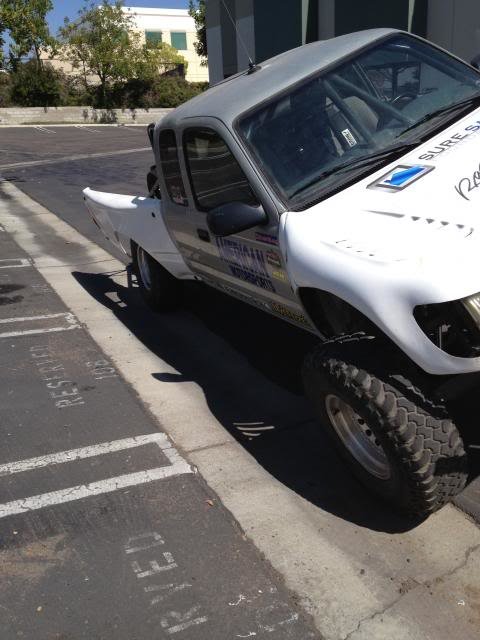

    and that pic of your truck in the air with the bedside partly ripped off has been the front screen of my iphone for a few months.

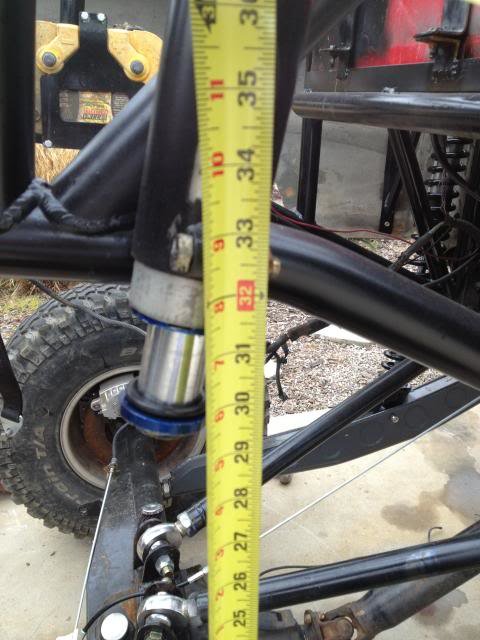

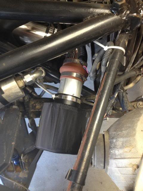

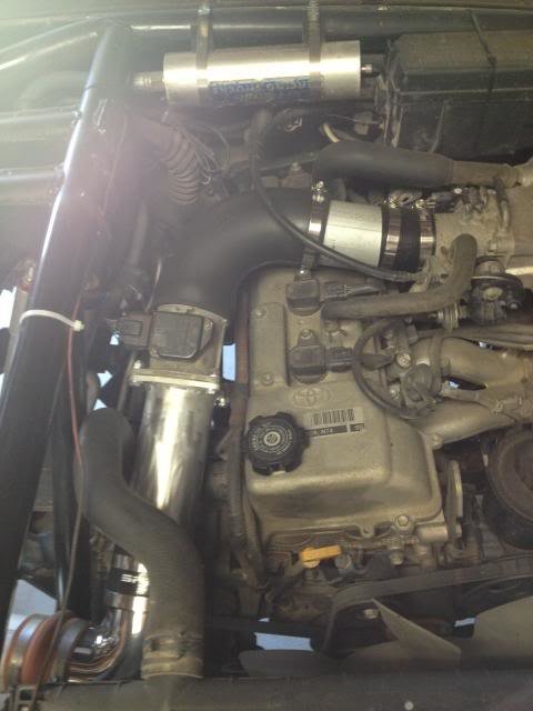

    Had to redo my intake so I got rid of the pos K&N air filter and went with an AEM dry flow and picked up a wrap for it.

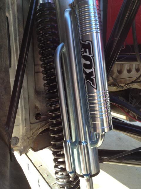

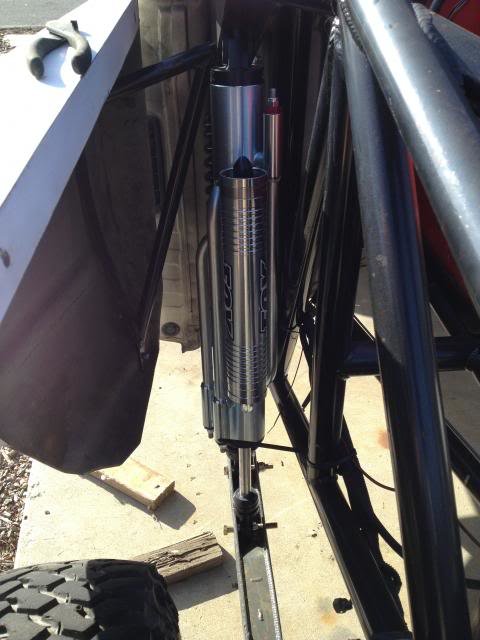

    The 3.0 x 18 triple bypasses are in but I won't be running them quite yet since I put the link tabs on the rear end too close to the back half tubes, plus I want to remake the front link perches to have more angle in them as well.

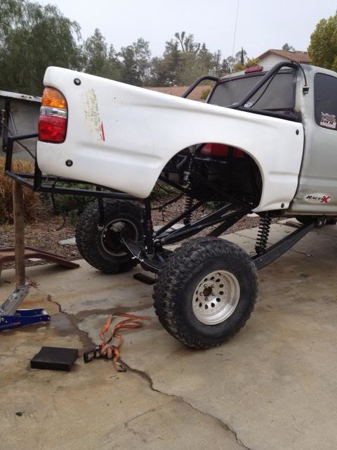

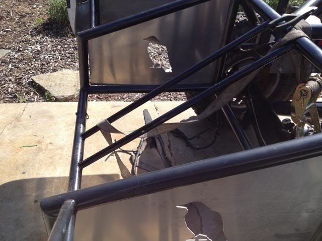

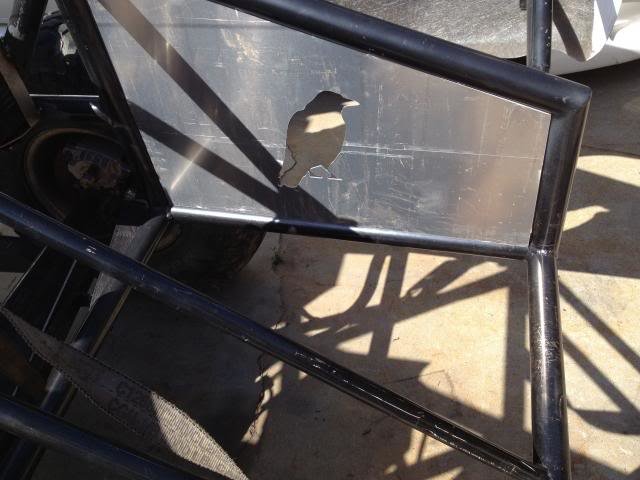

    Decided to do some sheet metal work to the bed cage. Don't mind the gap, I just have them wedged in there for mock up.

    I'm going to do something a little more custom so I can fit it between the engine cage and shock mounts.

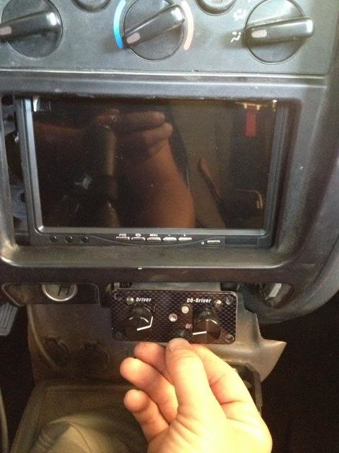

    Did a little more outfitting of the in-cab. Headsets and radio are hooked up, as well as a rear camera and 7" LCD screen for audio & video purposes when I'm on the way out to an event or a desert trip. Both are temporary placements until I re-design my center console which I may build as an OEM replacement.

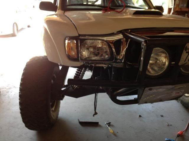

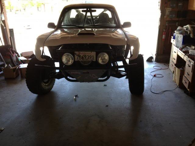

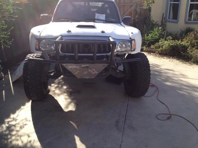

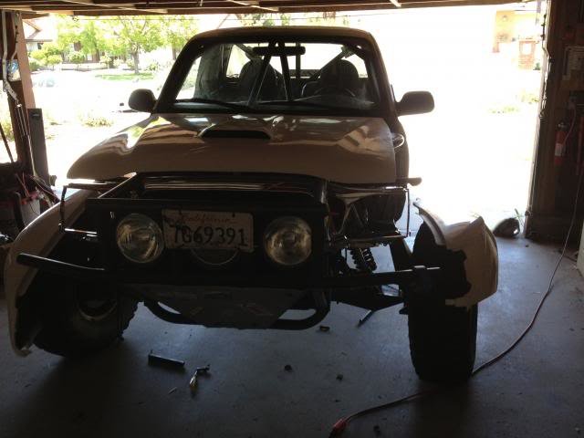

    Ditched the beat up 1-piece, decided to go back to it's original 01-04 front end.
    Mock up;

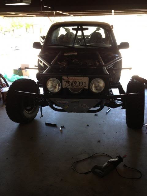

    Rebuilt engine cage;

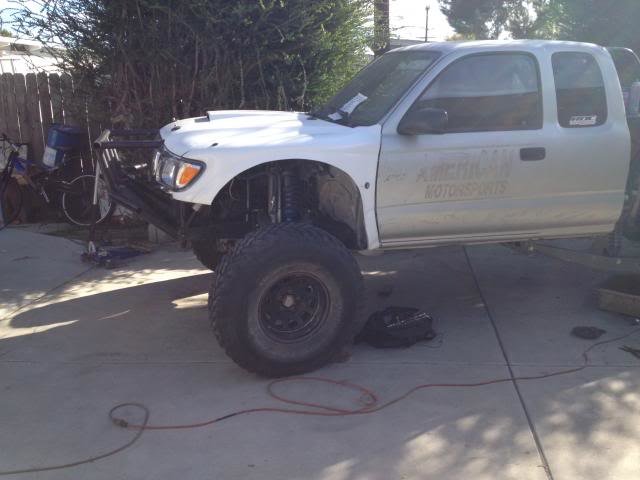

    Trimmed the fiberglass for the 35's to clear at bump. Tires sit about an inch from the glass.
