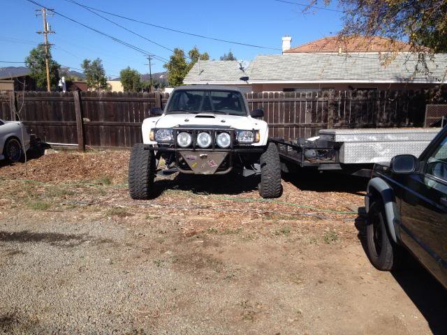

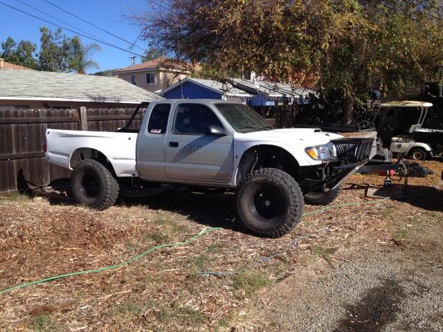

  18. Dec 22, 2013 at 11:40 AM
    #58
    noSKills858
    noSKills858 [OP] battlescars
    Jan 5, 2009
    #12256
    3,522
    Alex
    Poway, CA
    2003 5-lug Prerunner
    Couple shocks, some old tires, and a bad paint job
    Drove it today, then jumped it a little. Sitting on 35's feels really different but that's what I get for driving my Lexus SC4 when I can't run the truck (as you can see it a little in these pics).
  19. Dec 22, 2013 at 8:11 PM
    #59
    JuansTaco
    JuansTaco JuanInAMillion
    Nov 18, 2012
    #91397
    8,904
    Juan
    gilbert az
    2004 PreRunner SR5 stormtrooper
    ESB long travel kit, Deaver f67s with DTF 12 inch shackles.
    sweet rig man. cant wait to check it out at the superstition meet
  20. Dec 23, 2013 at 7:31 AM
    #60
    Phil Dammit
    Phil Dammit Well-Known Member
    Mar 11, 2012
    #74688
    8,305
    Your Mom
    Tempe, Arizona
    05 5 lug minitrucker
    4.5/5.5 drop, DJM arms, QA1 coilovers, 6lug leafs, QA1 18-way, rear swaybar, Batwing Big brakes, high flow cat, indy/hurst shifter, memphis amps, focal 3-ways, Eclipse AV unit, SunDown 10" custom box, TRD bucket swap.
    How bad is your 2rz straining with those 35's plus all the weight of the additional steel? Turbo soon to keep it competitive?
