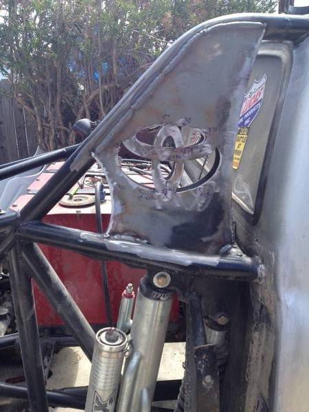

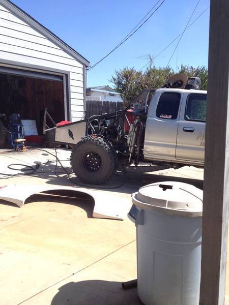

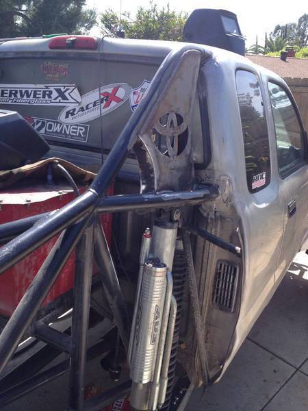

    Boxing in the shock mounts.

    I like the toyota logo. Almost had enough room to add in devil horns.

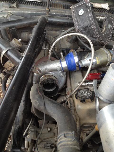

    I just bought it off some dude in Florida so its on its way here. It has a Garrett water cooled turbo, LCE manifold, and a Tial bov. I tried to make sure it was going to clear the tubes on my engine cage which I might get lucky otherwise chop the flange and modify it to fit. I don't have Megasquirt yet, but the guy I got it from @ CT, said he ran 5lbs on stock ecu and said it worked just fine with about 40hp gain and his buddy with the same setup running an intercooler, megasquirt, and pink top injectors (which mine came stock with) is getting close to 310rwhp with 12-14lbs of boost and is hard on the motor with just a set of ARP head studs and a better head gasket.

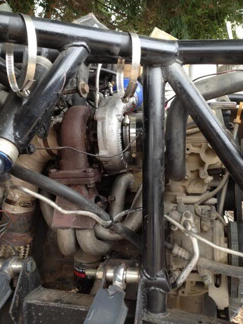

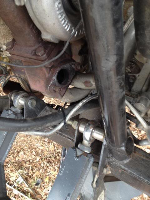

    Making progress but ran into a little snag, all in all it's been going pretty smooth;
    The problem with the size of the wastegate

    That beast fits in there near perfect. Easy fix for the wastegate. Does that header use the egr or you capping it off?
