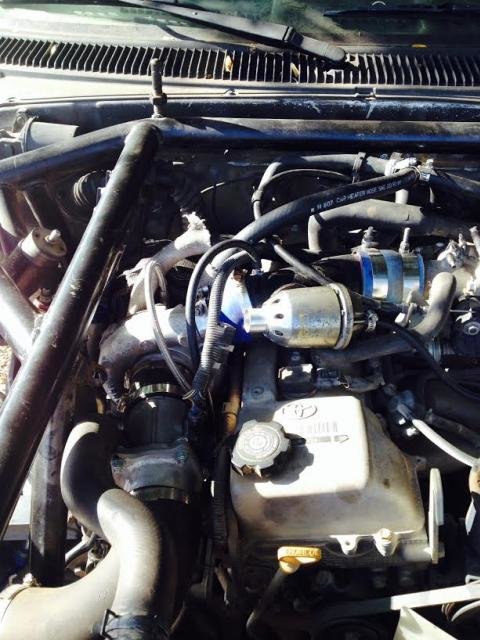

    Wastegate problem solved!

    You got that beast in there tight. Fyi if you are getting nasty weird afr reading your maf sensor may be getting turbulence from being so close to the turbo. Usually keep that guy a good foot or more away.

    Yeah I was getting bad idle from the MAF being so close because I didn't want to have to extend my wire loom. Inevitably I did move it much further away and it ran much better.
    Took it on a test drive and was boosting at 4500 around 8-10psi give or take on the gauge. After doing a few more runs watching the boost and afr I pulled over quickly to see a fire under my hood from my oil feed line which turned out to be screwed up from the resistor not being tightened because the threads were gone. Got it out, towed it home, and started taking the turbo off so I could get it rebuilt and balanced by the pro's. FYI Garrett Turbo's are top gun but parts are uber expensive too.

    Wow just a bit scary there. Glad it seems like a small fix. Already making some serious power on that test run.
