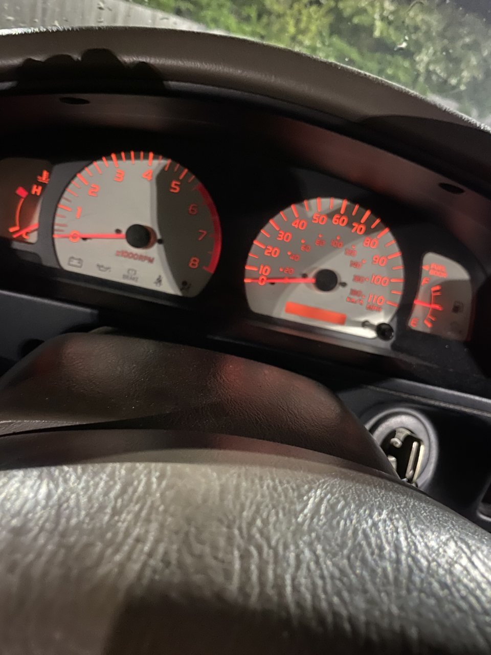

    upload_2022-7-6_23-3-46.jpg Im kinda new to my Tacoma it’s a 2002 are the lights on the Rpm normally dimmer after around 5k rpm

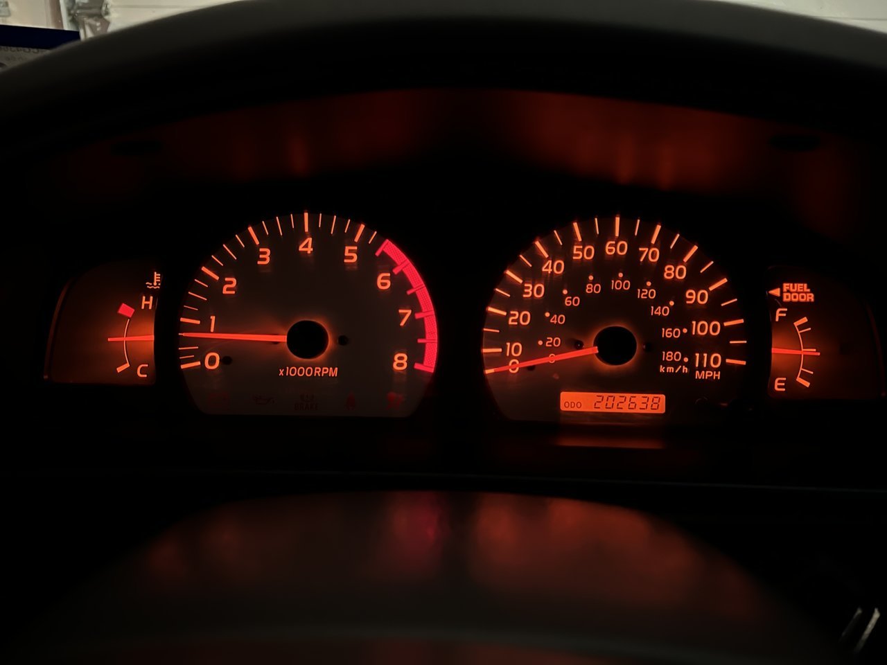

    Just bought the bulbs and hoping to knock this out today or tomorrow!

    Simple to do - doesn’t take long - hardest part is remembering which screw type goes where.
    Glad to have this completed!

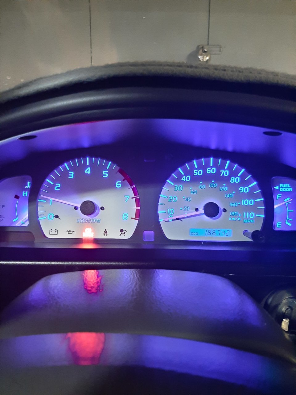

    Just did my dash cluster for the second time. This time I went blue. Super bright leds, I love it. I took my time, hope they last. I replaced ALL the 74's & 4 194's.
    Couple things & pointers/tips.
    My truck had orange bulb condoms on the 4 larger (main) cluster bulbs only. The entire cluster otherwise had clear bulbs. That means the ORANGE film for the check engine, overdrive & washer bottle is built in the cluster. I did NOT need any colored bulbs, if I wanted stock appearance.
    Take your time pulling apart the black dash pieces.
    When removing the bulb housings from instrument cluster...remove the part you twist out gently. The circuit board & film on the cluster housing is thin. You will see that when turning & removing bulb housings. Take it easy!!!
    If you use di-electric grease, lube the wires on NEW bulbs, DONT TOUCH THE GLASS PART.
    Watch videos & take your time. Make it count! If your younger, the jobs not that bad. For me, at 58, it's like playing Twister in a phone booth.
