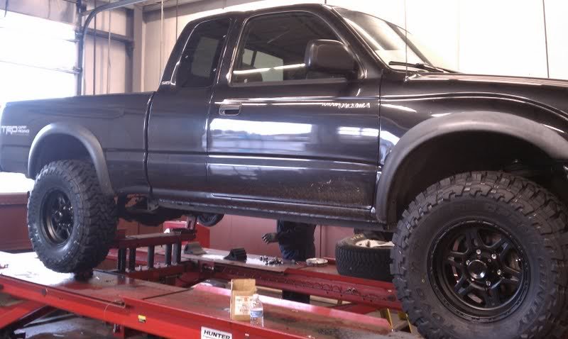

    not beadlocks, but for 103 dollars a wheel i think they are the best looking wheel out there. raceline renegade 16's. personally, i'd stay away from wheel spacers at all cost!

    Billstein 5100's & AAL, 285/75R16 Toyo Open Country M/Ts on Black 16x8 Raceline Renegades, Pro-Tech Toolbox, Wet Okole covers, K&N air filter, Tow package, Alpine digital media receiver, Kenwood Amp, Rockford Fosgate 10" sub, Cobra 75 hand held CB, front differential drop
    they're 16x8. got them through les schwab. i have a friend who is a local store manager, explaining the cheap price.

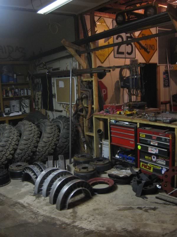

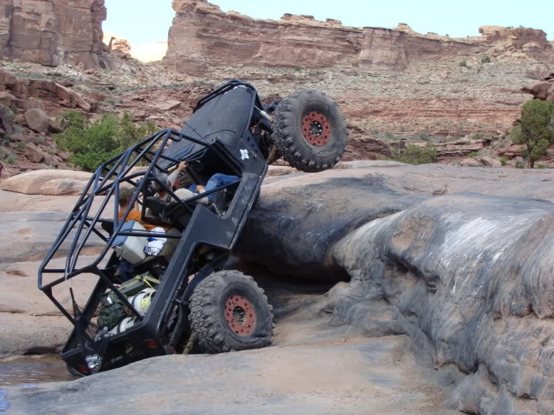

    these are H1 military issue double beadlock rims with run flats in them with custom laser cut naked lady rings, a bit more extreme than what you're looking at but shows what a tire with about 10 lbs of pressure looks like wrinkled up.
    all the pieces of the rims
    (big bro's CJ-8)
