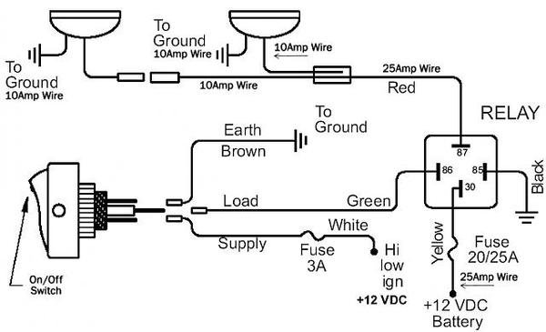

    I was thinking about using this Derale 16763 Electric Fan Relay Wire Harness
    How would I wire that?

    Instead of lights, your fan.
