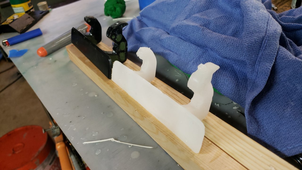

    If I make a few sets of these would anyone be interested? Making them for my own truck and a buddies, we are both sick of busted handles. They will be made using lost wax casting, solid aluminum handle units, will be polished off and clear coated to look like chrome. My inital thoughts are $100.00 a set, afterall these will be hand made handle replacements.

    I know for sure these will fit my 99 taco and my buddies 03 taco so I imagine they will fit most first gen door assemblies as well as some 4 runners. I am waiting for my kiln to get in and will post pics of the finished handle. Will do some testing for strength as cast, may need to solution anneal and age the handles for better longevity. If aging is required that means running the kiln for almost a week:/ the good news is I can cast probably 4 handles at a time maybe more and thermal cycle like 30 handles at a time so it will be cost effective.

    Yeah, here in Nor Cal its not uncommon to get 100°+ I have no doubts they will get warm lol. For my bud and I its more to get a kick out of finally having robust handles. On that note I have considered carbon fiber or g10 as a handle material bolted/countersunk to cast or machined arms. We wanted to go all metal of course lol!
