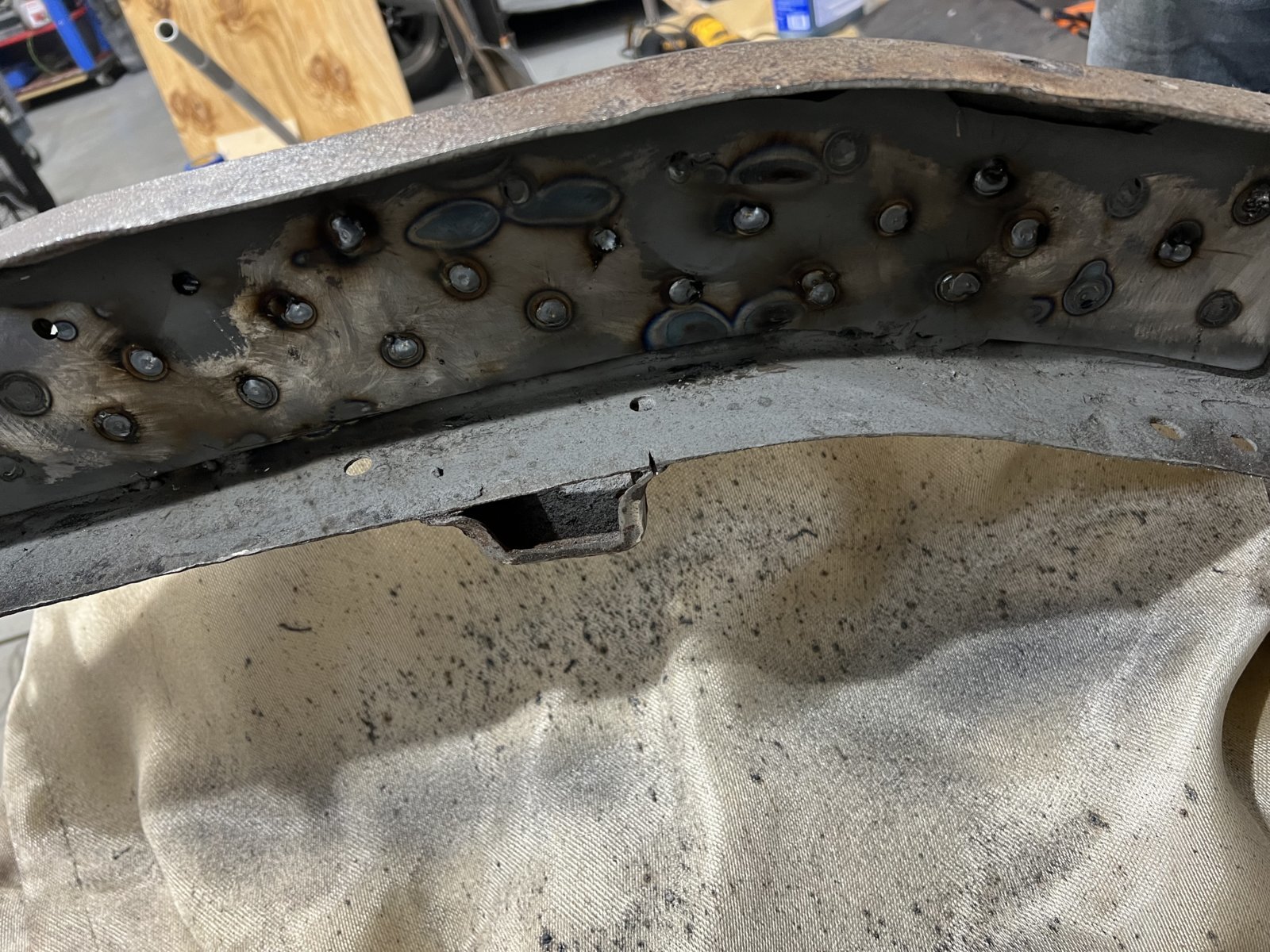

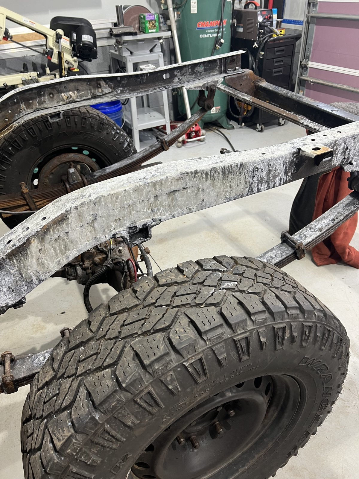

    IMG_3972.jpg IMG_4119.jpg IMG_4137.jpg Some more random shots:

    Looks good. It’s an uphill battle here in the north east. My 2004 was solid in the rear where I see most rot, but mine went up front.

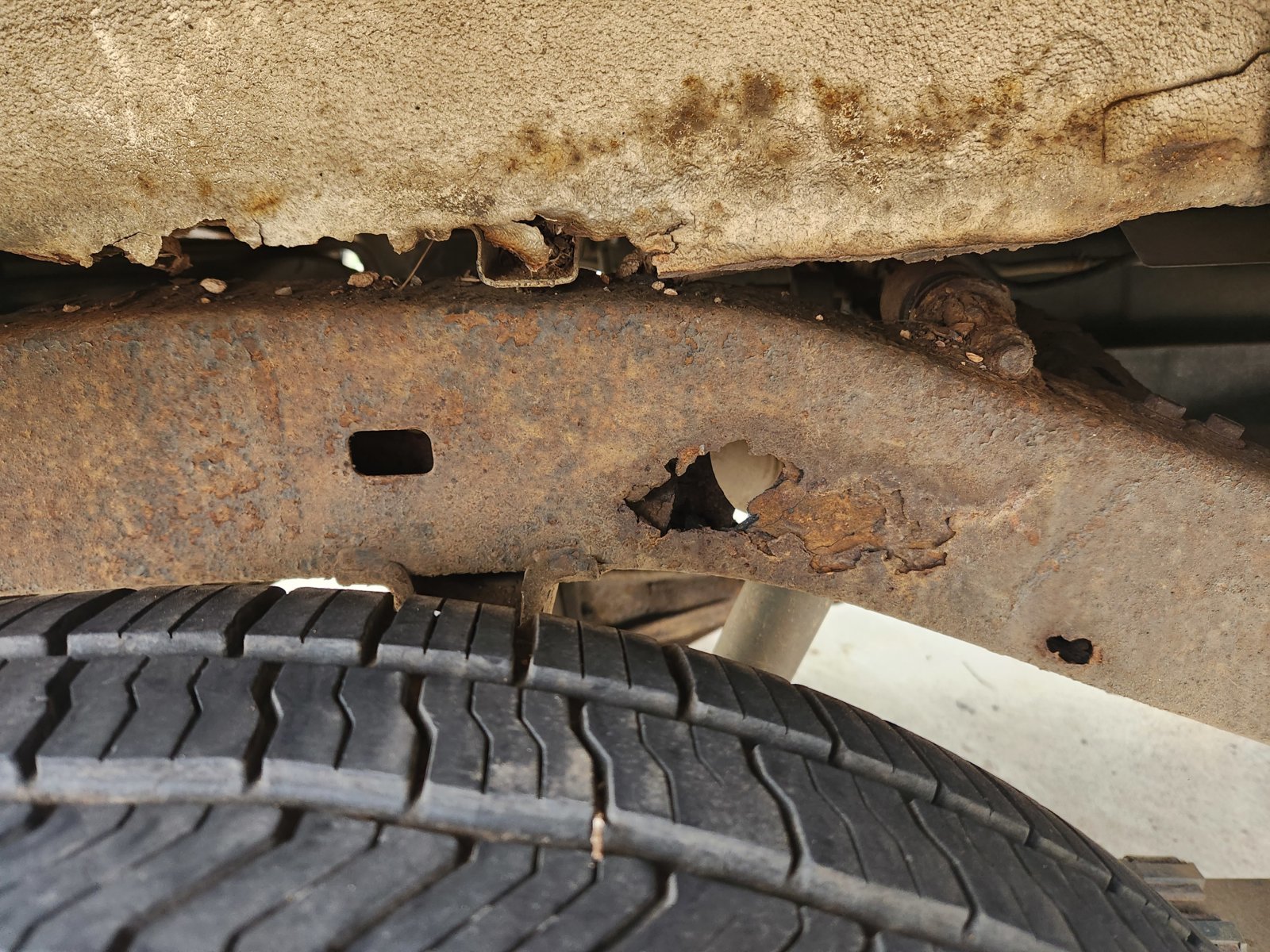

    Has anyone used ebay repair plates like these?
    Need to fix frame sides (I'm sure once cleaned, the damage is bigger)

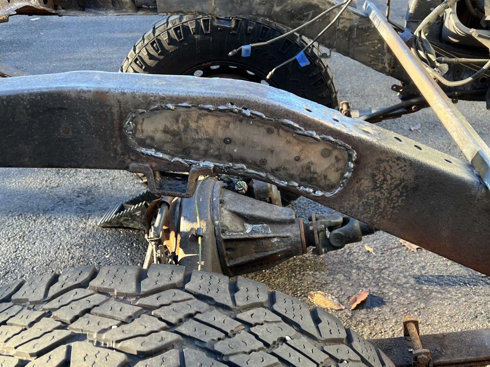

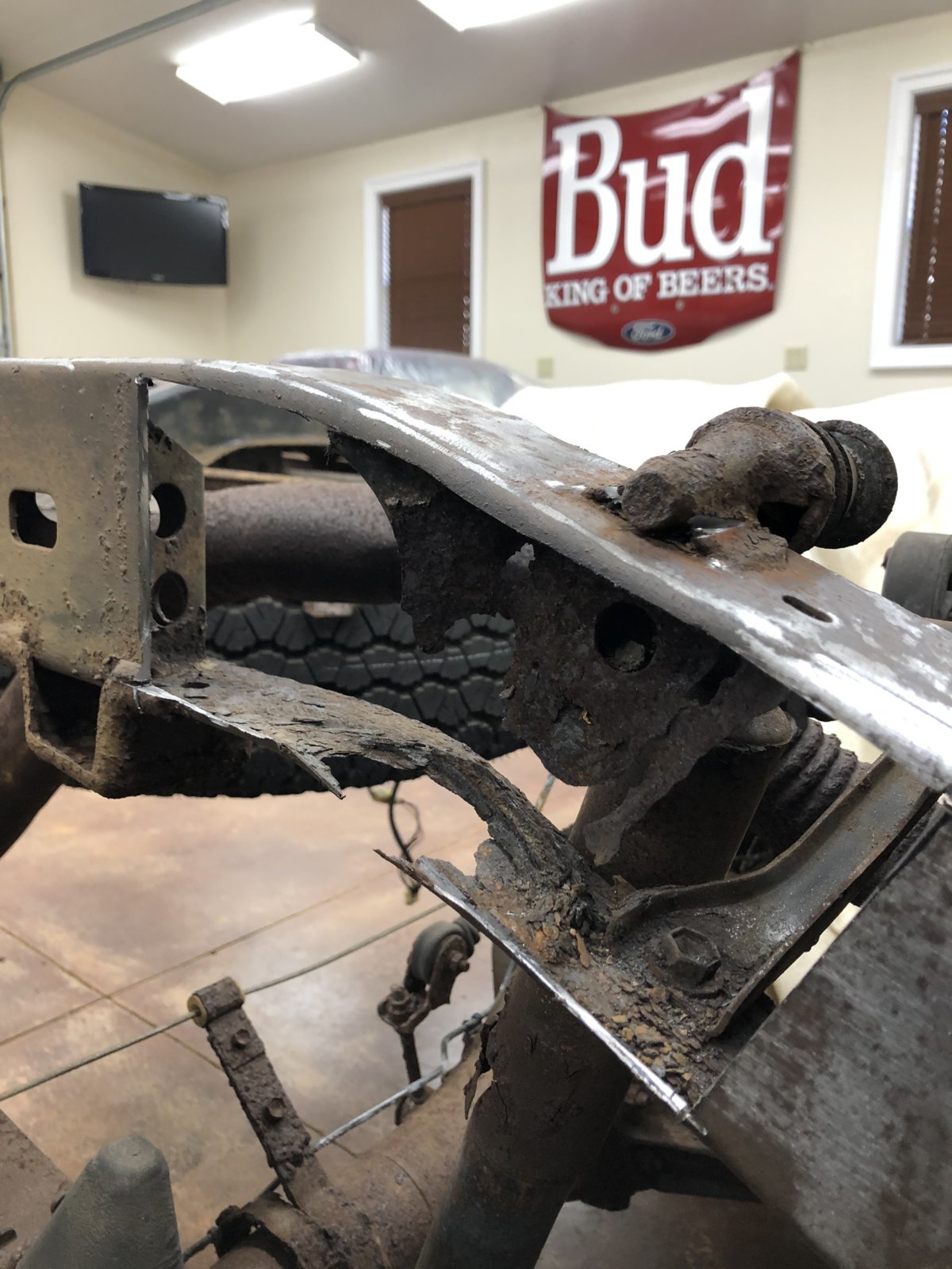

    That's more of a frame brace. I would recommend cutting all of that out and using Safety Caps. I did this on my 96 Tacoma a couple years back. I also used 11 gauge sheetmetal to restore the frame before welding the safety cap back on. Mine started off as two little pin holes and you can see how much I cut out to get to good metal. IMG_5259.jpg

    That's plan B :)
    Hoping to get away with the side repairs for now, with a major 'bed off' project later in summer.
