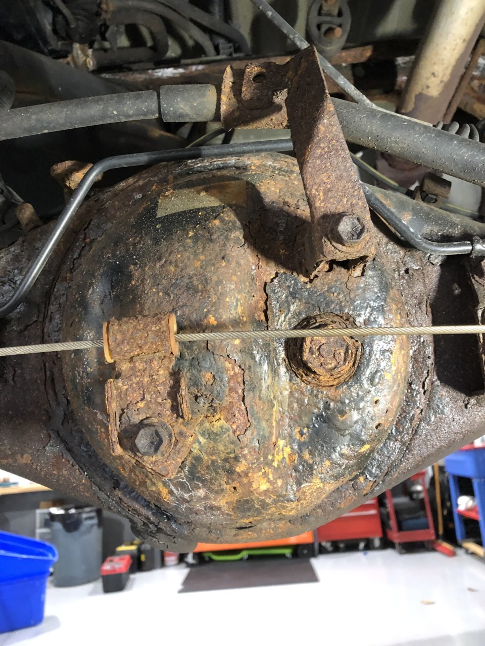

    Here is my initial plan of attack. I got under truck this morning and used OB blaster on the 6 bed bolts and between tailgate and bumper for spare-lowering bolt (and just about any other bolt I could see). I’m going to let her soak for a bit. I have no help as far as lifting the bed, but was wondering if I might be able to slip a couple of 2x4s under it and then use my 2-post lift to lift bed off frame. I have an engine hoist as well, but thought the lift idea might work.
    I’m definitely going to replace the fuel straps. I also see a bunch of other rusted components, like these brackets on the rear differential, and wonder if I should just start ordering these parts (assuming they are available).

    I would suggest using the 4 rope hooks inside bed to lift using the engine hoist.
    From the differential pic it appears the LSPV actuator rod pivot point has been used as a mount for the black line above. Has your truck been lifted?
    Is there a LSPV mounted on driver side frame behind fuel tank ?
    I can also see the old Toyota applied CRC on diff. flaking off.

    The truck has been lifted and has Old Man Emu AAL. I think the kit I bought came with a relocation bracket, but I didn’t do the actual install. I had it done at my buddys shop. Is that what that bracket is?
    what’s a LSPV?

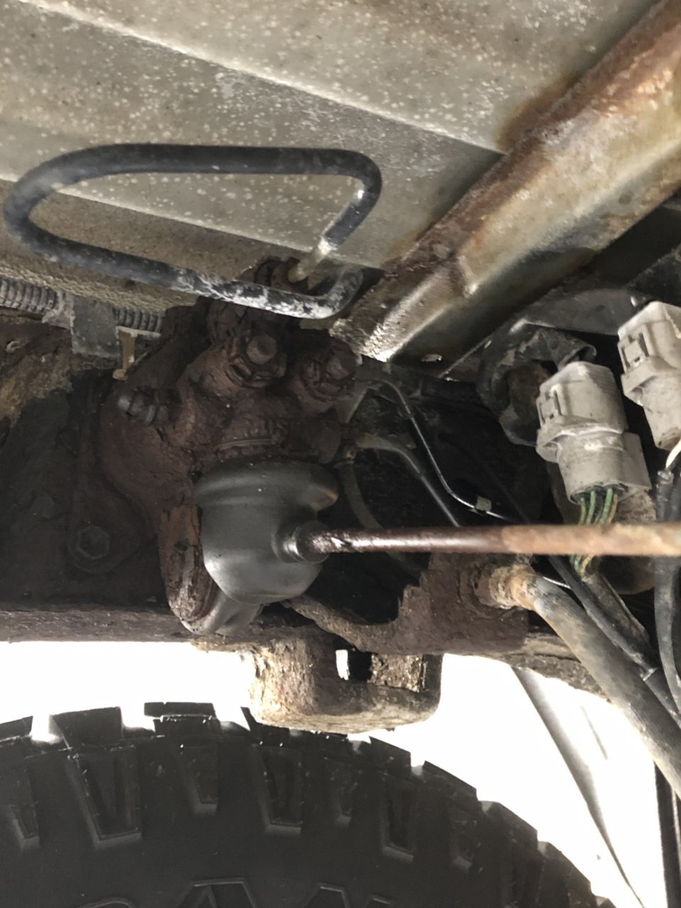

    Load Sensing Proportioning Valve
    It's located on driver side frame behind fuel tank.
    It uses a rod from the LSPV to an adjustable pivot point on rear differential and applies more rear braking as the bed drops from added weight of payload or trailer tongue weight. The pivot point shown in your pic is supporting a black line above.
    When a truck gets lifted the LSPV is removed and a manual valve is installed OR an extension to the LSPV actuator pivot is installed and the LSPV is kept and functions OR truck was lifted by someone who doesn't know about LSPVs and did who knows what which may leave truck with 0 rear brakes.

    Based on personal experience, I have a feeling it may look like an unidentifiable rust ball.
    I replaced mine with a simple manual adjustable one after it started leaking...due to rust

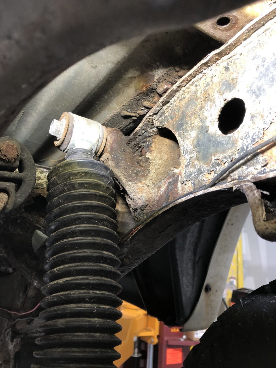

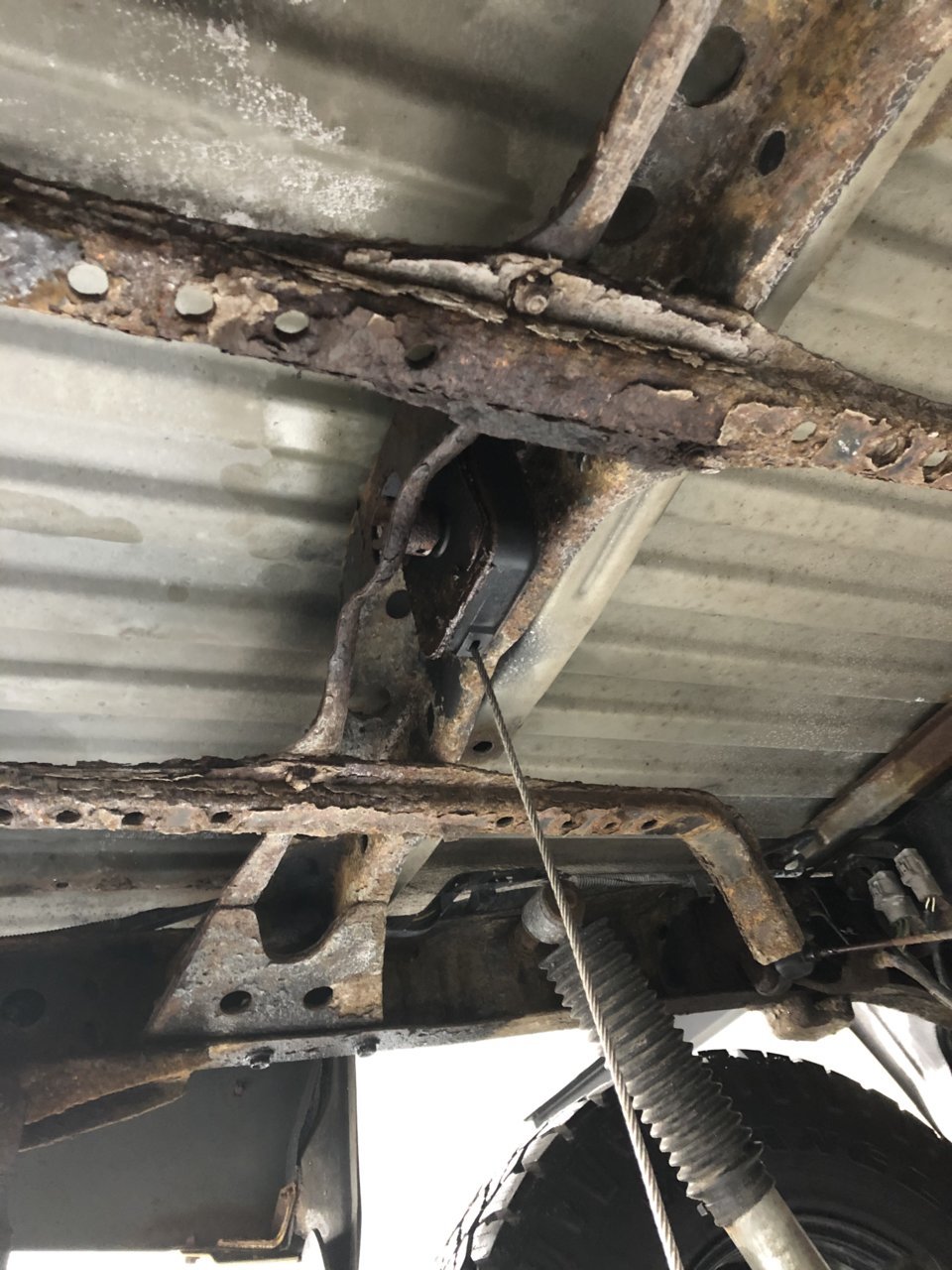

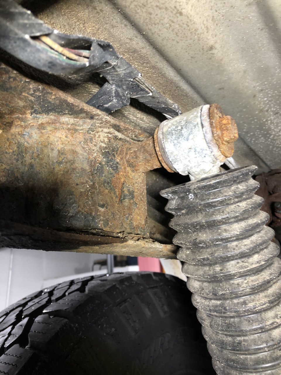

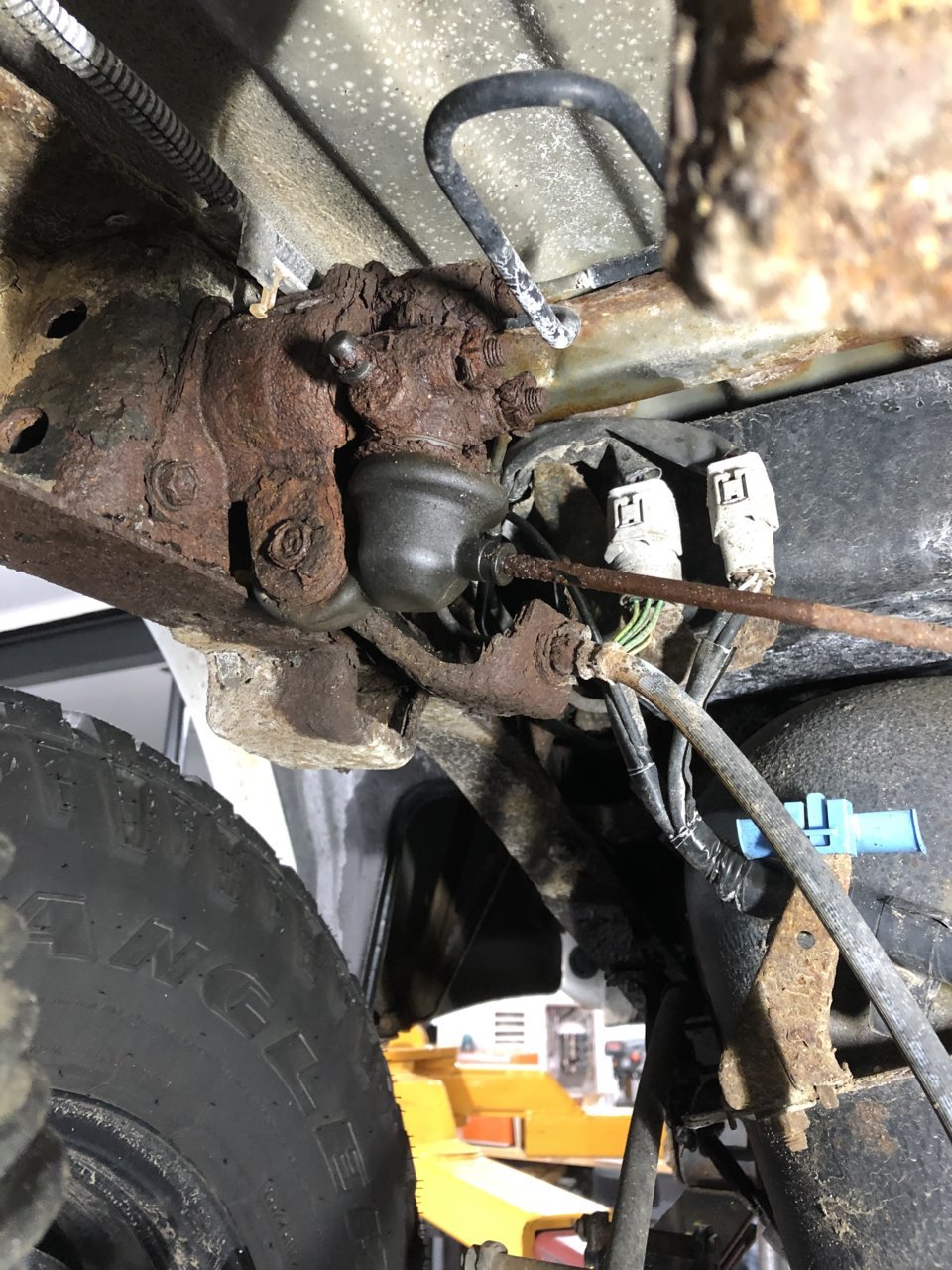

    I think the kit came with an extension for that unit. I say that because the rod looks fairly new. Here are some photos I just took. The spare wheel came down without any problems.

    I wonder if I should order that rearmost crossmember that the spare tire attached to (as well as those bars that hold it in place)

    Congratulations on getting spare down.
    I would do lots of hammer testing before ordering parts.
