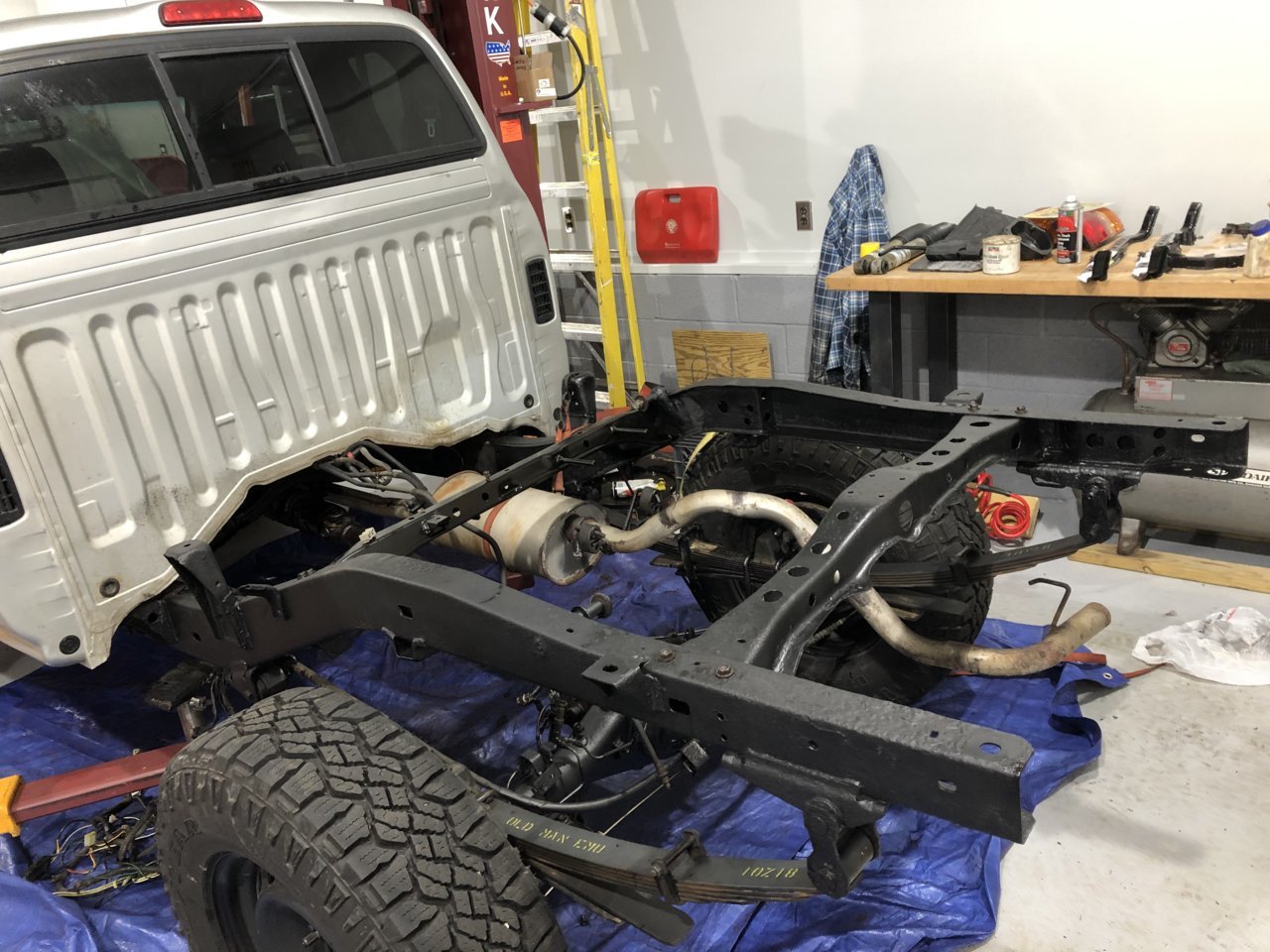

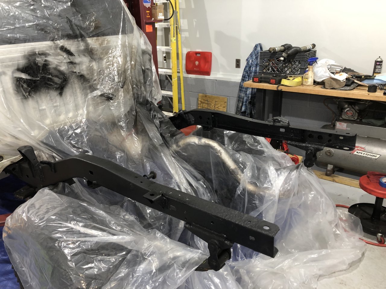

    Was going to paint the spare tire crossmember today. The Corroseal has had about 40 hr of drying time. According to the Corroseal FAQ, the product also serves as a self-etching primer, so can I paint over it directly or should I add a coat of primer?
    Black DOG Lila likes this.
  9. Jan 2, 2021 at 5:23 AM
    #129
    Black DOG Lila
    Black DOG Lila Well-Known Member
    Jun 14, 2019
    #296344
    9,116
    Virginia
    2003 Tacoma SR5 2.7 5 speed 4WD
    Stock. EZ pass.Dump pass.Inspection sticker.Convict printed lic.plates.FG cap.
    @BossFan
    No primer needed over Coroseal..
    Top coat frame exterior with paint or Fluid Film inside box members.

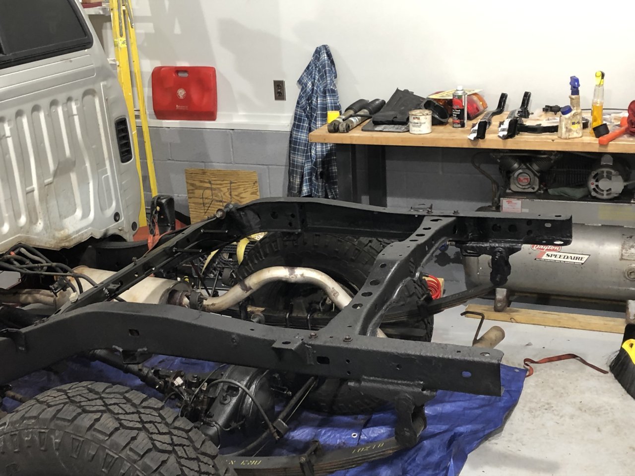

    I got the differential coated with Corroseal. Surprisingly, the vent tube and fill plug came out without issue. I also got the driveshaft crossmember cleaned up and Cortoseal’d as well as the driveshaft. Topcoat wide, I got the spare tire crossmember painted as well as the frame rails. It’s not a showpiece for sure, but I think it looks much better and I’m so glad that BDL educated me on how to use a needle gun and also about Corroseal.

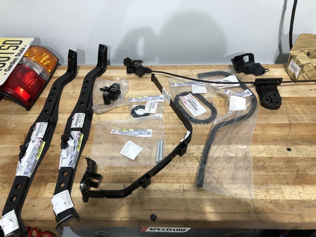

    I also removed the brake lines (which did a number on my epoxy floor, but I’ll rant about that later. I ordered some 3/16 line and the M10 fittings, but I realized that when the old ones came out, they have like a rubber coating on them. I’m assuming this is for additional protection, especially when you’re off-roading. Should I just order the stock replacements from Toyota? What’s another $100 at this point? or would the ‘bare’ brake line be ok to use?

    I got one box of goodies yesterday. Tank strap, spare tire straps, LSPV, some hoses and gaskets. My vapor canister, and LSPV bracket (Toyota) and my gas tank (RockAuto) are in transit. Should get here on Monday.

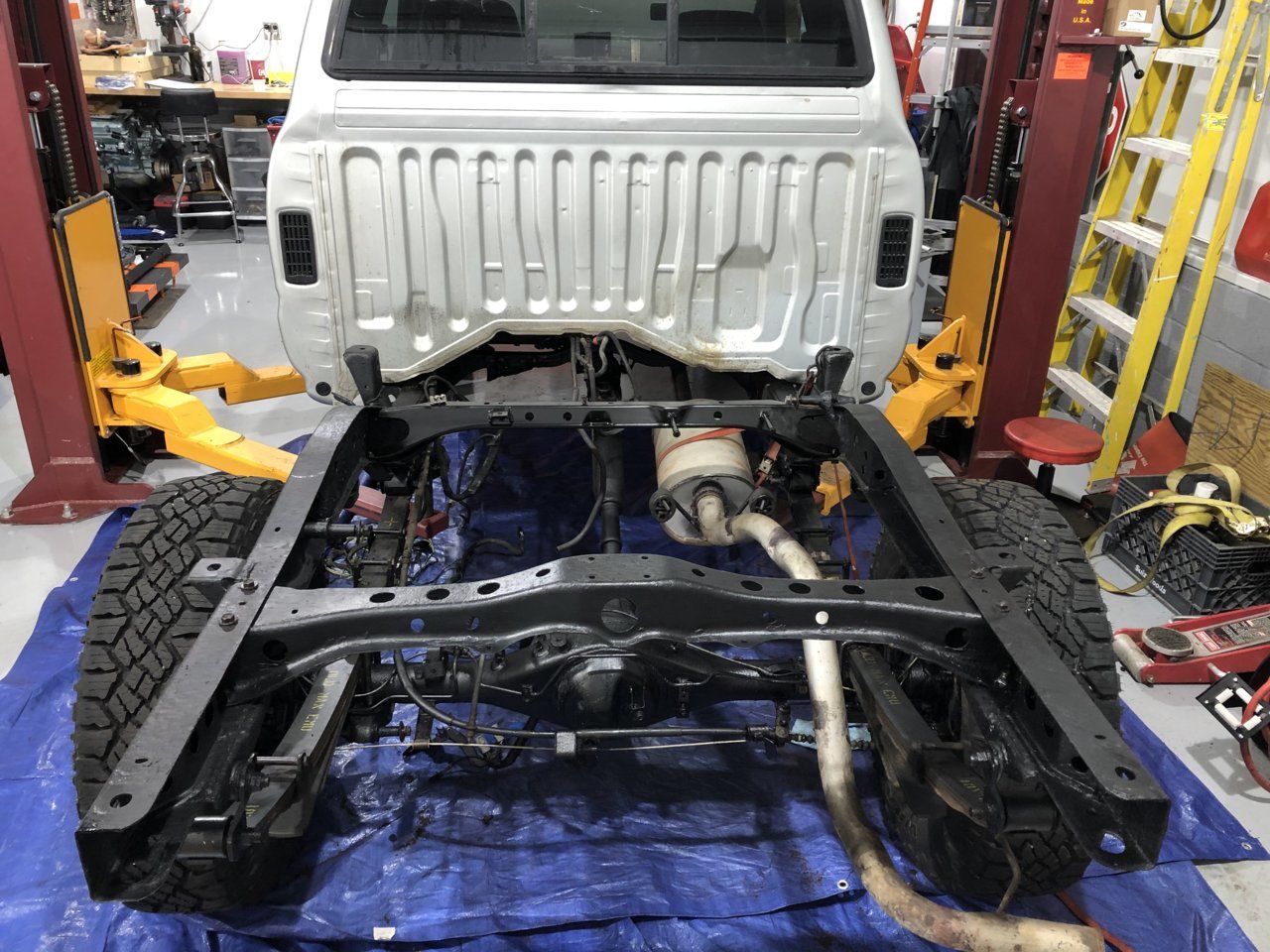

    Put the crossmembers back in today. They want $300 to ship me the brake lines via freight. I’m going to see if I can get them from any dealers up here in NJ
