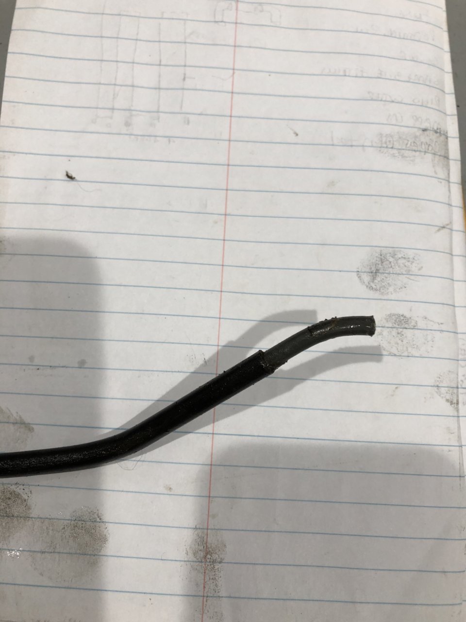

    I agree if you are going the stainless route. I don’t have the tools to bend/flare SS line. I was originally going to replace the originals with bare copper/nickel lines, but I’m not sure these would be the best choice even for the limited amount of off-roading I do. I did a bit of research and they do make a PVF-coated brake line. I think this PVF (polyvinyl fluoride) coating is what the factory used.

    Not sure how well the coating shows up in the photo but here is a picture of the end of my factory brake line that I cut.

    2000 reg cab 4x4 flatbed MT
    I wonder if that's a newer thing. this is what mine look like

    I'd assume its chafe/abrasion protection of some form
    I'd coat the lines with a cosmoline coating then put some heater/vacuum line hose over the areas that might rub on the frame, it I was going it

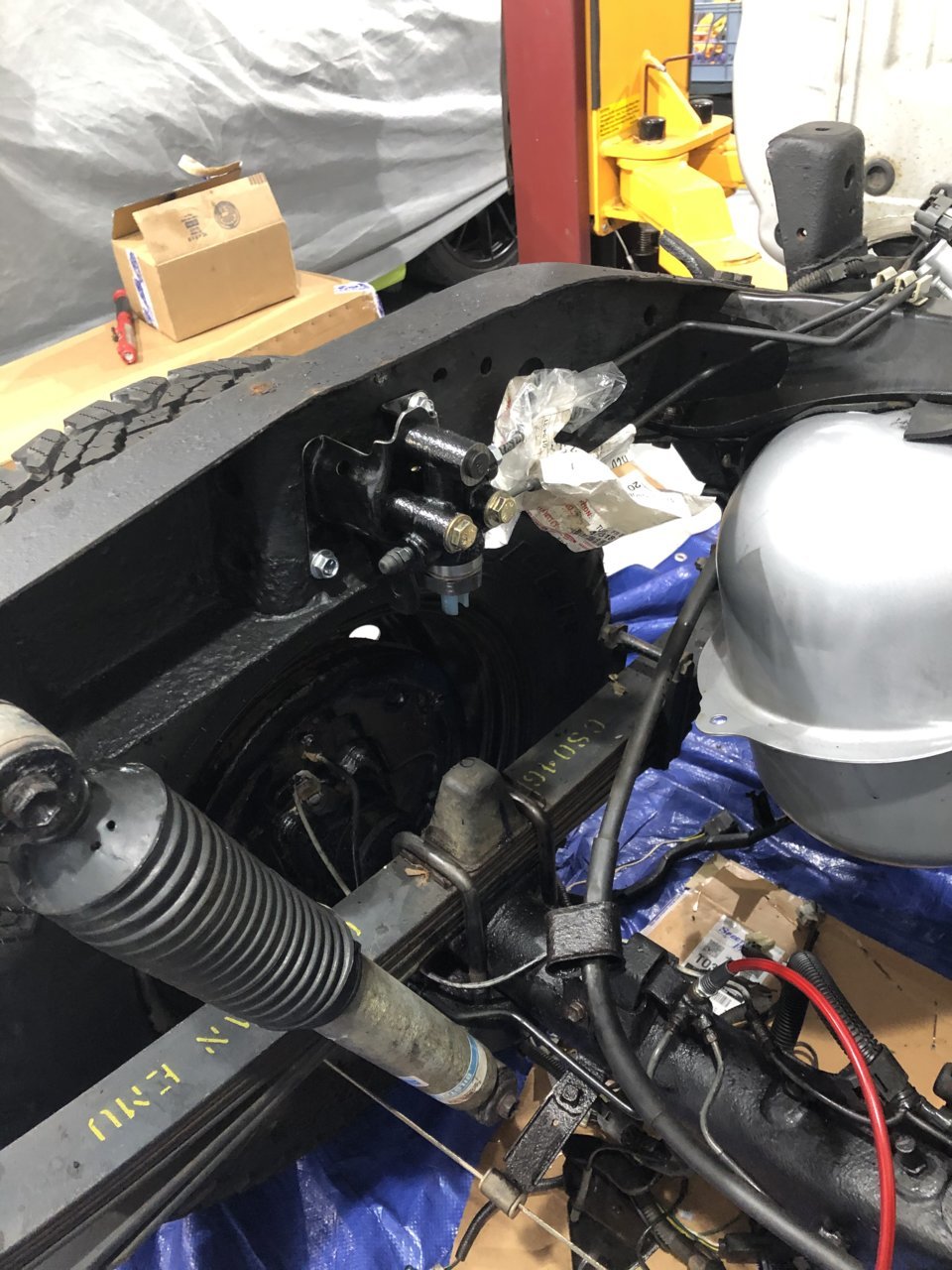

    Picked up brake lines yesterday from local Toyota dealer. Fellow at the parts counter warned me that putting these in was going to be really difficult (he didn’t know I had the bed off). I got them installed in about 15 min. Was very useful to have the parts diagram printed to know which one snapped in where.
    Going to try and get everything back together tomorrow.

    I pulled my new Spectra fuel tank out of the box today to start putting the pump and pickup in it and had a question. Does this have to be painted? The one I took out of the truck was either painted or coated black.

    Does it look different on the inside? Kinda looks painted to me.

    It looks the same as the new gas tank I put in my GTO over the summer. That same ‘bare galvanized’ look.

    Gas tank is installed. So is LSPV , though I didn’t put the arm on it yet because I’m still waiting for a part.

    Sounds like it's painted
