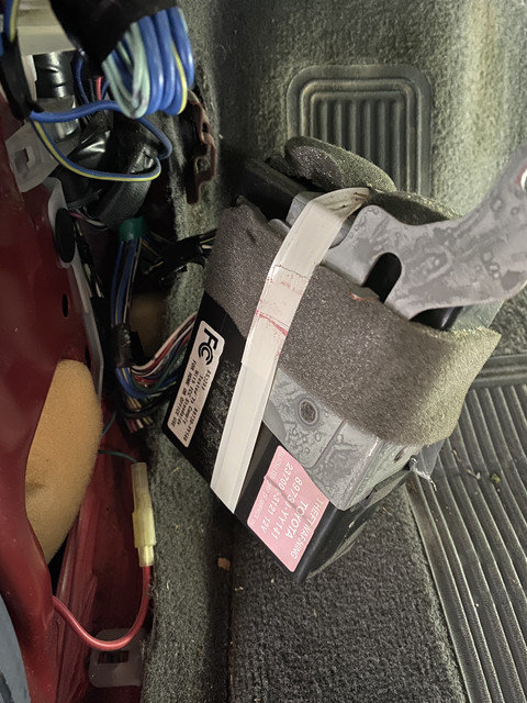

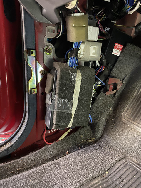

    @4xdog you was right there she is in all her glory.
    99-F4-A5-B2-4-C40-4738-8-ED8-F38012-B41-_d6096acd0ac42a87a6ba511797184d2373dfff78.jpg
    7-A9-A0-D13-0585-401-E-AFE8-4-C640244516_389c2eadbadd81ea7125373b9c5f393eae847edd.jpg

    i had problems with aftermarket units that didn’t sync to my system. i ordered OEM and worked like a charm

    Talk to an actual person. Don't go by the listing. It might be wrong.

    The listing was right for some cases but not others and they didn’t know what worked for it.
    Only way I figured it out was by these forums.
