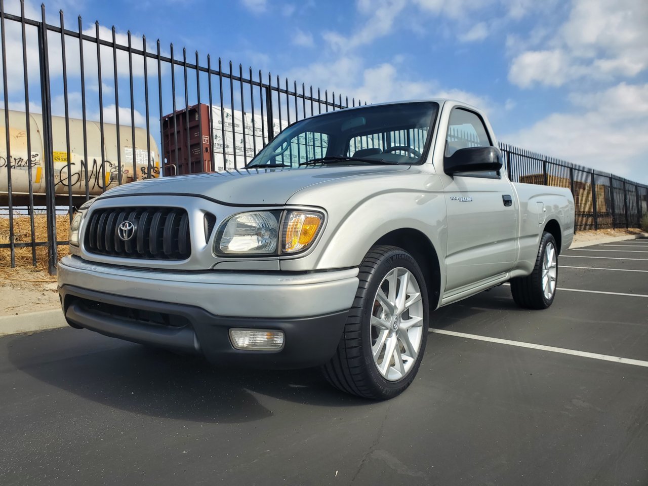

    If you want high performance summer rated tires which will be the best mod you can do to improve handling, you need to look at least the 17" diameter and up, they just dont make them smaller any more!
    I am running 2012 Lexus IS250 wheels in 17 x 8" with 45mm offset and 245/45/17's Michelin Pilot Sport 4S:
    And found this was good enough to beat a Lamborghini, Vette, Mustang, Porsche, Camaro and a Miata my first time ever trying an autocross last weekend!
    If you are into factory wheels is a database where you can search for your diameter and offset and find most any wheel ever made that will fit your truck. The center bore on these is rather large though and needs to be 67.1 or larger. I had centers bored at a wheel machine shop for $20 each to make them fit.
    The offset calculator was a huge help too. I could look up specs of what others said "worked" and see how it would effect the inner clearance and and far or in the wheel would stick out compared to stock and wheels I was looking at. And of course the legendary Tacoma World tire calculator for diameter and width spec comparisons gets a mention and was highly valuable!

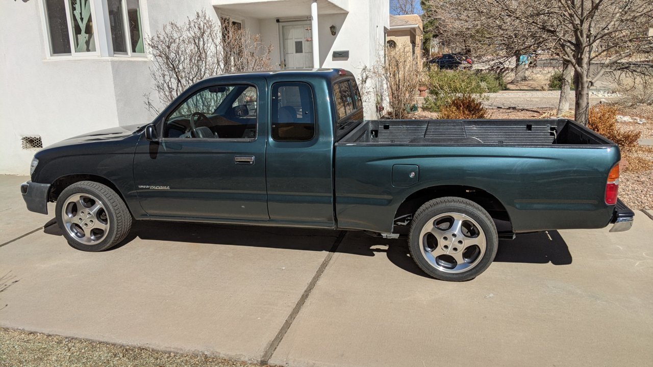

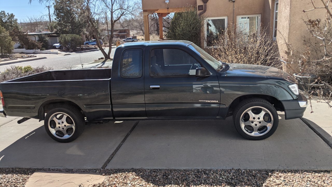

    My 98 stock height with the original wheels from my 97 Cobra. 17x8, 30mm offset, 245/45/17 Michelin Pilots sport AS tires.
