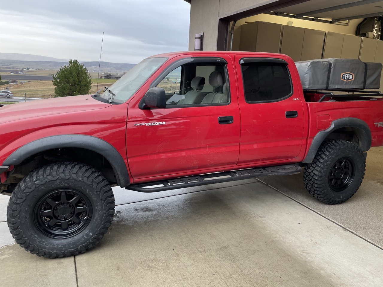

    Got new wheels and tires on yesterday
    These racelines look great and are a great price.
    33” KM3’s, 16x8, 0 offset Raceline ScoutsEE4F89CE-E63E-4077-9468-F433C70075F1.jpg

    Any frame rubbing with the zero offset?

    Literally no rubbing at all. It’s close on the mud flap at almost full lock, but I would have to be going over 20 and hit a bump to do that I’d imagine. And I’ll probably never be going that fast, with that much of a turn

    Awesome, I read a few complaints of 285/75/16s mounted on 0 offset wheels rubbing the frames. I can trim/cut flares, plastic, the pinch weld all day. Rubbing the frame due to wheel offset/back-spacing is a different story

    I think that also has to do with tire brand/make too. I had a set of F5's with zero offset (4.5" BS), and rubbed the frame on the side lugs of the tire when at full lock.
    Switched to the 3.5" BS F5's and that solved my problem.
    Some people deal with it, but it would bug me too much so I couldn't live with it

    how'd you know i read through your build? I was eventually wanting a set of F5s in 4.5bs as well.

    I would recommend the 3.5 BS ones to anyone that wants to run a 285 without rubbing and potentially go up to a bigger tire down the line.
    If you don't think you'll go bigger than a 33, then the 4.5's would be fine with some minor rubbing. Otherwise you'll have bad rubbing on anything bigger without a big ass spacer.
