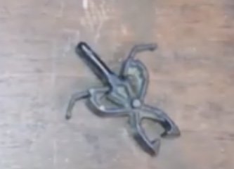

    42E841D0-A6BB-411F-BB46-FA937462B1BA.jpg anyone know the part number of the large grill clip that attaches the lower corners to the headlight assembly?

    I just got some in the mail today. The number on the receipt from Toyota was 53145-12010

    HAHA!!! I had to use a type of set screw. I installed it up through where those clips attach for the headlight filler on the driver's side. That made it stay nice & tight. Otherwise the whole end of the filler and part of the marker light lense would move back & forth. It doesn't matter if you have a brand new clip for those fillers. It's the part that the clip snaps into, that wouldn't keep the clip tight. At least on my truck.
