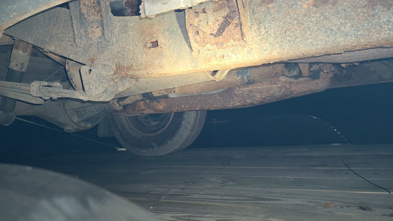

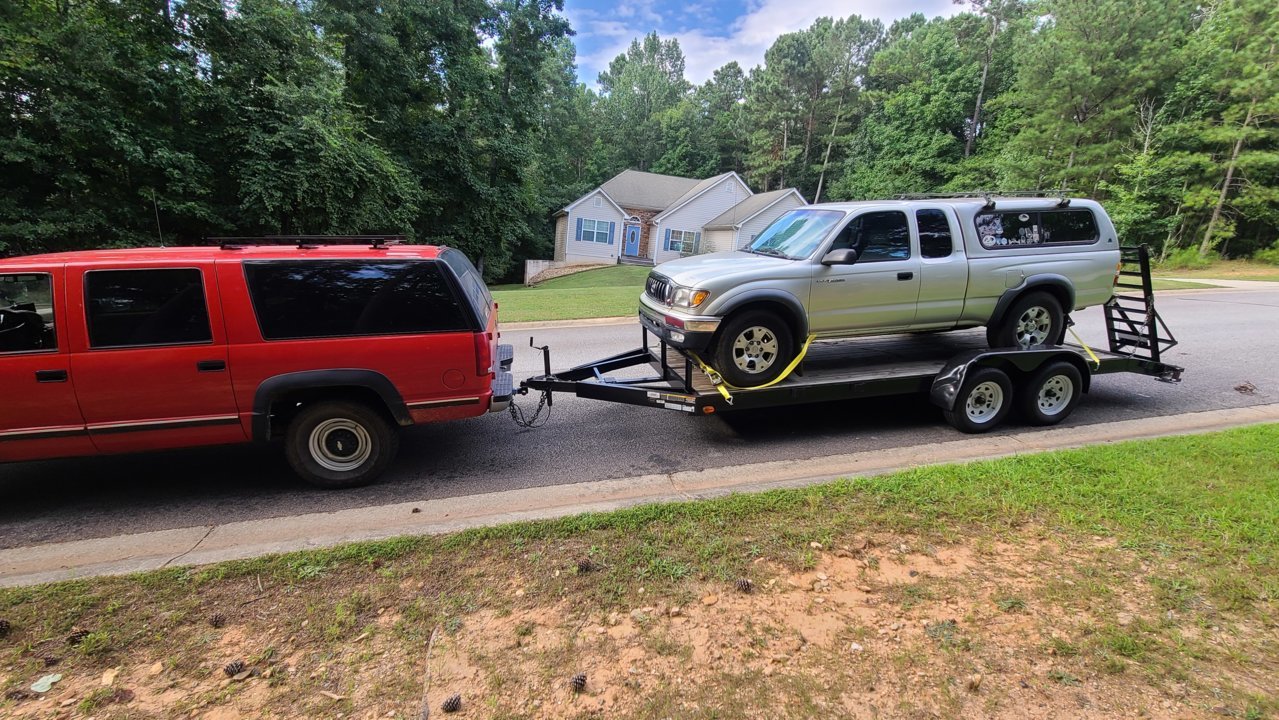

    Anyways I picked up a very good running 04 extended cab 4x4 but has a severely rusted frame. I got it super cheap and trailered it home. It has around 160k on the clock, everything works great. It's in much better shape, besides the frame, compared to my 01 Prerunner double cab.
    Anyways I need some direction on what to do with this. I know I can part it out but seems like a waste of a heck of a truck.
    Thanks!
    Rust on the trailer from 3 hour ride home .

    Start looking in the dry western states for a new frame and swap it. Plan a vacation around the trip to get the frame.

    That is a nice looking truck.
    Post some pics of the frame so we can give better advice.

    looks clean. i'd be hunting a frame down for that bad boy and keeping her on the road. damn things are turning into collectors items

    Uploaded some frame pics!

    Yup, new frame time. Where was the truck from? That looks like Vermont rot!

    yea that one seems too far gone. but being in Georgia you can find a frame far easier than i can up here in Indiana

    How stupid would it be to drive around in my woods? Definitely not on the road but I have some fun trails I've made to ease around on and look at some wildlife.

    That thing is one bump away from collapsing on itself. I’m actually surprised it didn’t crumble on the trailer

    There was a lot that flaked off on the trailer. I guess I'll keep it parked until I get a plan on what to do.

    yea i would park and not even put anything in the bed. that mount for the leaf has sunk way into the frame.. probably not actually attached to anything anymore and the top of the frames all thats holding it up still.
