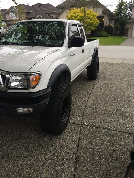

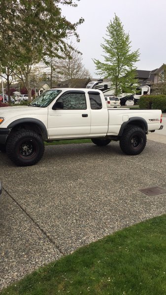

    Hi I got a 04 Tacoma with 2.5" lift in the front and 1.5" in back I picked up 285/75r16 duratracs and 16x8 -38mm offset wheels any idea how much cutting is required if any?

    Wow -38 is a huge offset not sure how that will affect it but usually with 4"back spacing and that lift you just hammer the pinch weld

    you are sitting at about 3.25" backspace... sounds like the old school steel wheels that the 4x4 Taco owners used to do on the TTORA boards... at 2.5" lift, you may have to trim the front lower valance on the bottom of the front bumper, hammer the pinch weld all the way in, and either trim the black fender flare trim or remove it altogether...

    Thanks for the response! Had to trim the front bumper and hammer the pinch weld. She's looking good now!

    Welcome to TW. :wave: Looks really good imo. I don't think it sticks out far at all.
