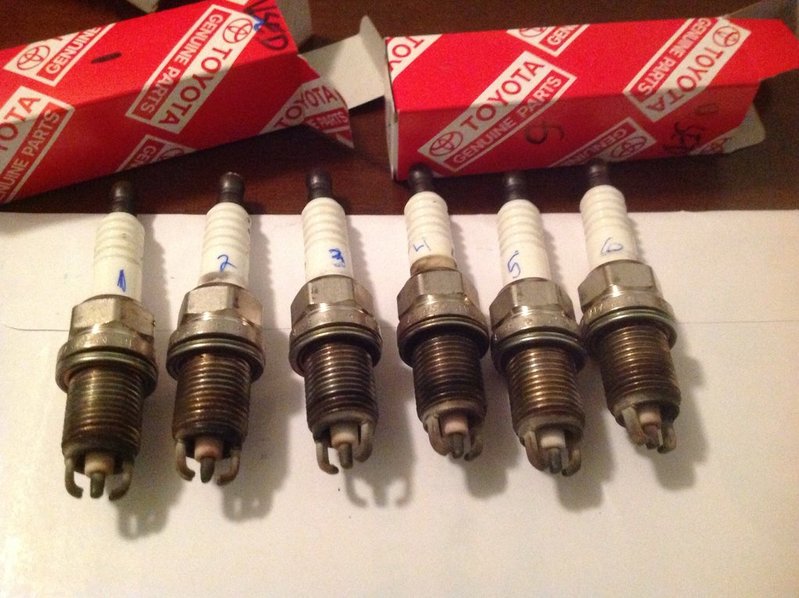

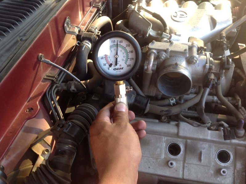

    Just did a compression check and replaced my spark plugs and wires.
    Cylinder 1 - 175psi
    Cylinder 2 - 165psi
    Cylinder 3 - 170psi
    Cylinder 4 - 170psi
    Cylinder 5 - 169psi
    Cylinder 6 - 180psi
    I think it's good, their is a 15psi difference between cylinders 2 & 8 but that is max acceptable difference. The spark plugs look good, #4 looks like it might have been loose. What do you guys think?

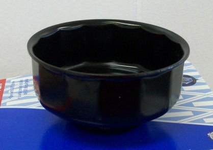

    So last week I finally changed my oil to Mobil1 Synthetic and one quart of Lucas. Well it became an ordeal because what should have taken 4min or less became three hours. Short story previous person that changed the oil filter tightened too much. I tried undoing it by hand, leather belt, even regular oil filter clamp but no luck. Because it was too late to go to AuyoZone I ended up having to remove the alternator :(
    Next time buy one of these:

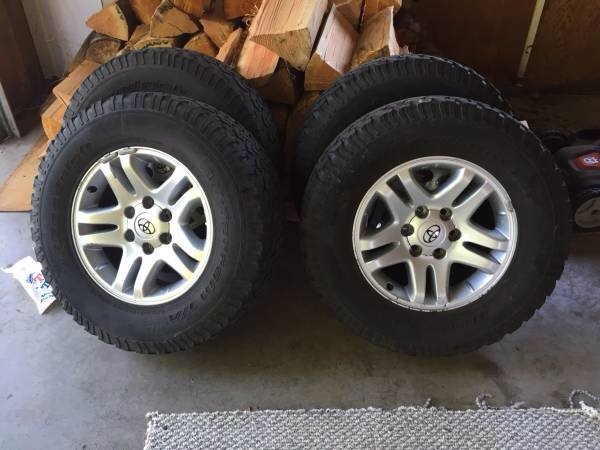

    Good news is that I just scored these for my off road adventures and I will get Michellins MS2 for my regular commute

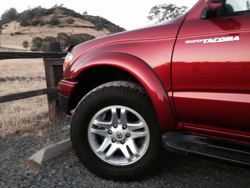

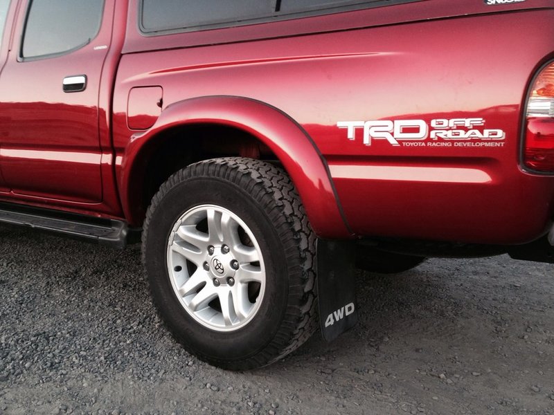

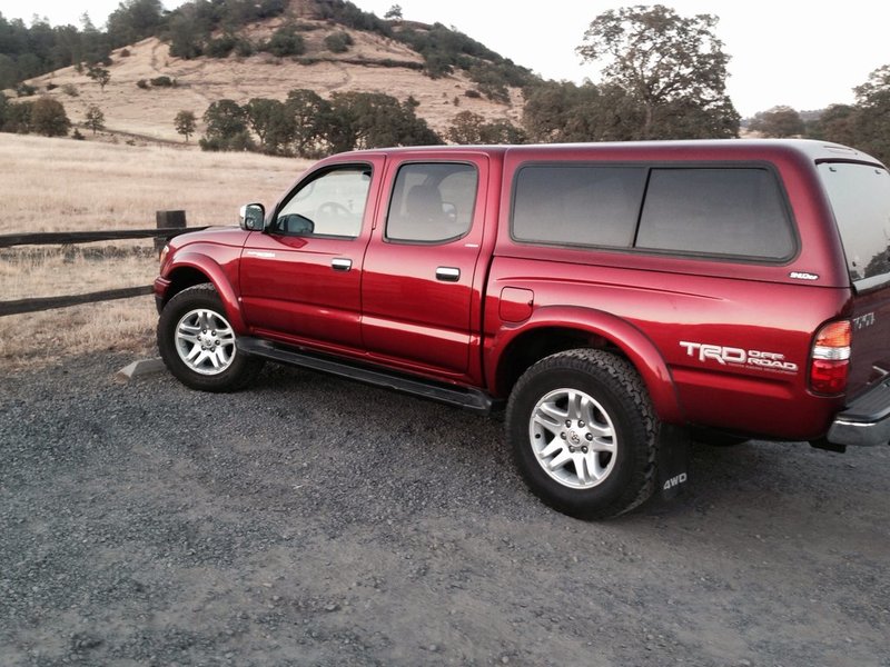

    Just got the wheels on and they look great!!!! ;)
    265/70/17 BFG All Terrain KO

    Looks personally I would remove the stepside bars
    DRFTR[OP] likes this.
  13. Jul 15, 2015 at 9:50 PM
    #33
    DRFTR
    DRFTR [OP] Well-Known Member
    May 11, 2015
    #155095
    470
    Chico, CA
    2004 Tacoma Limited 4WD Quad Cab
    I'm not a big fan of them but it gives my kids a good place to wipe their feet before they get on, we are always going swimming somewhere.

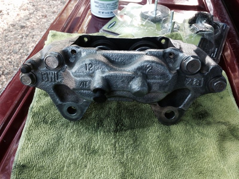

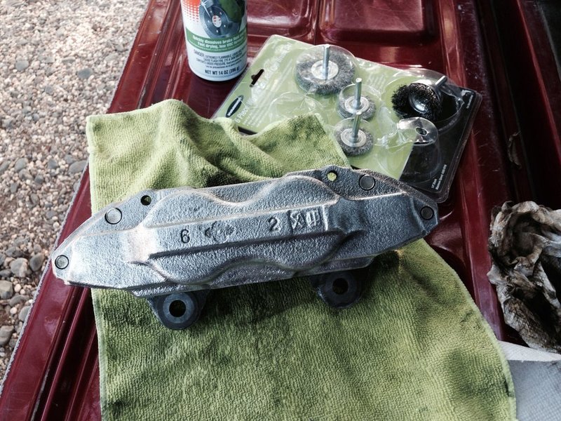

    Time for the Tundra brake upgrade, found this one in my local junk yard out of a 2003 Tundra. Too bad the other one was damaged because they were only $27 each. So I still need to locate the second one, I'm thinking eBay. Thinking about going with the Brembo plain rotors and the auto zone gold pads. Also painting them red with G2 kit.image.jpg image.jpg Any other recommendations?
