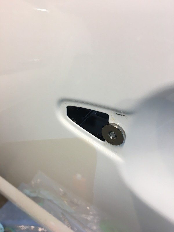

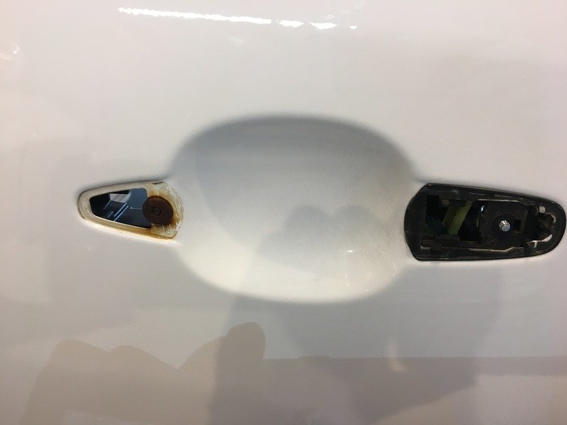

    here is what i found behind each door handle
    9F6145A6-DFD7-401C-976D-572302E0B91C_zps_1861fa66f55b03b35df5a7d9acf6dddf44935cf1.jpg

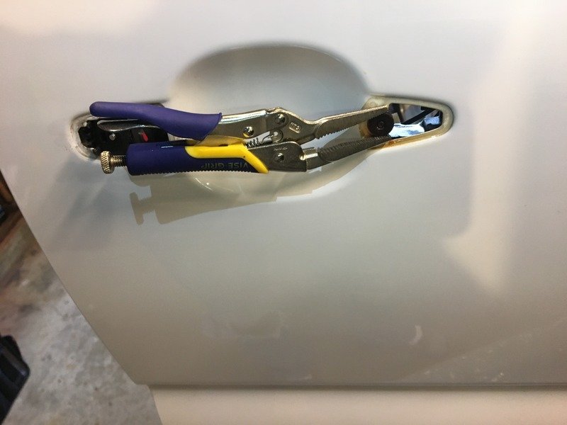

    The screw head broke off all the screws, so after the screw broke from the inside of the door. I had to carefully lock a vise grips on to the nut to pull it out.

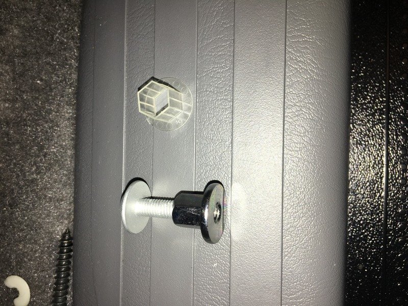

    here is the new hardware installed.
