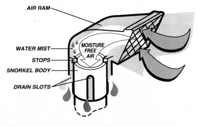

    Question, wouldn't it make more sense to flip the end around so the air intake is facing backwards, then? Or does the snorkel rely on the "scoop" principle to allow air in?

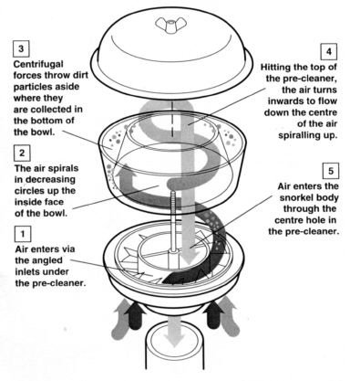

    Not necessarily. Water and dust, being heavier than air, will not be able to change direction as well as air and just hit the back of the scoop and fall out. As intended by Safari. The lighter dust particles that manage to make it down the tube will far less than your typical in fender set up. That being said, when I had a snorkel on my Jeep, I ran a quality air filter, not a "performance" filter.
    If you really want to protect yourself from dust ingestion, you want to get a pre-cleaner. It does an even better job of separating dust and water before they can enter the intake tube.

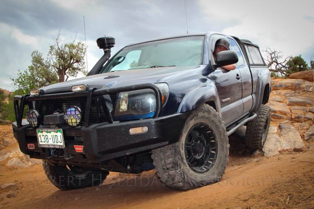

    Here is one an a Tacoma. The bowl is usually clear with the top being black. It appears that he painted his bowl black.

    Hmm. Interesting. Thanks.
    I did not realize there was a 'drain', essentially, under the scoop, I just assumed the entire unit was one piece of plastic.

    What about driving in heavy rain, like tropical storm heavy.

    Total non-issue, the snorkel head is designed to drain incoming moisture. I suppose if it was horrible enough that your filter was wetting, you could easily flip the head around as some due in wet snow. Keep in mind 7-11 gas has more water in it than you'll likely get through the intake.
