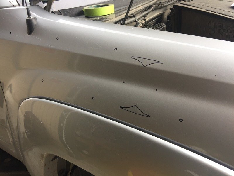

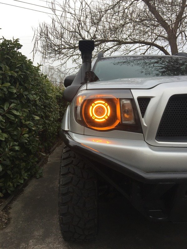

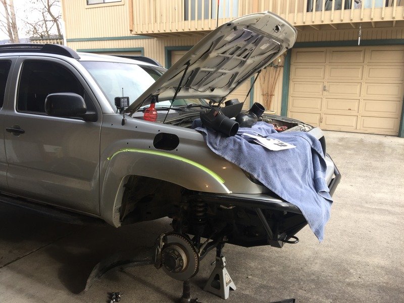

    Got mine installed this weekend. It was more of a chore than I anticipated. All the research in the internetz can only prepare you so far...
    Couple things that came up;
    The template is a guide at best it seems. I had to enlarge all the mounting holes a few mm to get all the studs to enter without binding up. They still bind, but at least I can remove it if the need arises.
    Secondly, I had to drill a new hole in my CBI ditch light brackets so my Rigid Dually would clear. This was unexpected based on what I've read. The lights bracket is slotted, but I was already to the edge of it...
    Couple pics:
    Stole the idea for this pic from @MattB77
    EsJ TX, samiam, MattB77 and 2 others like this.

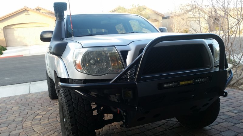

    POS
    Can anyone give a dimension for from the end of the snorkel to the headlight?
  15. Feb 4, 2017 at 2:03 PM
    #555
    Uncle Cliffy
    Uncle Cliffy Never tell me the odds.
    Jun 3, 2011
    #57709
    419
    Clifford
    So. Oregon
    06 DCSB 4x4
    https://www.tacomaworld.com/threads/uncle-cliffys-build.327590/
    Measuring from the forward most part of the snorkel, to the upper corner of the headlight is 12 3/4 inches for me.

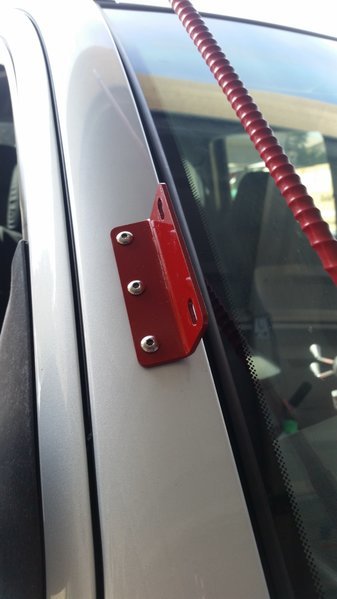

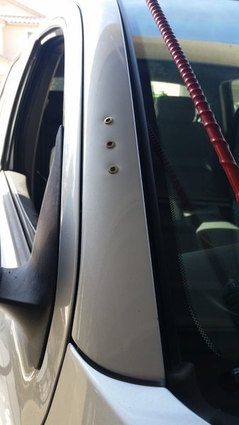

    Got mine installed today. I used rivnuts in the A-pillar and it worked great.
