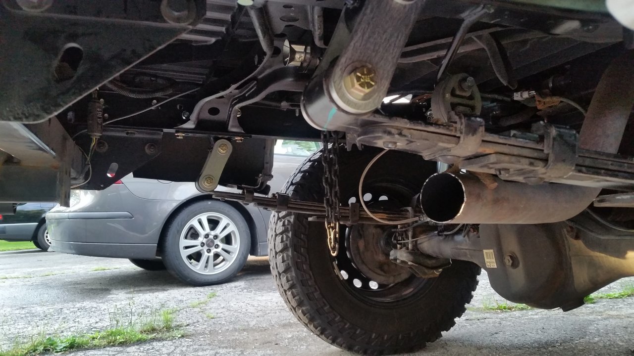

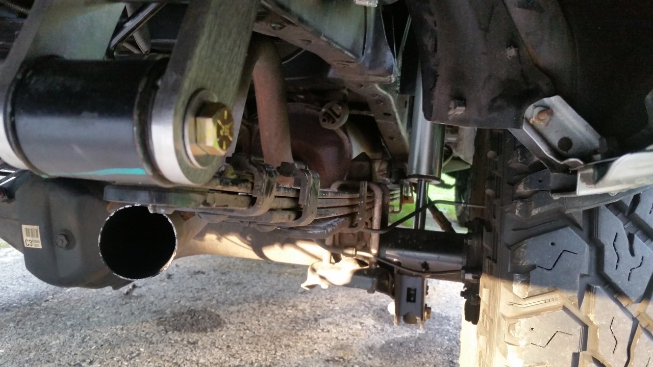

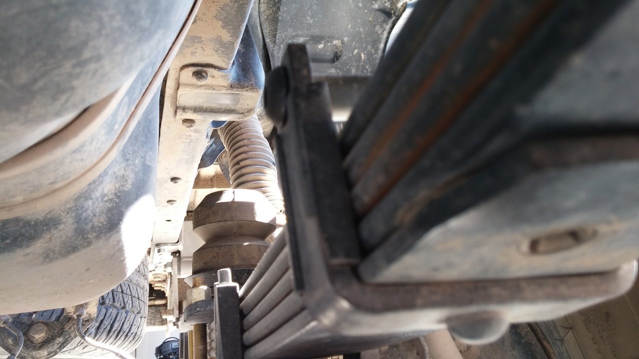

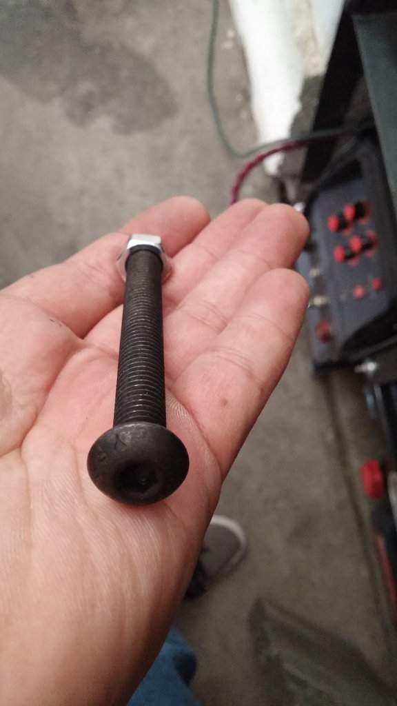

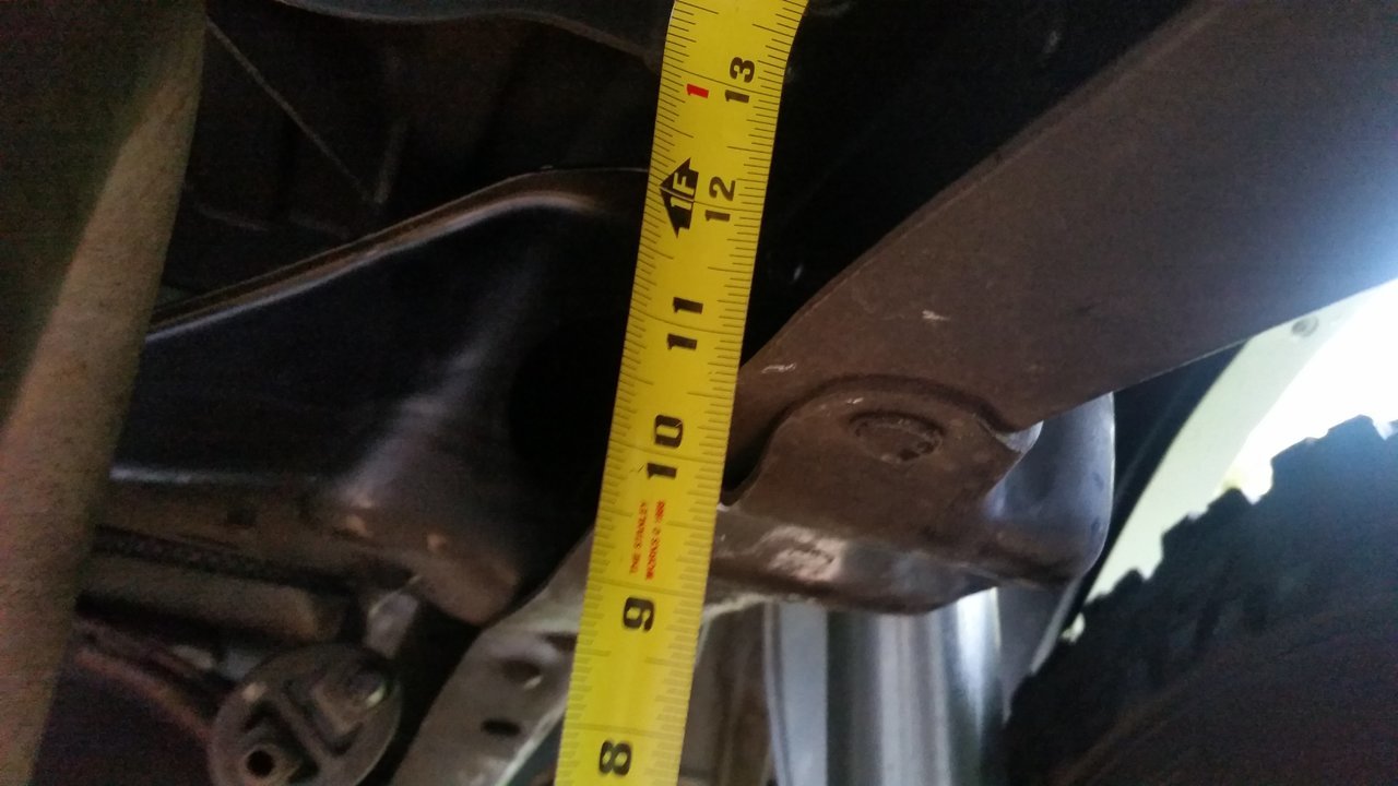

    3/8"-16 thread x 3.5" long button head with c-nut. Nice and low profile with no edges to catch. Now I need to find some thin aluminum to stick on the gas tank..

    Nice job, and the tank plate is a good idea, should be able to RTV a thin piece of alum or stainless right on the plactic tank

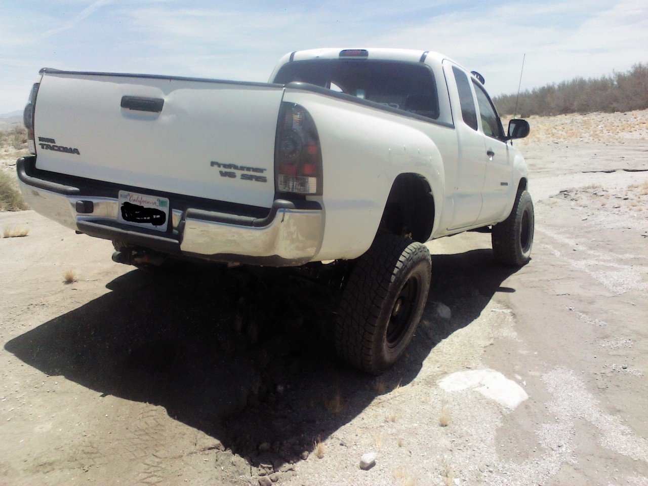

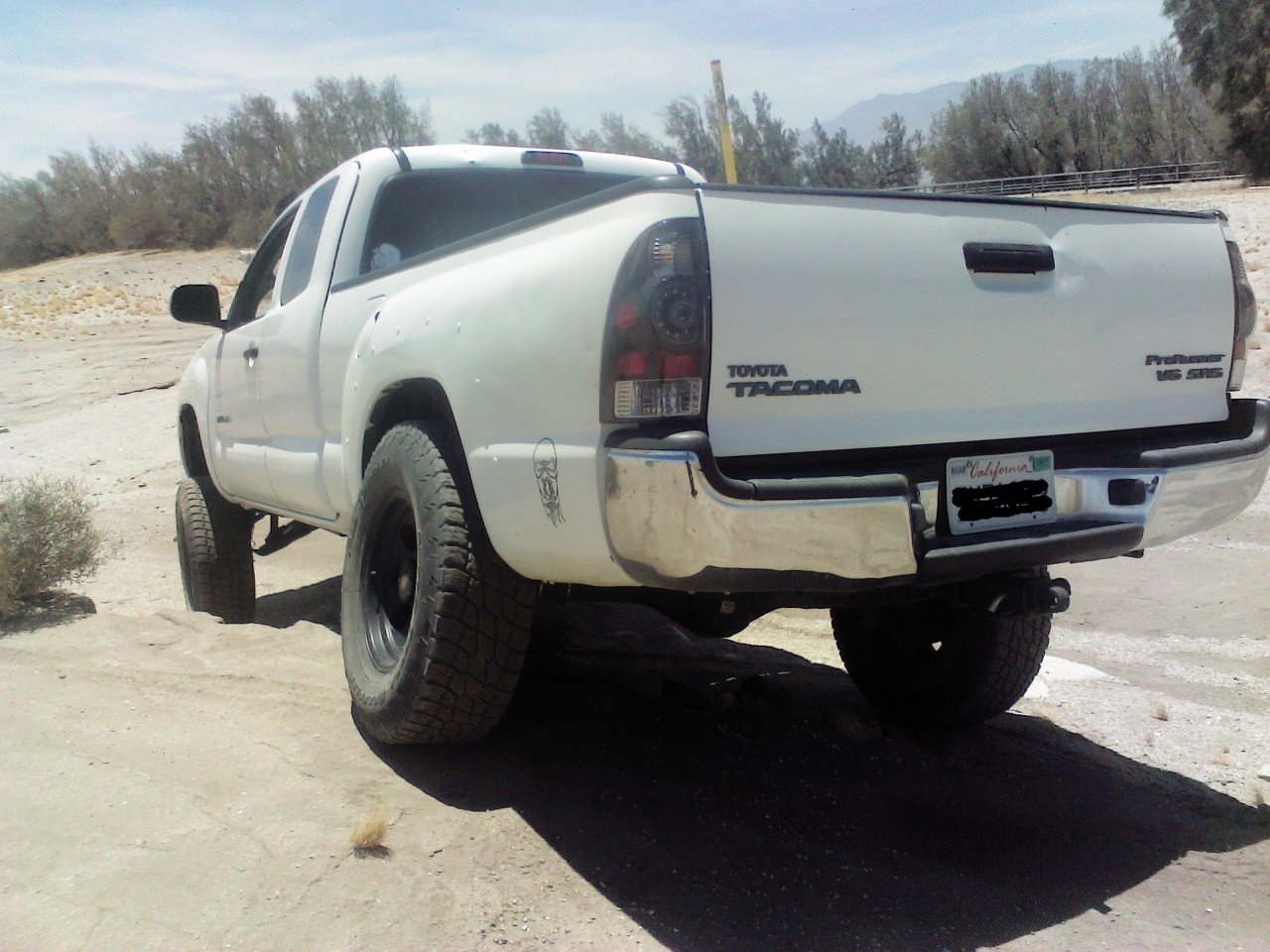

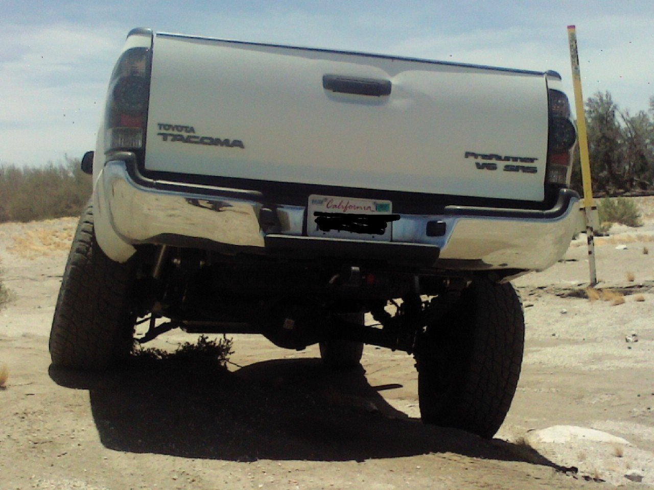

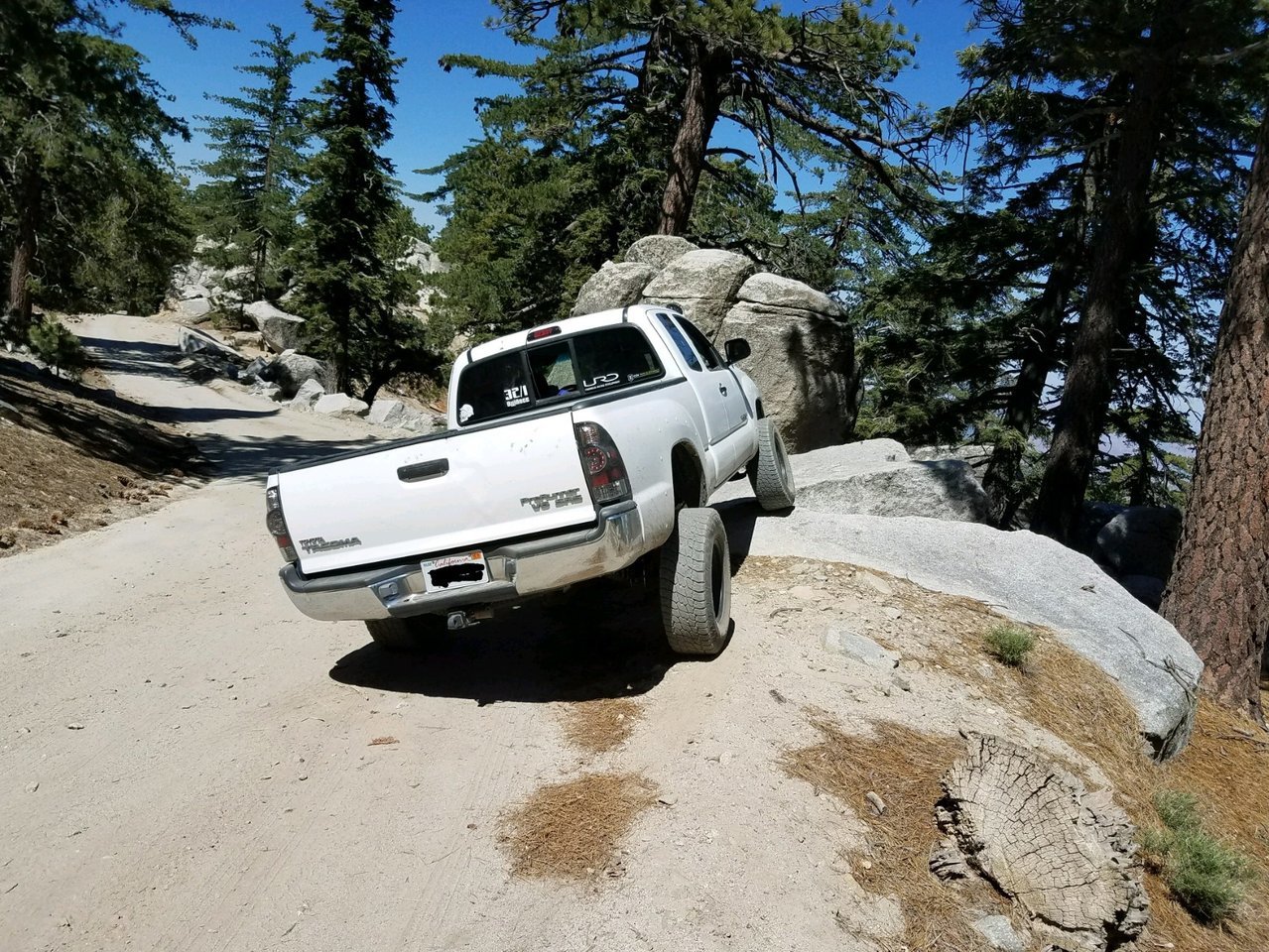

    I'm running the shackle flip on Stock TSB springs w/ Icon ext shocks, definitely no complaints and am happy with the ride. It actually worked out good (for now, i want to replace springs and longer shocks for more flex) because the springs max out just before the shocks do.

    Just got back from 5 days in Ouray and Moab. As far as i could see, i did not hit the gas tank with the new low profile bolt in the Dakars.
    We did damn near every trail/pass in Ouray minus the switchbacks on Black Bear Pass which was closed for snow. Only spent a night and morning in Moab and hit up Hell's Revenge. Most of the trail was done with little effort in 4 low, until we neared the end. Then we got a nice slap in the face. A wrong line on one of the descending features nearly cost my buddy his truck and another buddy's rear bumpers/bedside. Thankfully i went last and we figured out the line and i came down with no issue. It was at that moment, I realized I am more of a fast paced Baja guy. There's nothing like letting the supercharger do its thing in 4WD and crushing desert access roads at 70mph.
    Either way, shackle flip did its job and i never had a tire leave the ground (besides air time) in over 100 miles of dirt/rock.
