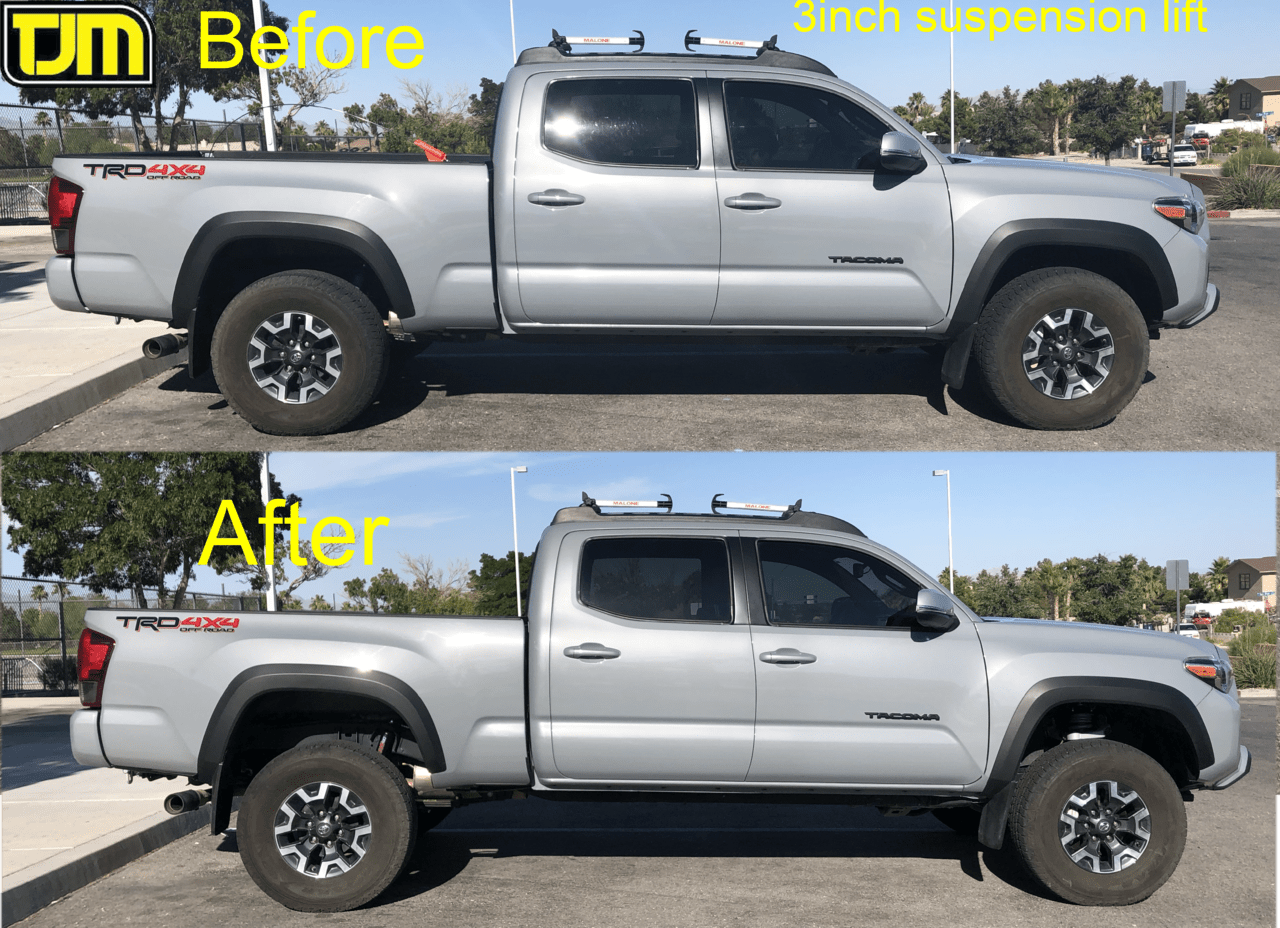

    TJM 3 inch suspension lift for 2005 - 2019 Toyota Tacoma’s. Ride so far is a bit stiffer than stock suspension. Upper control arms correct any unwanted stress on the mechanical components. Running stock wheels and stock all-terrain tires for now. Will post pictures when I upgraded to 33’s. Overall, feels very comfortable and handles nicely.

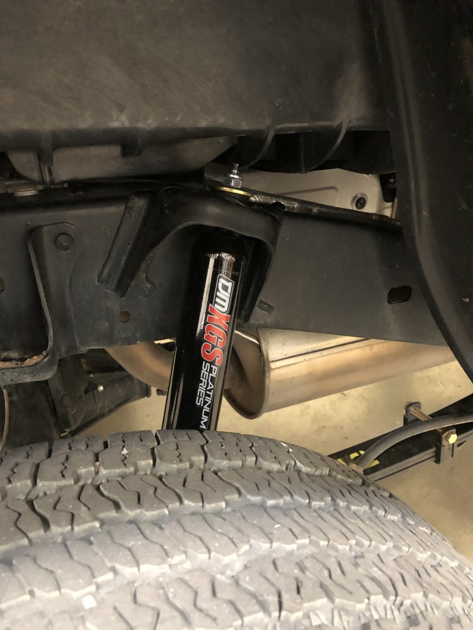

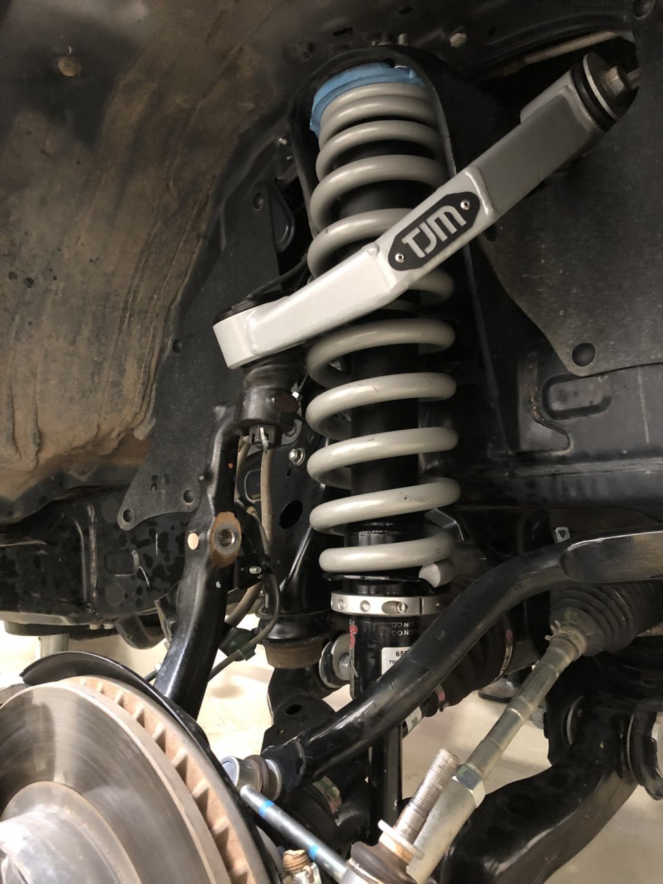

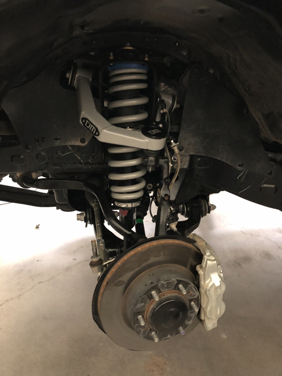

    ROGUE OFFROAD
    ROGUE OFFROAD Well-Known Member Vendor
    May 2, 2016
    #185963
    177
    Shawn
    Here are some pics from the install. Thanks for posting your feedback on the kit here. Appreciate the business .

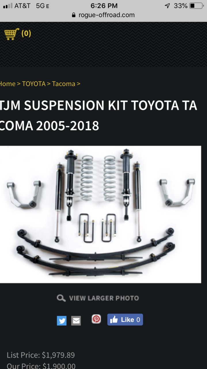

    TJM 3inch suspension lift with TJM uppercontrol arms
    4x4erik- my struts came fully assembled, they are adjustable so you will have to adjust them to your preferred level. I believe they range from stock - 3inches in the front, rear is a complete replacement of your stock leaf springs(no block) it will lift around 2 inches. You will also get new UCA, that are fabricated and rear shocks. I’m running 285/75/16’s or 33’s but in order to fit them you’ll have to get a body chop. BTW Rogue off-road did mine and they definitely know what they’re doing, they’ll take care of you no matter what lift you get. Shawns run nearly every lift he sell. If you want I can meet you in Vegas somewhere so you can check out the lift. I’m in the NW part of town.

    You really can’t go wrong with this kit, or the OME and Bilstein, all three work very similar. I really liked that this TJM kit came with fabricated UCA and a new full leaf pack that seems to hold up on heavy weight so far. Also comes with mono tube front adjustable struts with new coils, and rear mono tube shocks. So far I really can’t complain.
