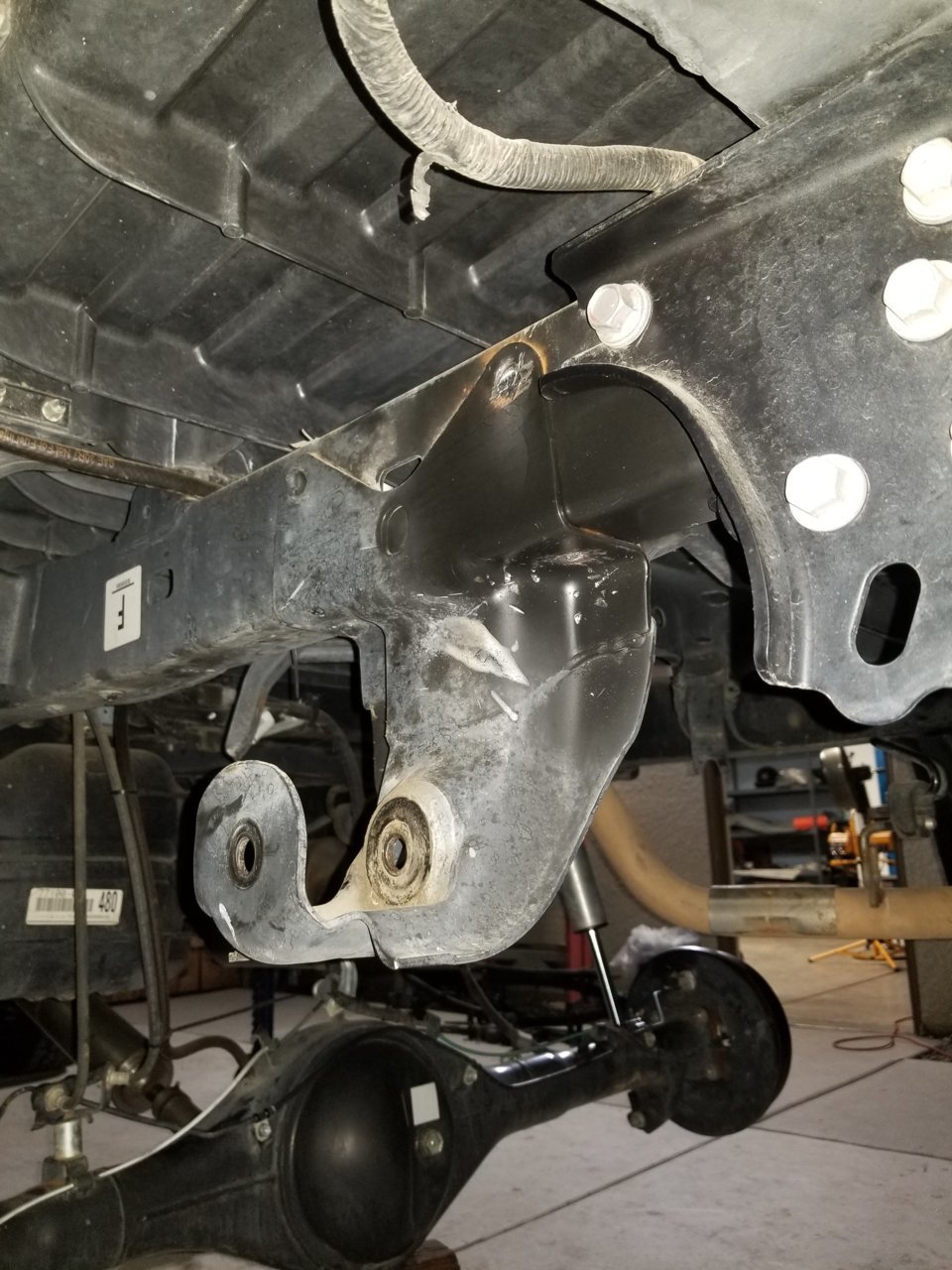

  7. Sep 12, 2018 at 11:53 AM
    #1207
    Weirich
    Weirich Drunk_taco
    Jan 10, 2017
    #207196
    259
    Travis
    2016 Tacoma access cab TRD Offroad
    OvTuned 4.88 R&P Hypertech speedometer calibrator Rough country 6" lift Toyo open country 285/75R17(old) Cooper STT Pro 315/70r17 Archive garage shackle flip Tough country uni ball uppers Icon 2.5 6" front coil overs Icon 2.5 CDC 6" rear shocks OME cs047r rear leaf packs AllPro HD Sliders Tom woods double cardin single piece drive shaft Magnaflow exhaust Black rock D window rims(old) ICON 17x8.5 Rebound CBI T3 full guard front bumper Smittybilt x20 10k winch HEISS 20" single row light bar ARB on board air compressor

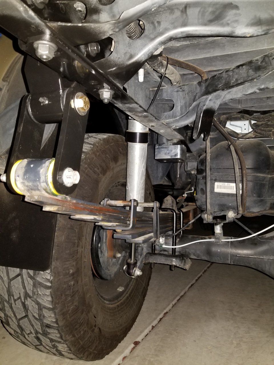

    Air hammers with a chisel tip make life much easier. Just gotta cut the head off one side, then hit the back side of the stud, alternating from one side to the other to loosen it up, then hit it with the center punch tip and it comes right out.
    Amazing quality on the hangars too, really impressed with how well these are put together @ARCHIVE. Pretty straight forward install. I'll have more info on how everything works after I get my new OME bushings.
    ARCHIVE[OP] and Maggot61 like this.
  8. Sep 12, 2018 at 1:03 PM
    #1208
    Weirich
    Weirich Drunk_taco
    Jan 10, 2017
    #207196
    259
    Travis

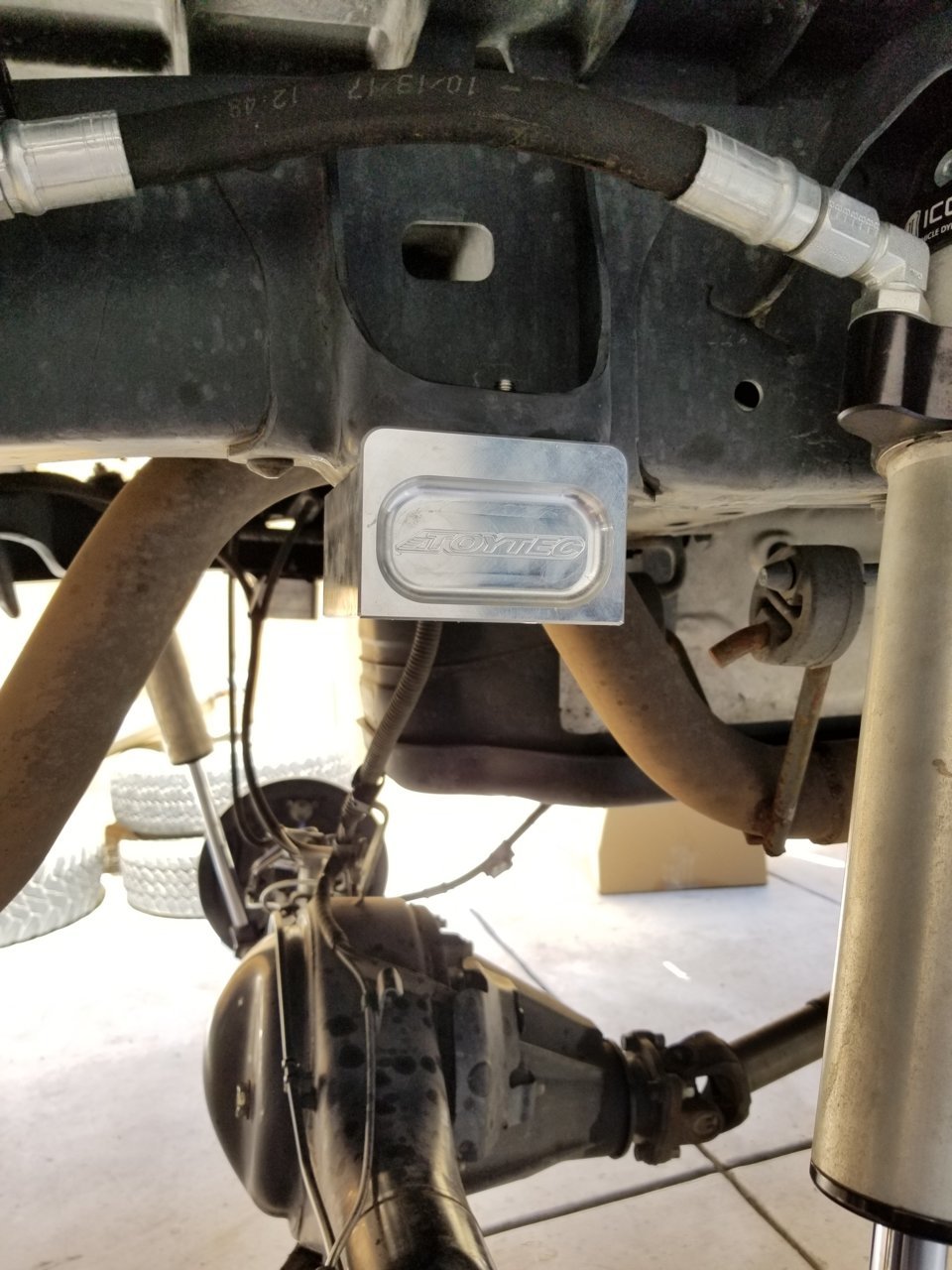

    Anyone else run these bump stop spacers from toytech?
    10tacotrooper likes this.
  9. Sep 13, 2018 at 3:15 AM
    #1209
    Weirich
    Weirich Drunk_taco
    Jan 10, 2017
    #207196
    259
    Travis

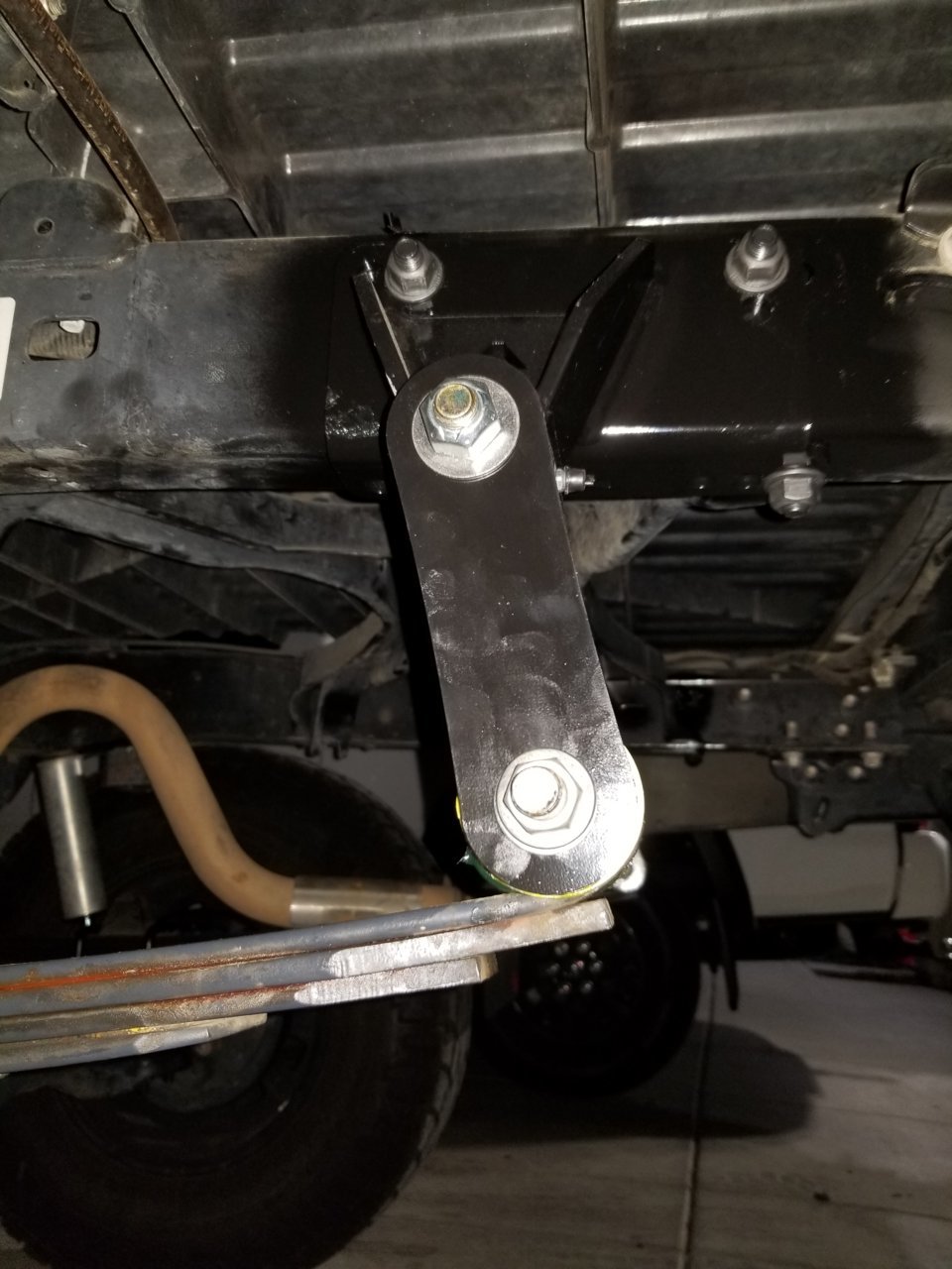

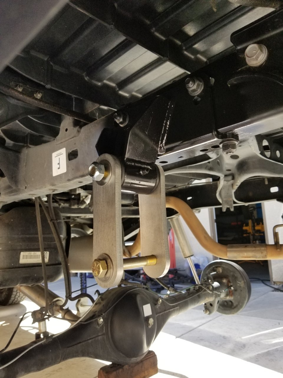

    Finally finished the install. Already feeling better about the ride quality in the back. Got thing to mention is the bolts that came with this kit dont fit the bushing sleeves that came with the OME bushing kit I bought.
    Also @ARCHIVE, the angle on the rear shackle is only 15 degrees in the most forward postition. Did I miss something?
    ARCHIVE[OP] likes this.
  10. Sep 13, 2018 at 5:21 AM
    #1210
    ARCHIVE
    ARCHIVE [OP] Well-Known Member Vendor
    Oct 29, 2015
    #168099
    2,254
    Eric
    Orchard Park, NY (Buffalo)
    '05 Taco, '22 Tundra, '91 Cummins
    2.5" Fox relocation * Hammer hanger * Archive MD springs
    You went with 4.75" shackles, the angles in the chart on my site and instructions are with 4" shackles. On the chart it says 4.75" shackles will be about 10deg more vertical than 4", so 15deg is what Dakars and foremost position with 4.75" yields.
    Yes the 9/16" bolts I supply dont fit in Dakar bushing sleeves, only spring like this. Toyota spring bushings are .580" ID, and OME must make theirs .550". I have not found an M14 bolt the proper length I can supply.
    Weirich[QUOTED] likes this.
