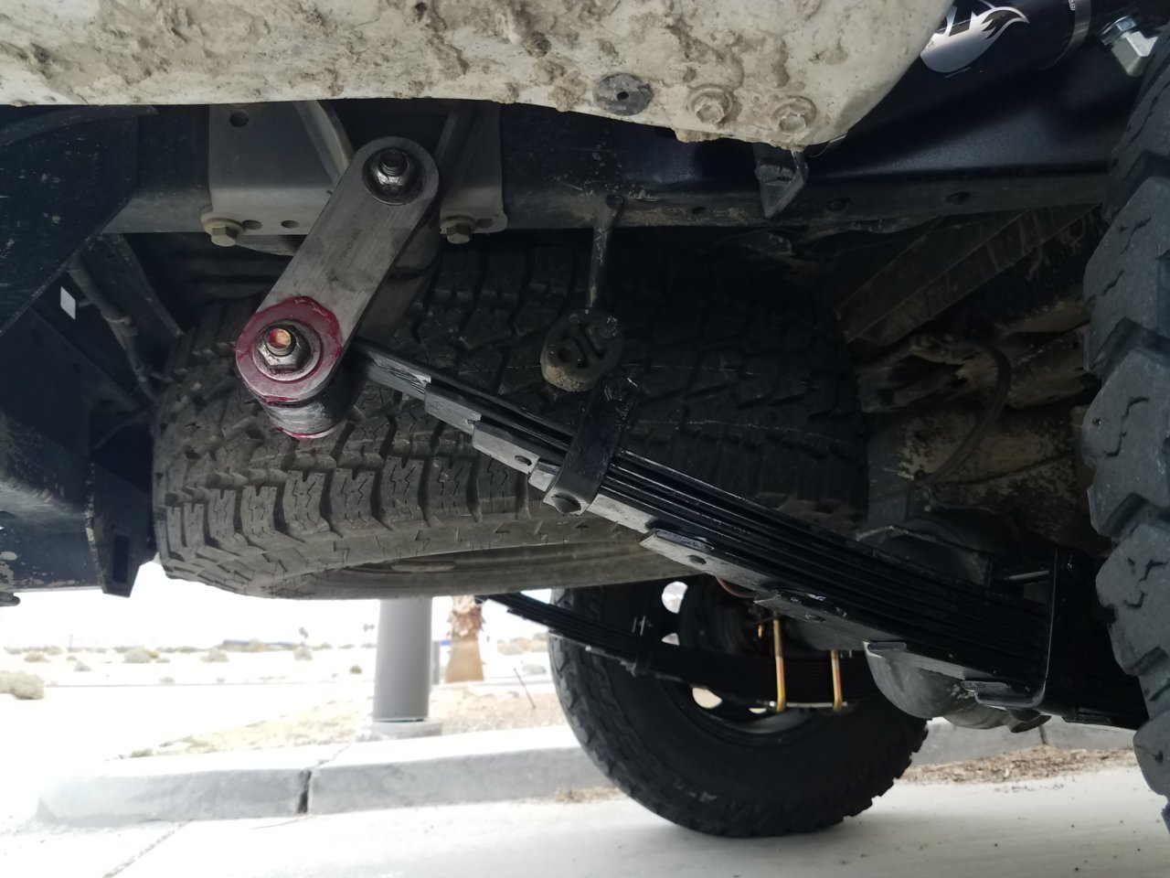

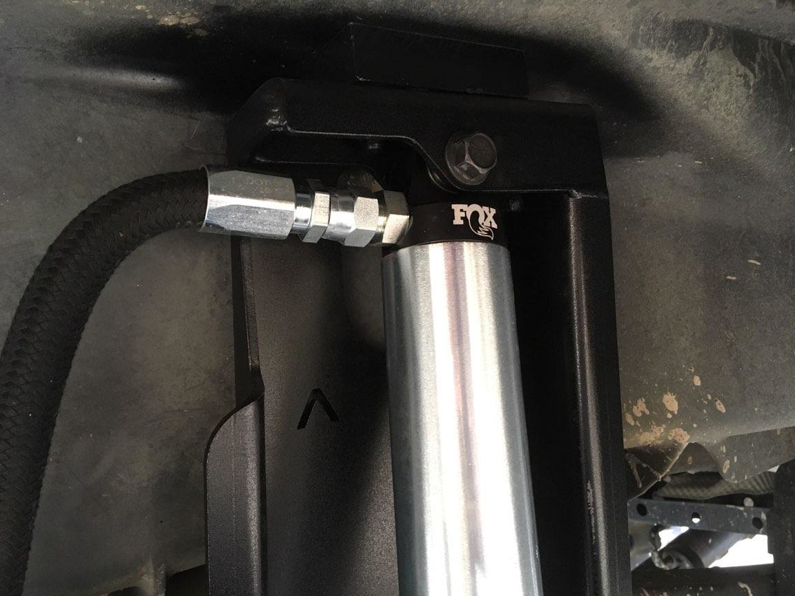

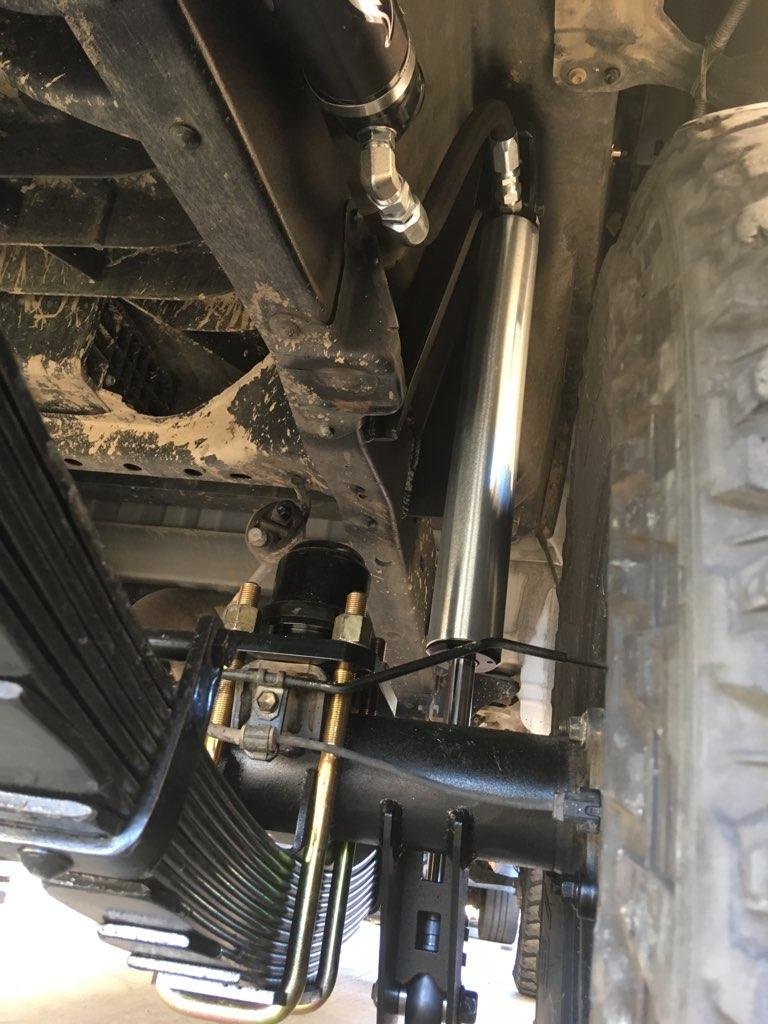

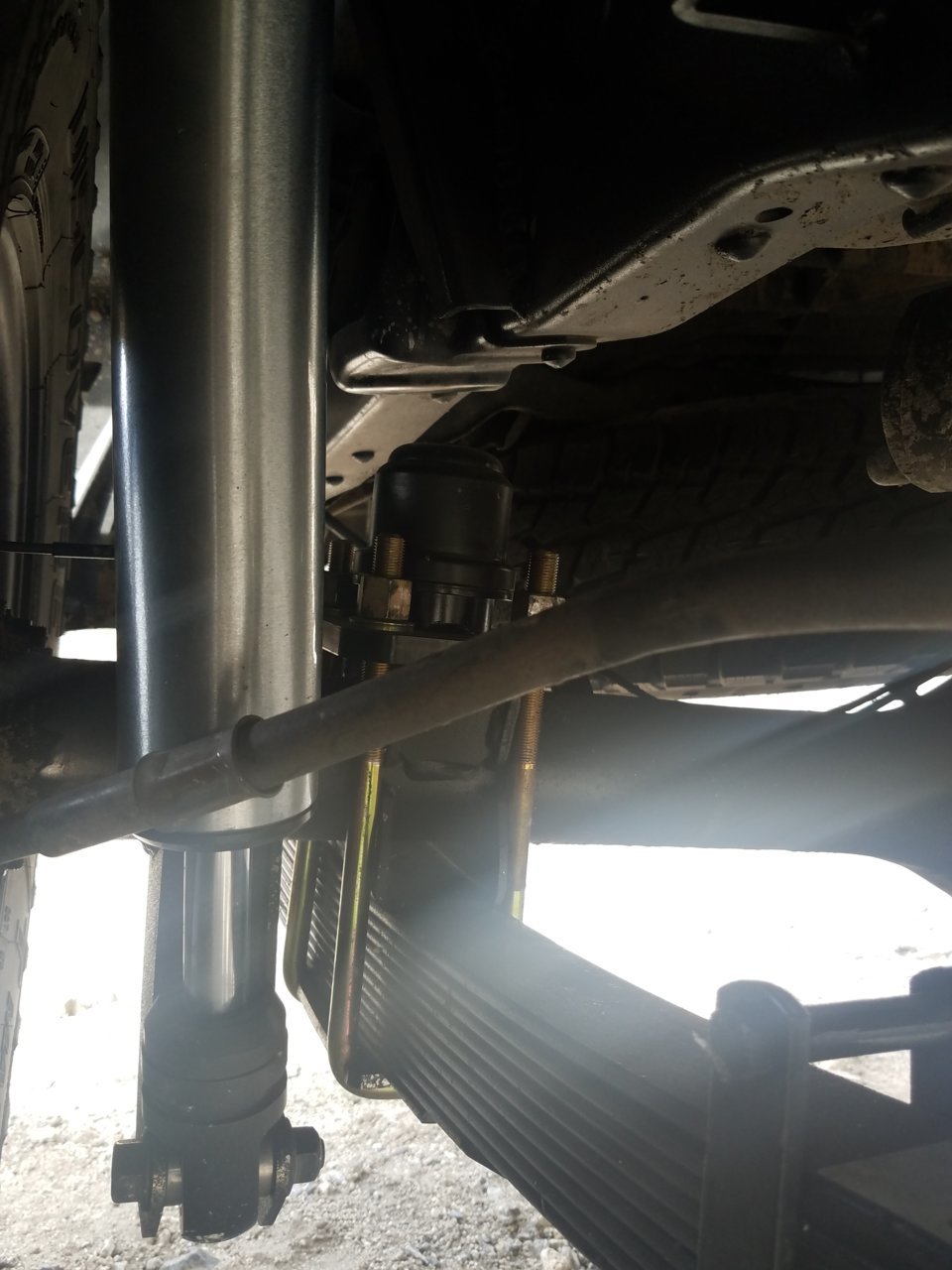

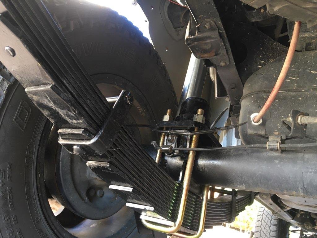

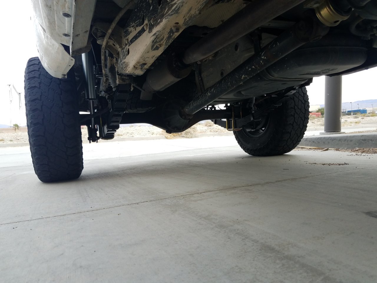

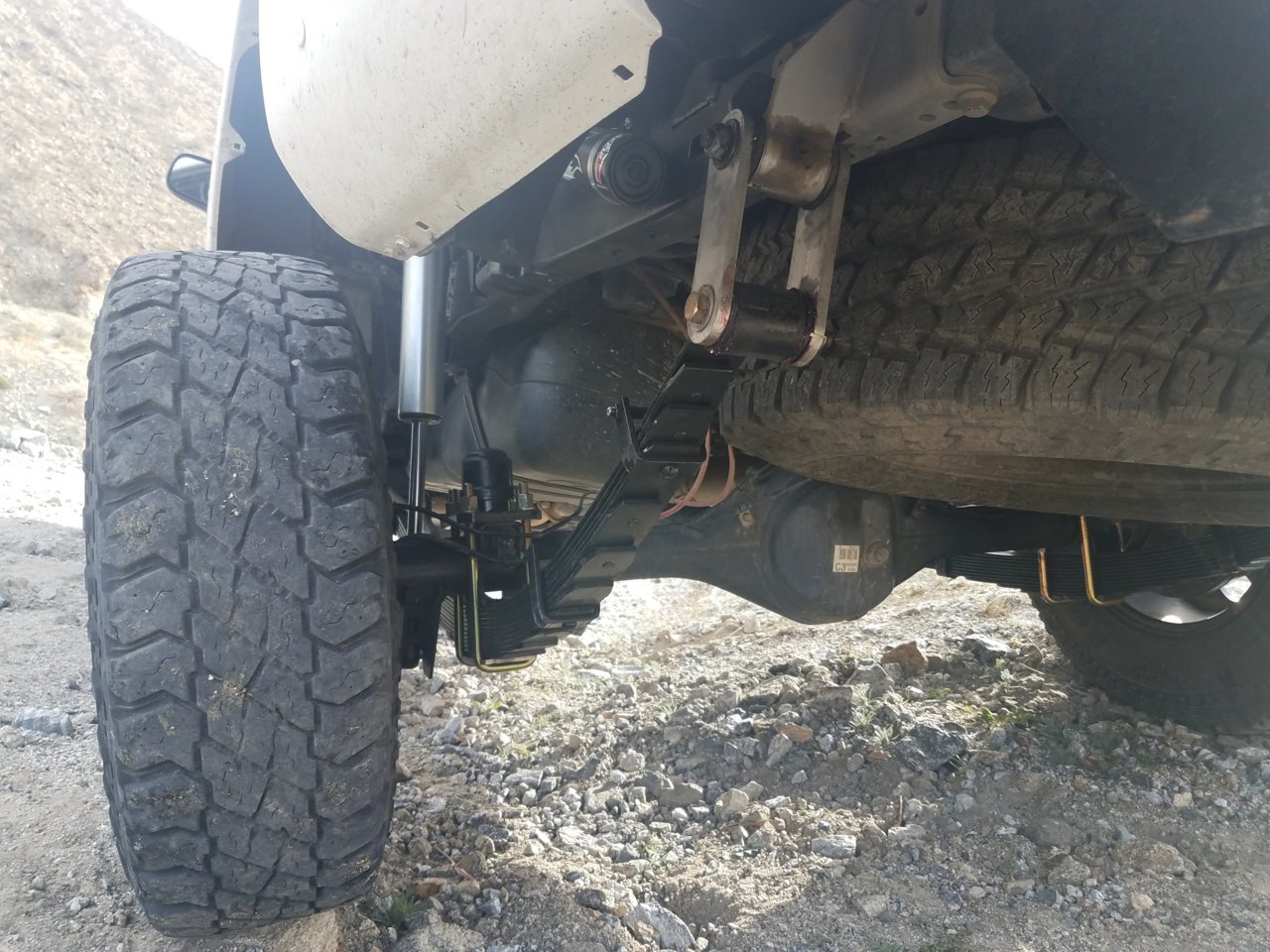

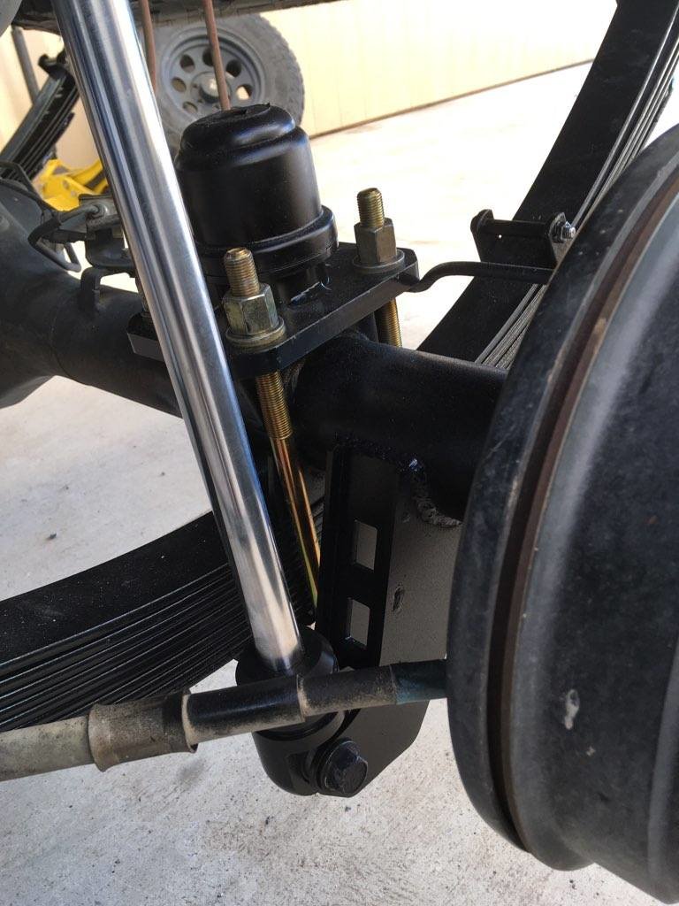

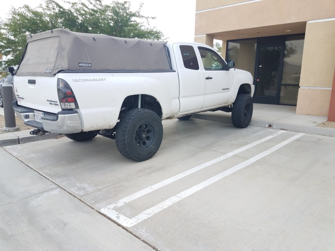

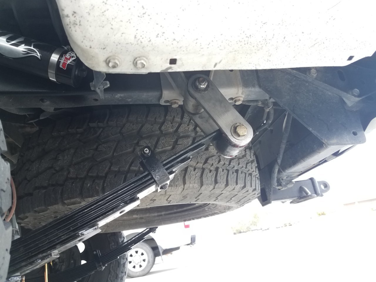

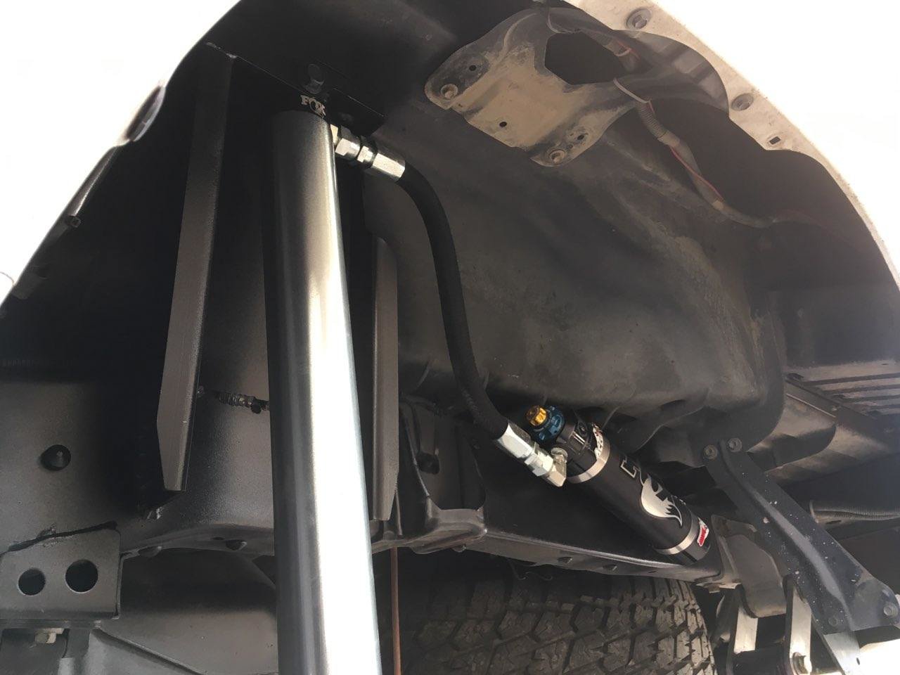

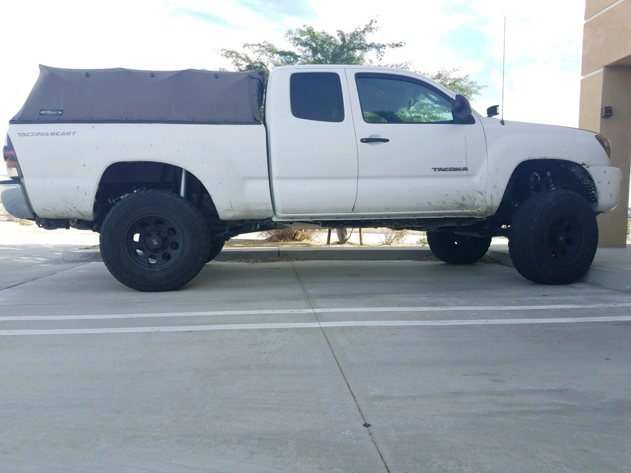

    I've had the Archive shackle flip w/ 4" shackles for more than a year now on stock springs and have been happy with ride but needed to upgrade the rear to keep up with my front set up. Decided to go with the full Archive set up and Finally got the Archive SUA and Shock relocation with Fox 14" shocks installed and the Shackle flip w/ 4.75 shackles. Haven't had a chance to hit any dirt yet but stoked with the street ride so far. Thanks for all your help Eric @ARCHIVE and for answering all my questions. Your product is top notch man!
    Don't mind the white splatter on the under carriage, it's from a paint can some douche left on a dirt road near my house.

    Thank you Jose! The truck and install looks really clean. The shackle angle looks very good and is a confirmation of the info in post #1282 about the new longer springs:
    https://www.tacomaworld.com/threads...le-flip-lift-kit.403630/page-65#post-18918458
    For readers, this is the U644/645 (light duty) which are a good fit for the Access Cabs
    Maggot61[QUOTED] likes this.

    Yooooooooo looks really really good!!!!
    Can’t wait to see some flex pics!
    Just to clarify, it seems the SUA Is most ideal for bump travel and higher speed wheeling, right? Not necessarily better for slower speed crawling type wheeling?
    ARCHIVE[OP] and Maggot61[QUOTED] like this.

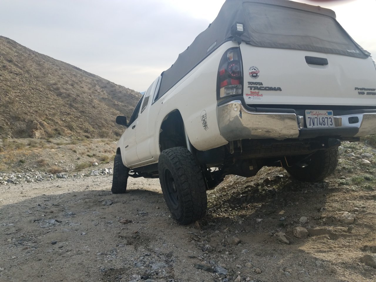

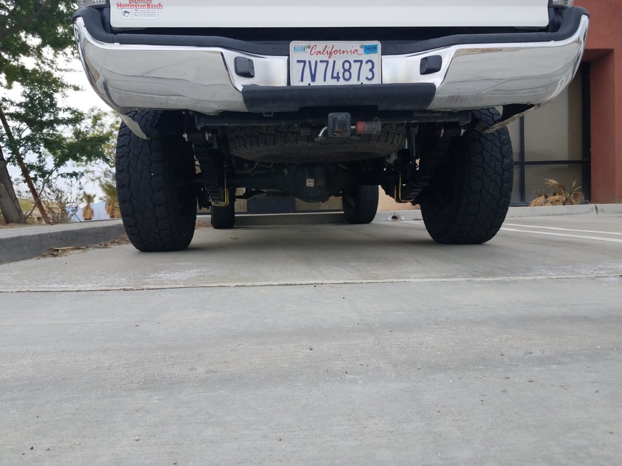

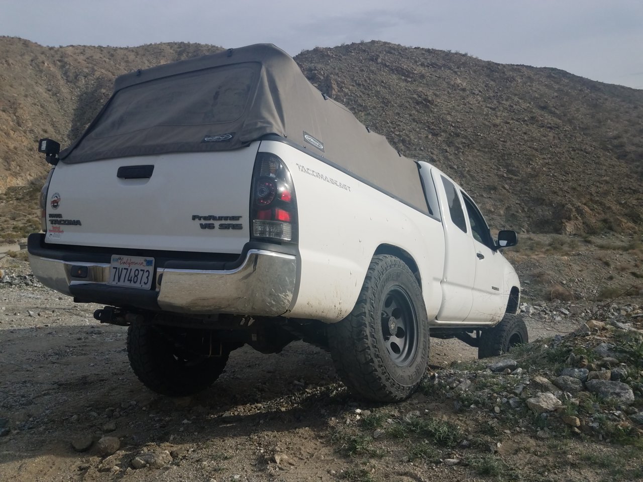

    Heres some flex...theres still a bit more drop left on driver side and room for more tuck on passengers side.

    She looks good, She looks real good! No where near full stuff it looks like! Also, that’s some impressive front droop travel in the pics!

    Just curious, but on a setup like this one what would be the pro/con of doing the shackle flip like this or doing the hammer hangers? If spring and shock remained the same. I'm looking to do a similar setup, SUA with the U644/645 and a 12-14" shock.
  20. Jan 7, 2019 at 8:29 AM
    #1240
    ARCHIVE
    ARCHIVE [OP] Well-Known Member Vendor
    Oct 29, 2015
    #168099
    2,254
    Eric
    Orchard Park, NY (Buffalo)
    '05 Taco, '22 Tundra, '91 Cummins
    2.5" Fox relocation * Hammer hanger * Archive MD springs
    You definitely want the U644/645 for Access cab. Shackle flip will likely make a more compliant ride due to changing the installed rate of springs, and you get a bit more lift.
    But for ultimate weight capacity, the Hammer hangers will not diminish spring capacity like shackle flip
