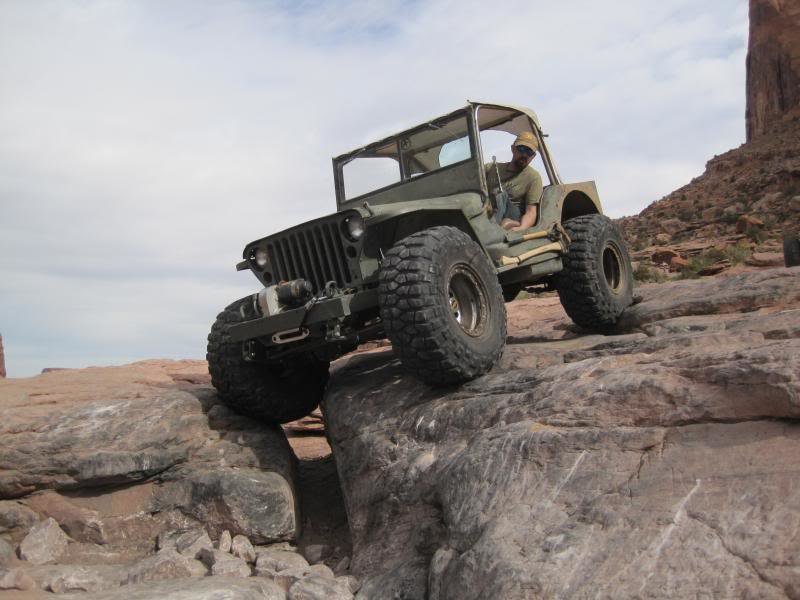

    The only ones I know of so far in the dirty dozen are me and these two others from pirate:

    Apparently they like bfg krawlers

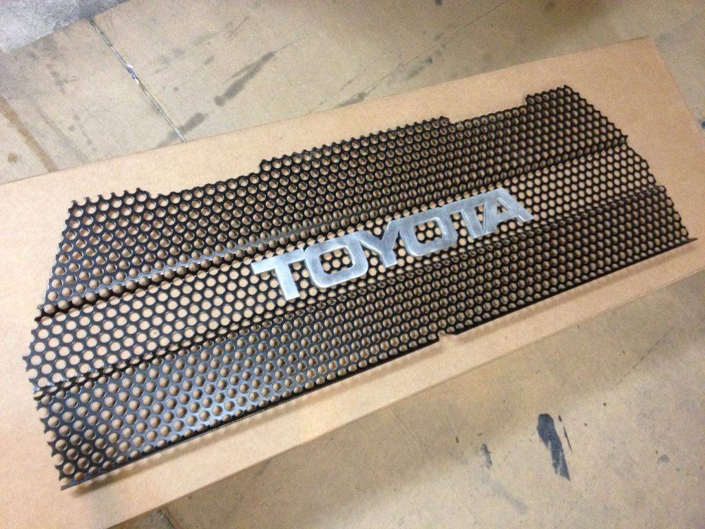

    Also, what do you think about something along these lines:

    That looks sick!

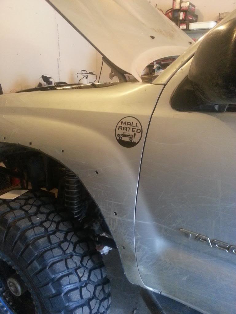

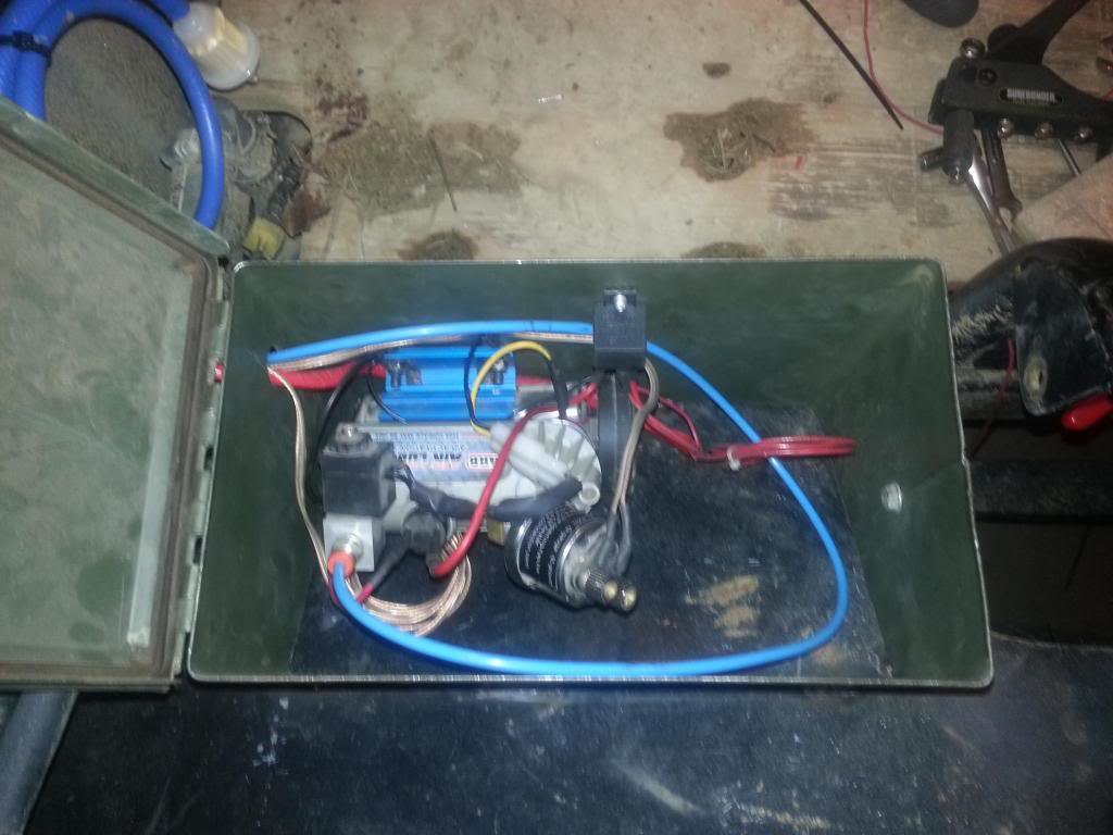

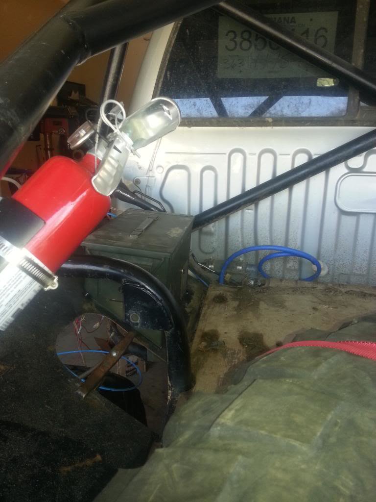

    Well did a little bit of work this weekend, not much. Since removing the toolbox and compressed air system last week, I have been planning out my new ARB compressor install. Here's what I came up with:
    The boatside "fenders" on the bed are nice, but kill a lot of storage room. So I decided to cut the can off at the same angle and mount it to the bedside. Wired up the ARB compressor, even added one of the sending units for the digital pressure gauge in my gauge pod on the a-pillar. Still have room in the can for my deflator, inflator, blowgun, spare ARB switch, spare ARB solenoid, and spare axle bulkhead fitting. Boom. Check that guy off the to-do list.
    Sucks only using one of the two readouts of the gauge now, but still better than nothing. I had the dual readout for tank and regulated (locker) pressure before. Since the CO2 tank has a fixed regulator, it would be silly to have the other readout a constant 150psi, but may do it anyway for the hell of it.
    Also more stickerz :D
