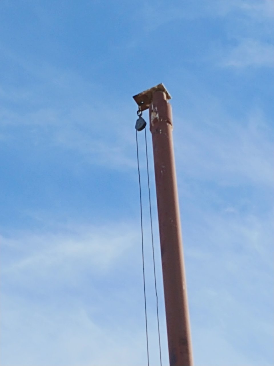

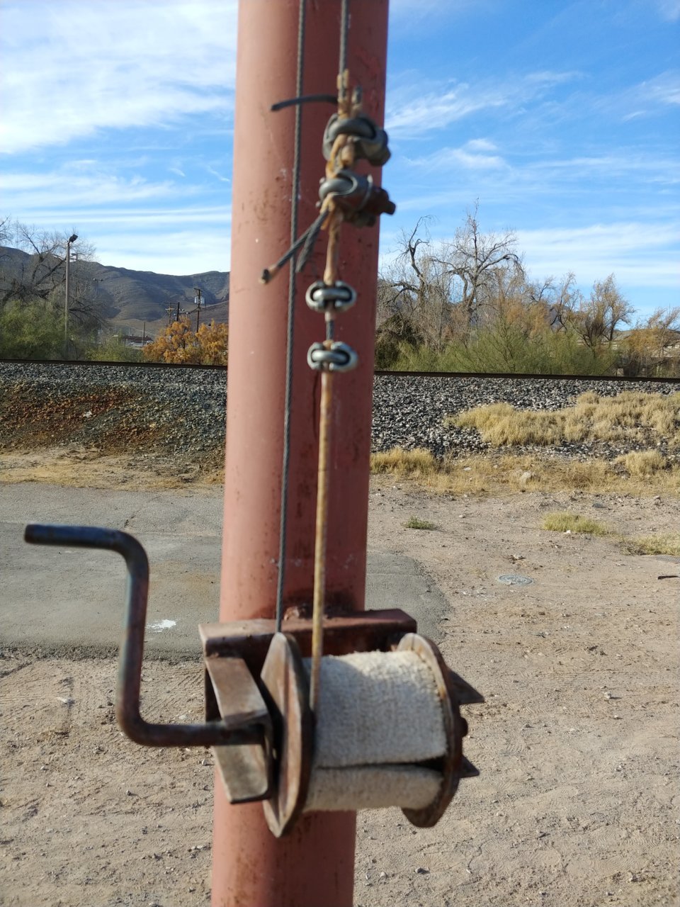

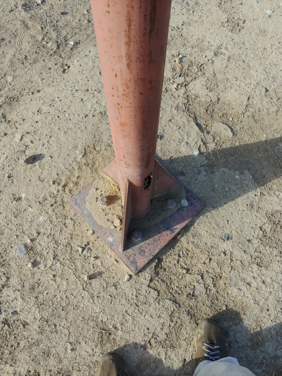

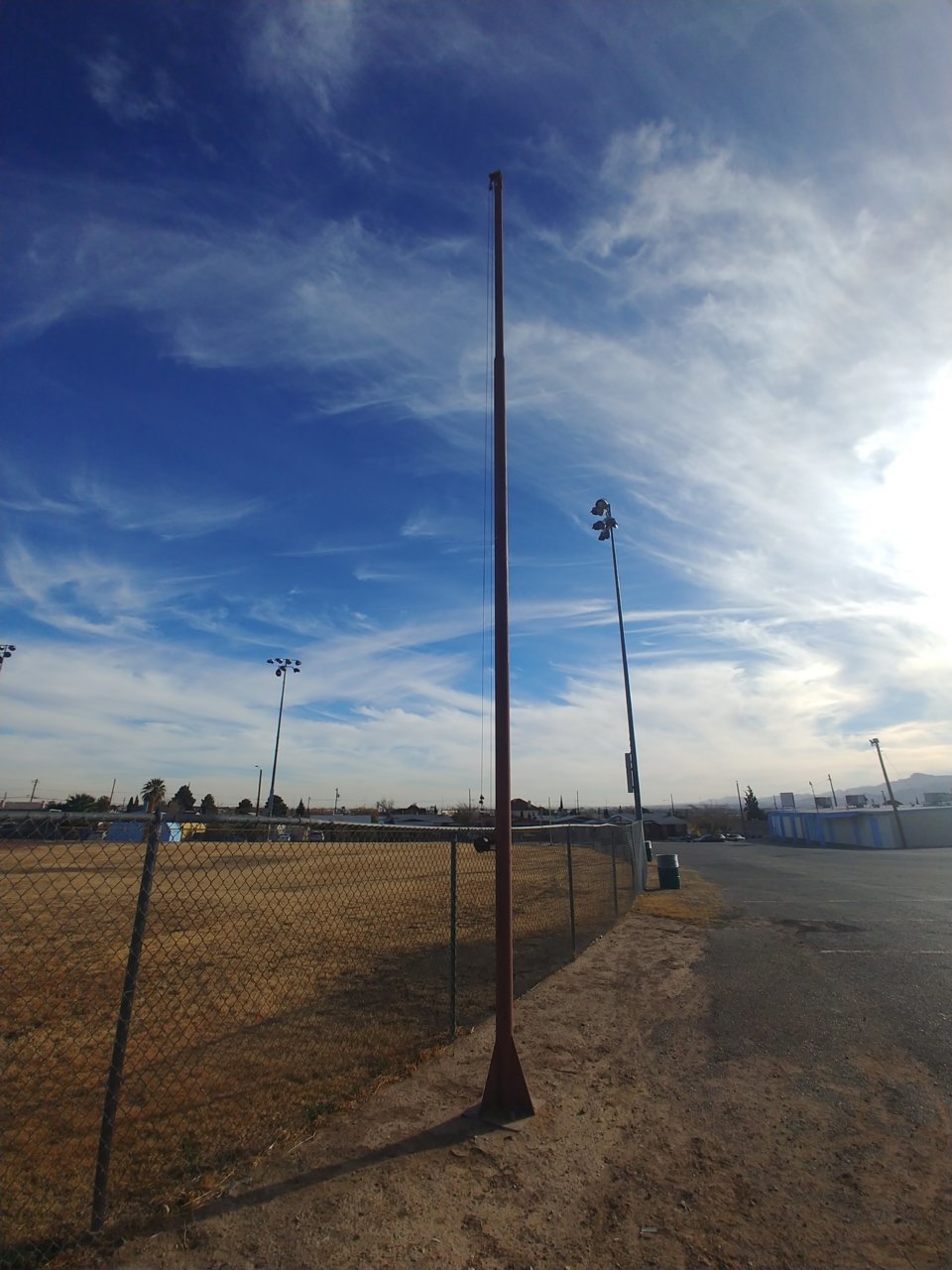

    Walking the dog a few days ago, found my next project. I have a few changes and modifications in mind for the design though.

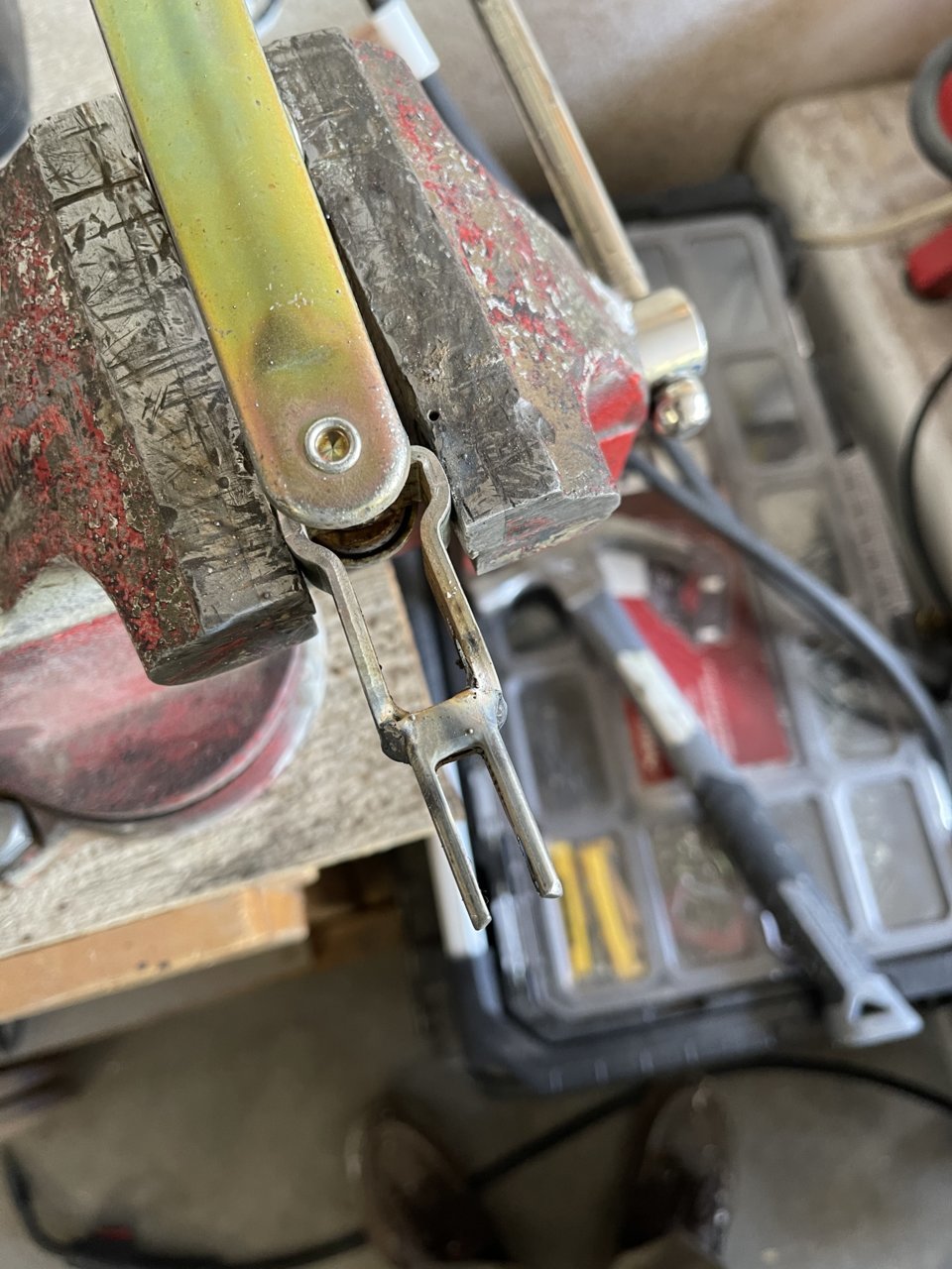

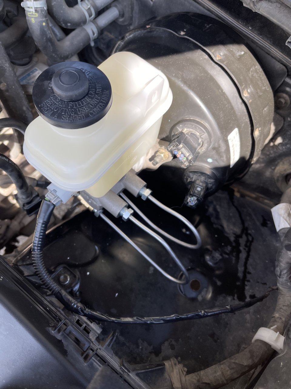

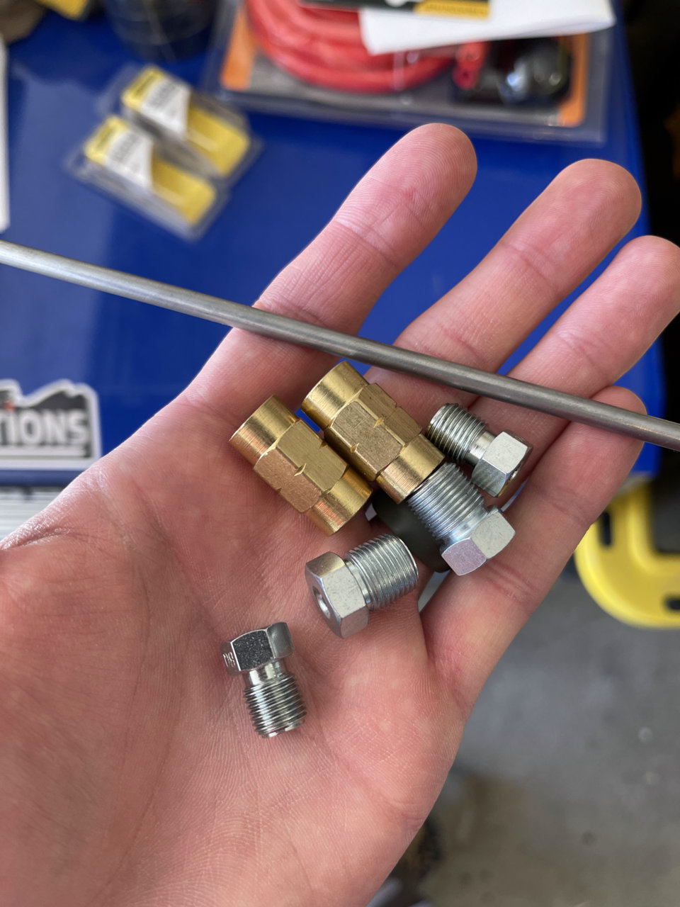

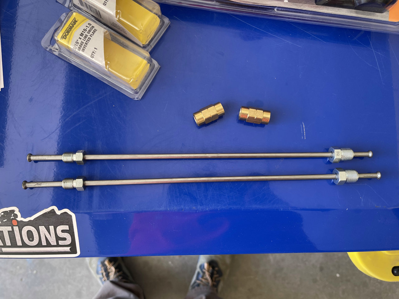

    Master cylinder started leaking into my brake booster. I ordered a Tundra booster from LKQ and a new master from RockAuto. I picked up the miscellaneous bits from a local shop and made some hard patch lines to convert from the Tacoma M10x1 inverted to the Tundra M12x1 inverted.
    The M10x1 and M12x1 inverted fittings were a bit difficult to find locally. I didn't really feel like ordering them offline if I didn't have to.

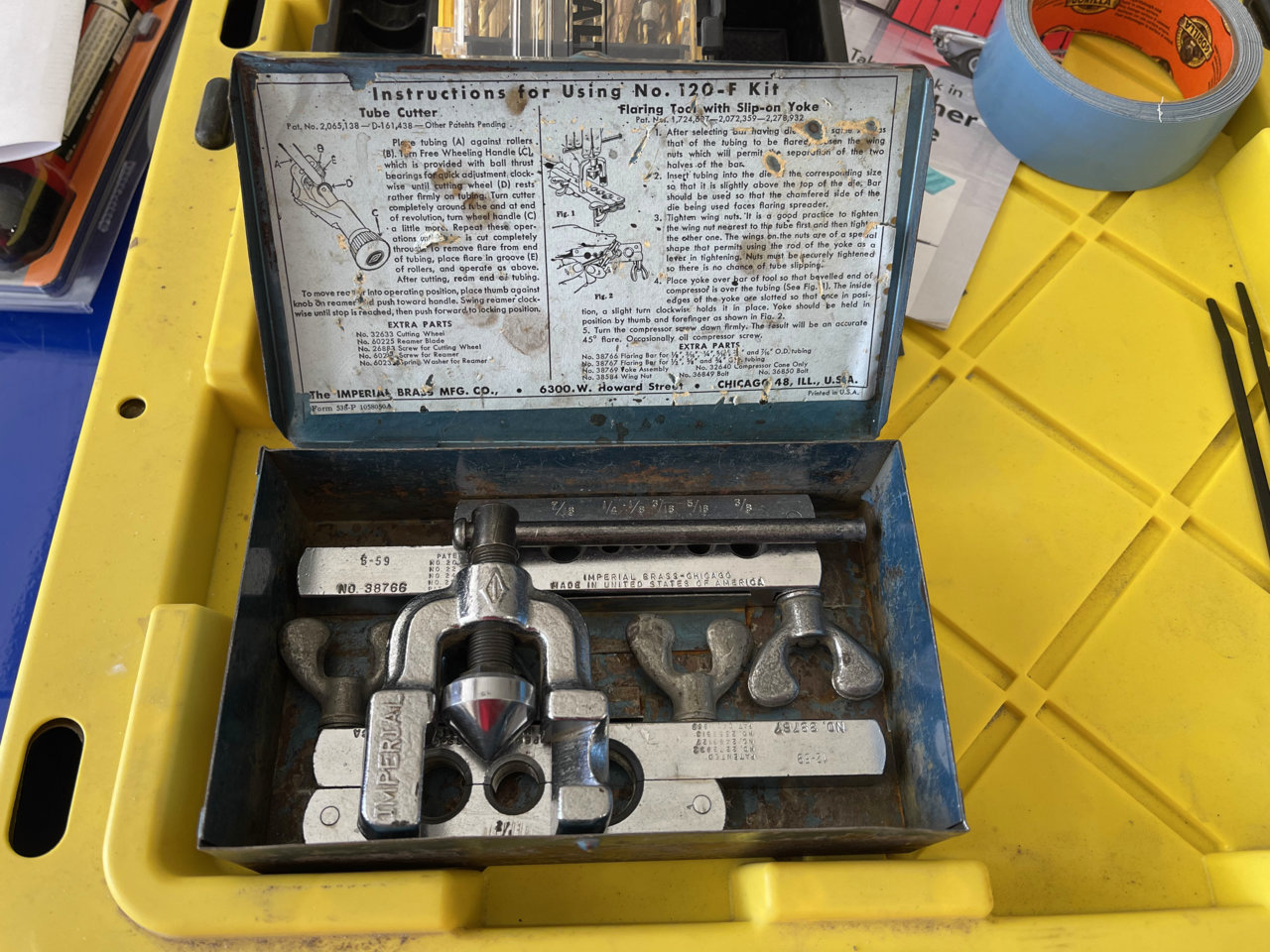

    My father-in-law gave me a cool old flaring kit, it's just missing the little adapter bits to make the double flares. I had some of those from an old harbor freight set that is missing other parts.
    I should have the rest of the parts by next week.

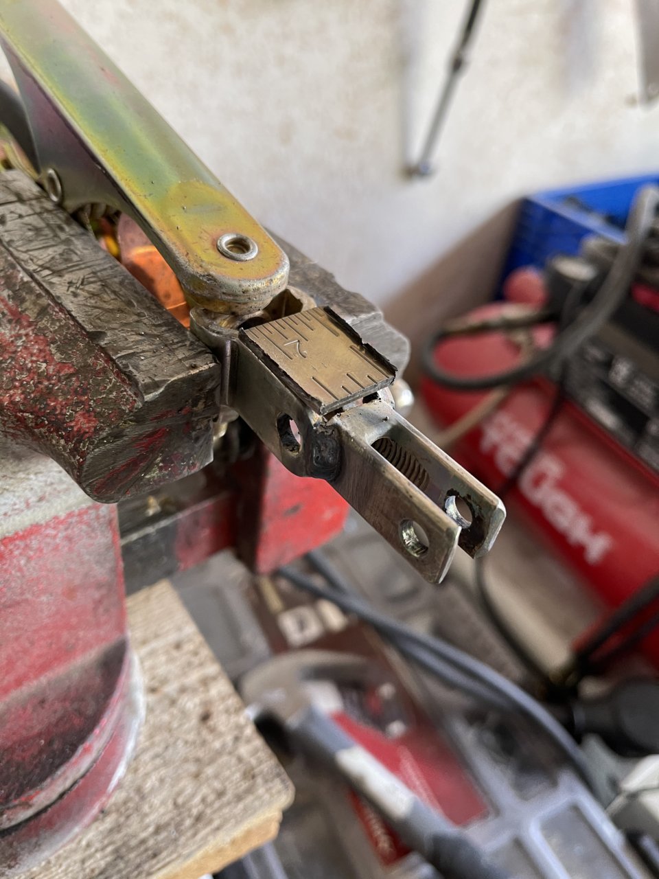

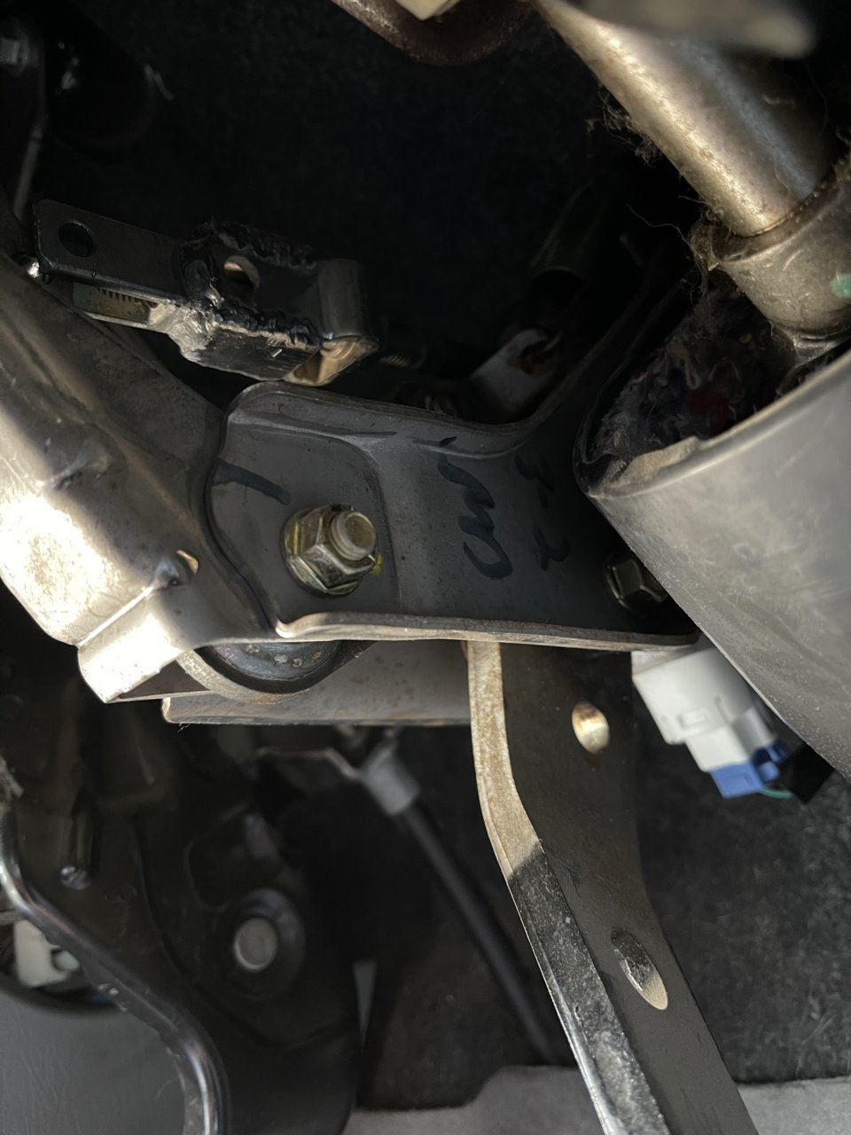

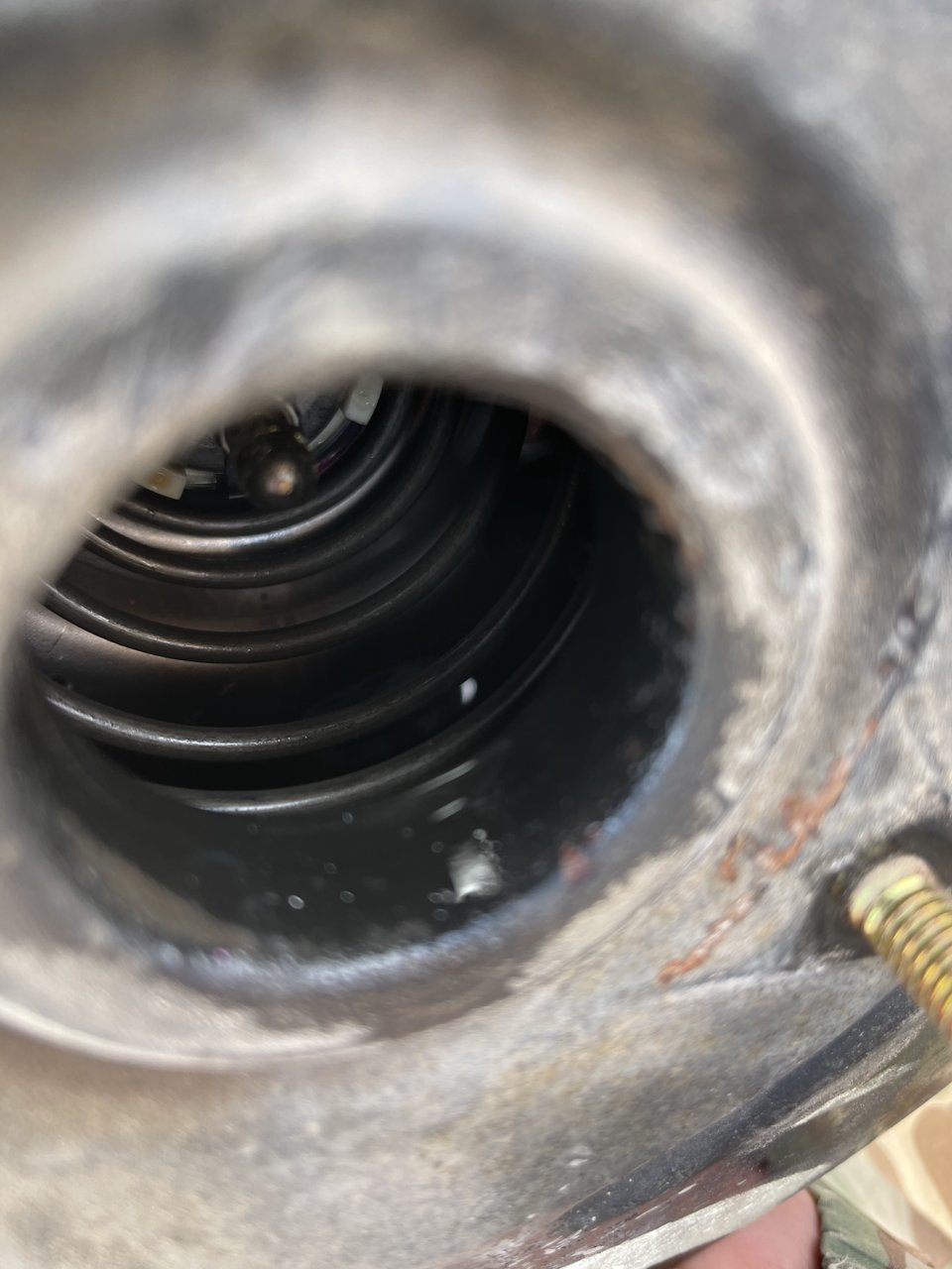

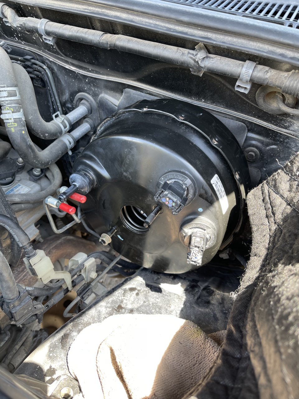

    My brakes decided to stop working well the other day, I tracked it to the MC leaking into the booster.
    So I did a Tundra Brake Booster and Master Cylinder upgrade. It was a little frustrating because I kept getting negative measurements for the booster pushrod to master cylinder clearance.
    I measured everything again to double check and then triple checked those and I guess I had the wrong numbers before because I ended up with a .020 gap four times. Good enough for me.
    Popped right in place! Some reports said they almost took a hammer to the fender to install it but I didn’t have any issues with it.
    Tube bends could have been better but I was just a bit on edge at that point :rofl:
    Welded up the clevis bracket, it wasn’t perfect but who’s going to see it. Aside from the public pictures I’m posting here.
    I tried to get a picture of the fluid inside the old booster but it was a weird angle. It was just about a pint and a half in there!

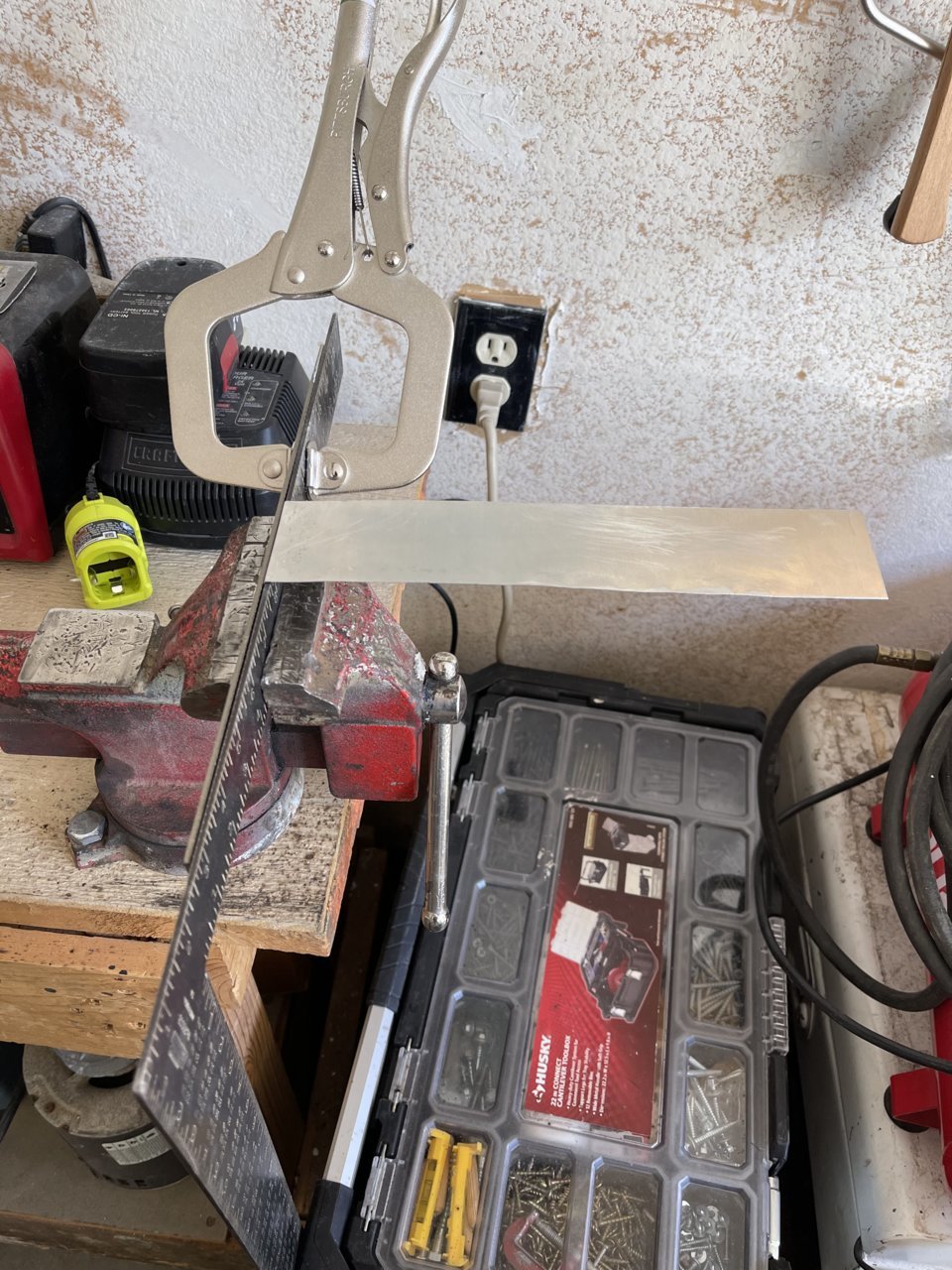

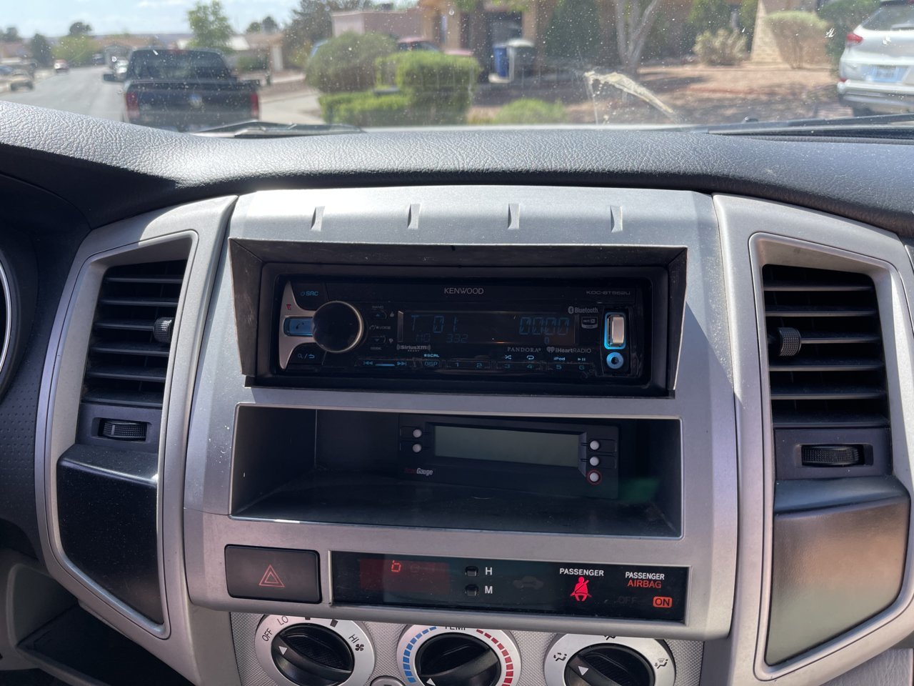

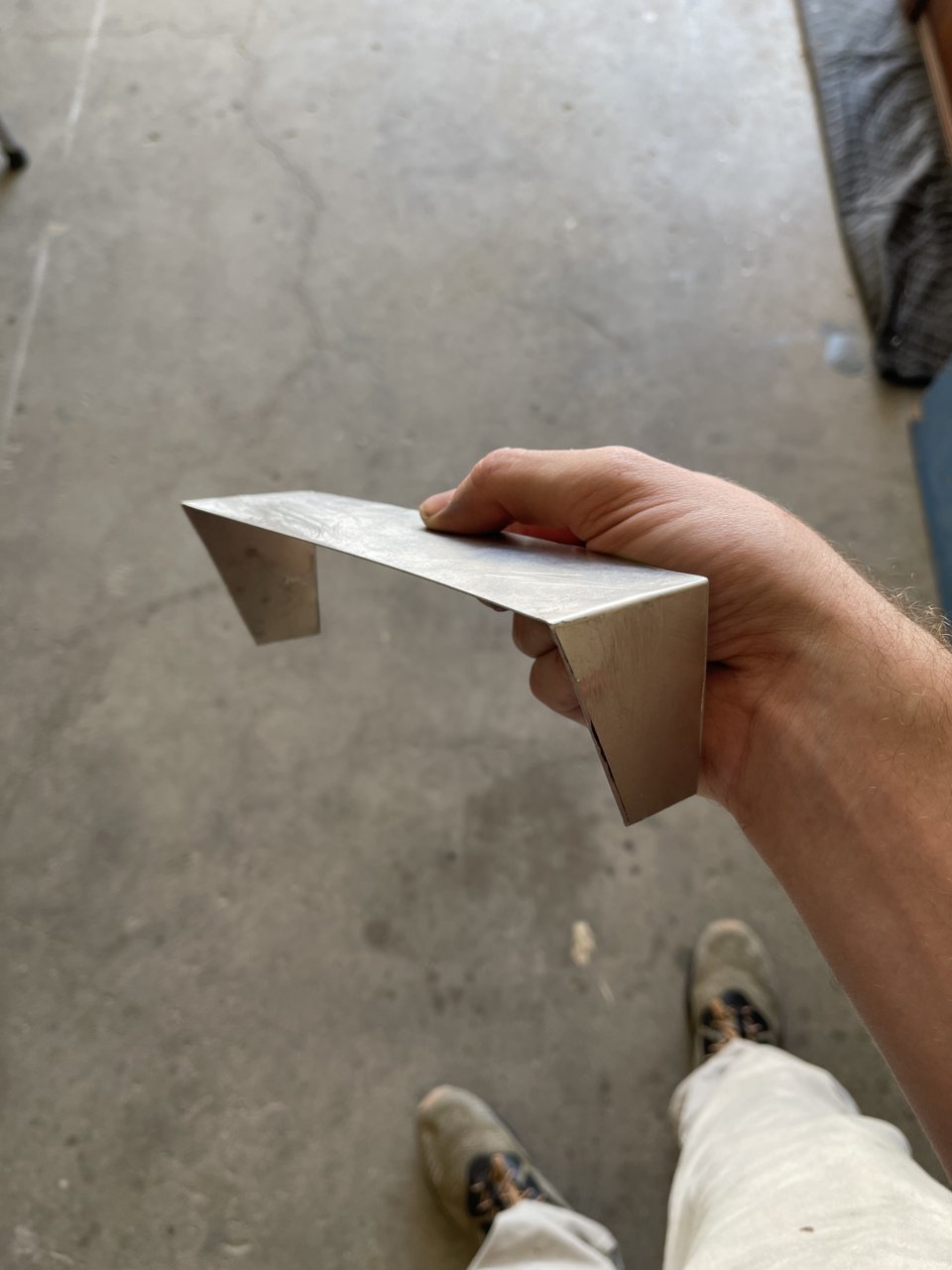

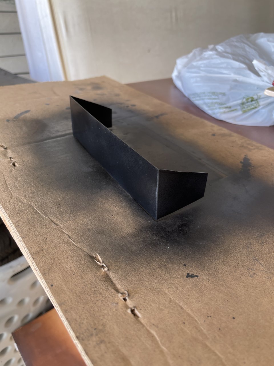

    I had some thin sheet steel I picked up a while back and finally got around to making a radio shroud. Design courtesy of @hemitruk
    My DIY metal brake, worked out pretty well.
    Cut the angles and filed the edges.
    Test fit, looking good!
    And paint, I’ll install it when it’s fully cured.

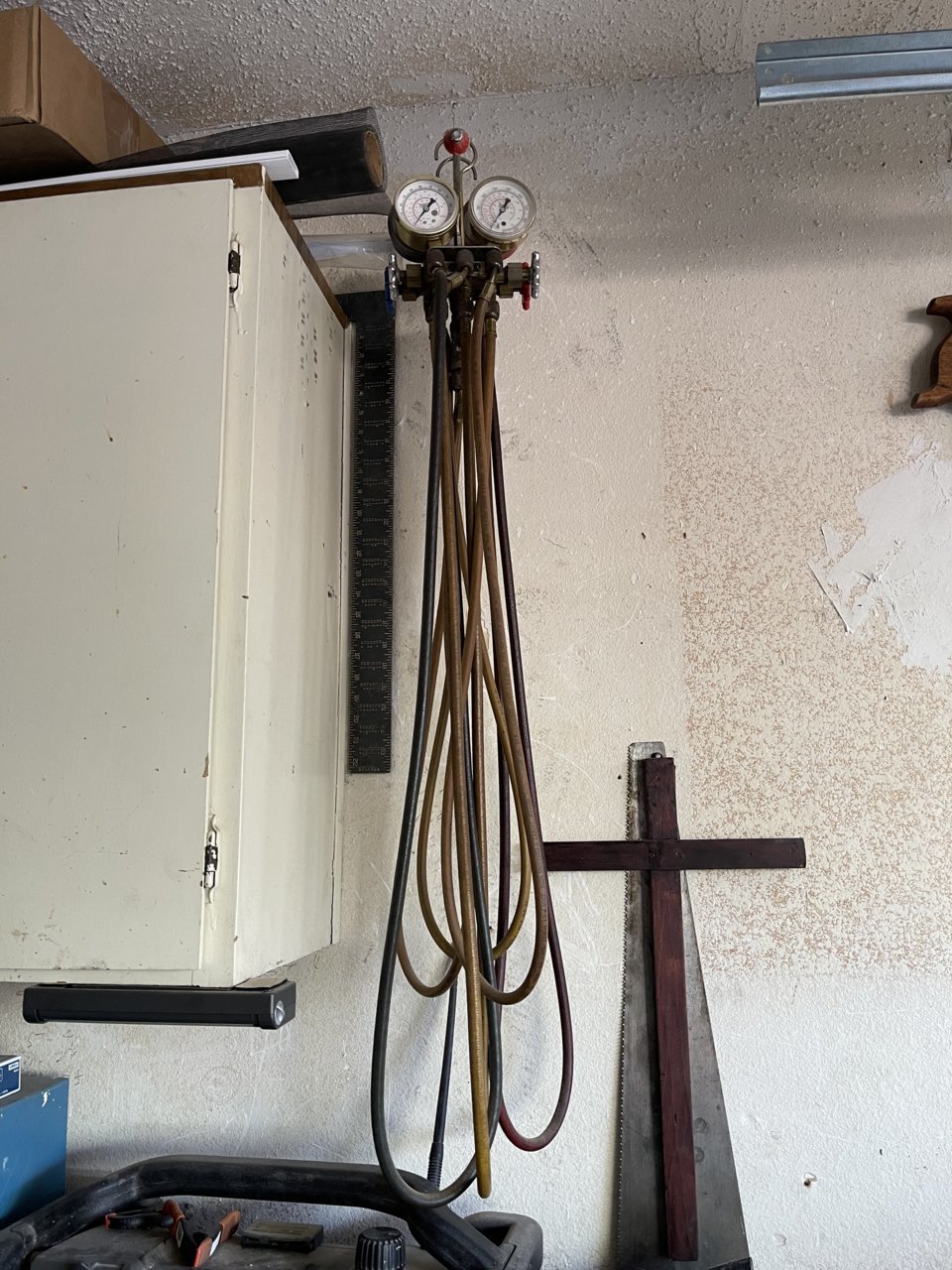

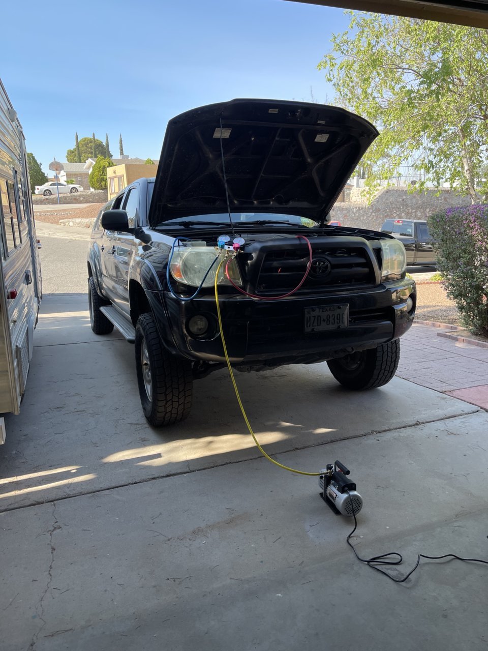

    With 108 degrees of summer already beginning here in West Texas I decided to finally fix my leaky low pressure schrader valve.
    Picked up a gauge set and vacuum pump from Harbor Freight, cheap and effective.
    Pulled -30 with the pump and the system held it for an hour. I’m just doing the final vacuum before hooking up the 134.
    My father-in-law has two manifold sets that I was hoping I could use but they’re both R12 sets. The hoses look like they’ve seen better days too.

    The parts guy gave me the wrong valve, for R1234yf instead of R134 so it wouldn’t fit the can. I just didn’t notice the number on the package. Also tried an older one I had handy but the seals were shot.
    Got that returned and sorted with the proper valve. Picked up some oil just in case, PAG 46 according to this,
    https://www.tacomaworld.com/threads/rl-897-a-c-compressor-oil-my-pain-your-gain.240794/
    Had a big can of that fancy AC Pro Freon but the valve with the bad seals jacked it up and it dumped the whole can. That sucked.
    I got it all sorted though, it’s cool now!
