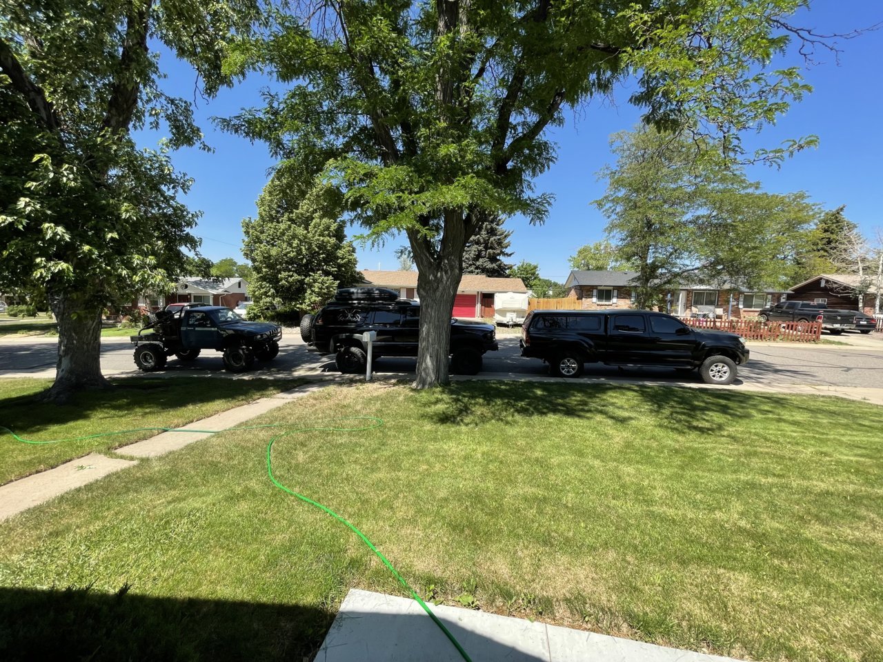

    Went to Yoda Jim’s in Denver!
    He didn’t have what I was after but it was awesome walking around a junk yard full of just Tacomas and 4Runners and old Toyota Pickups.

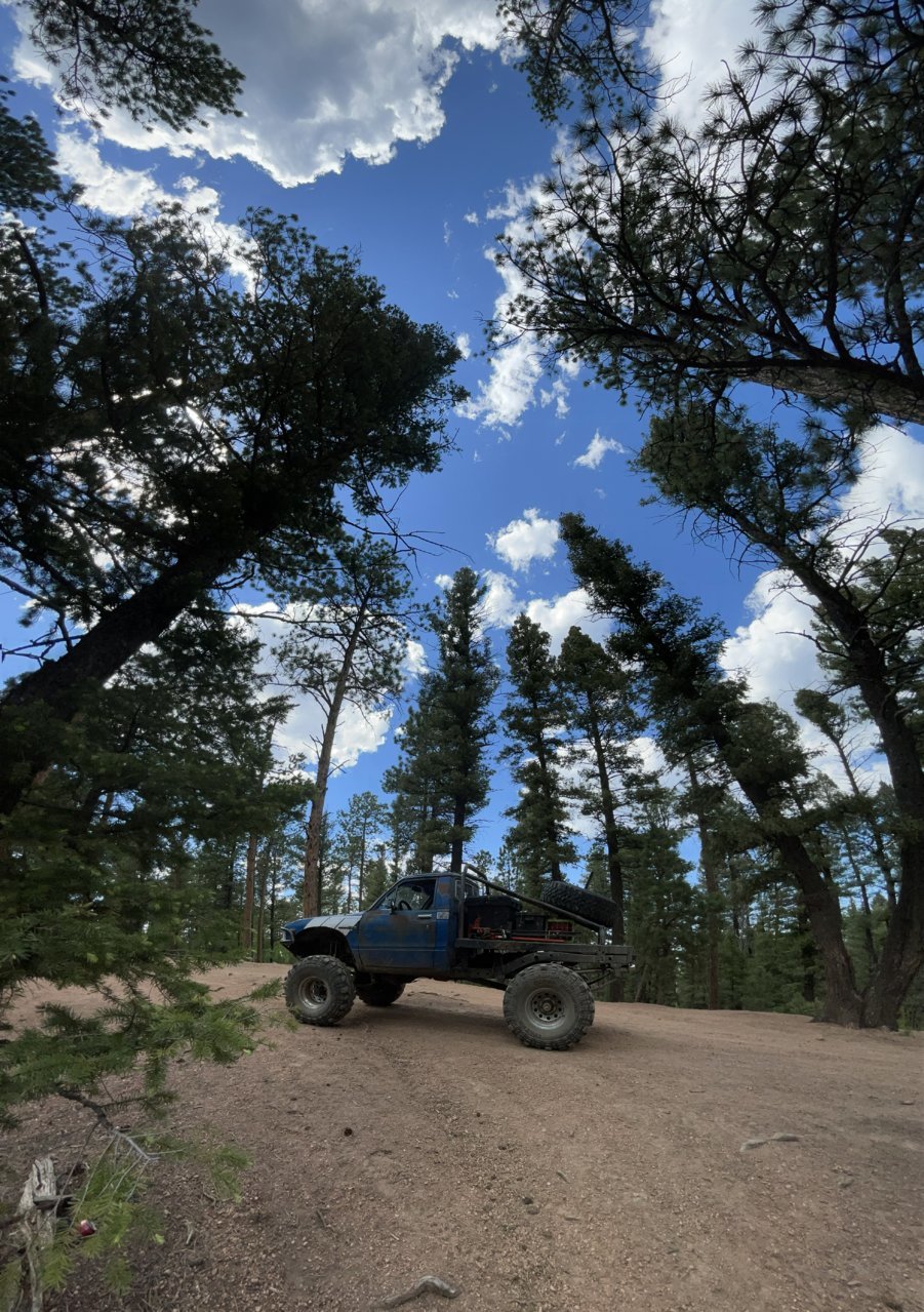

    Last day in Denver my Uncle took me up to the mountains in his bought-new-by-him in 1982 Toyota Pickup. Extensively modified.
    This last one is my truck then his friend’s Tahoe or suburban thing and then his Toyota.
    Quick trail repair :rofl:

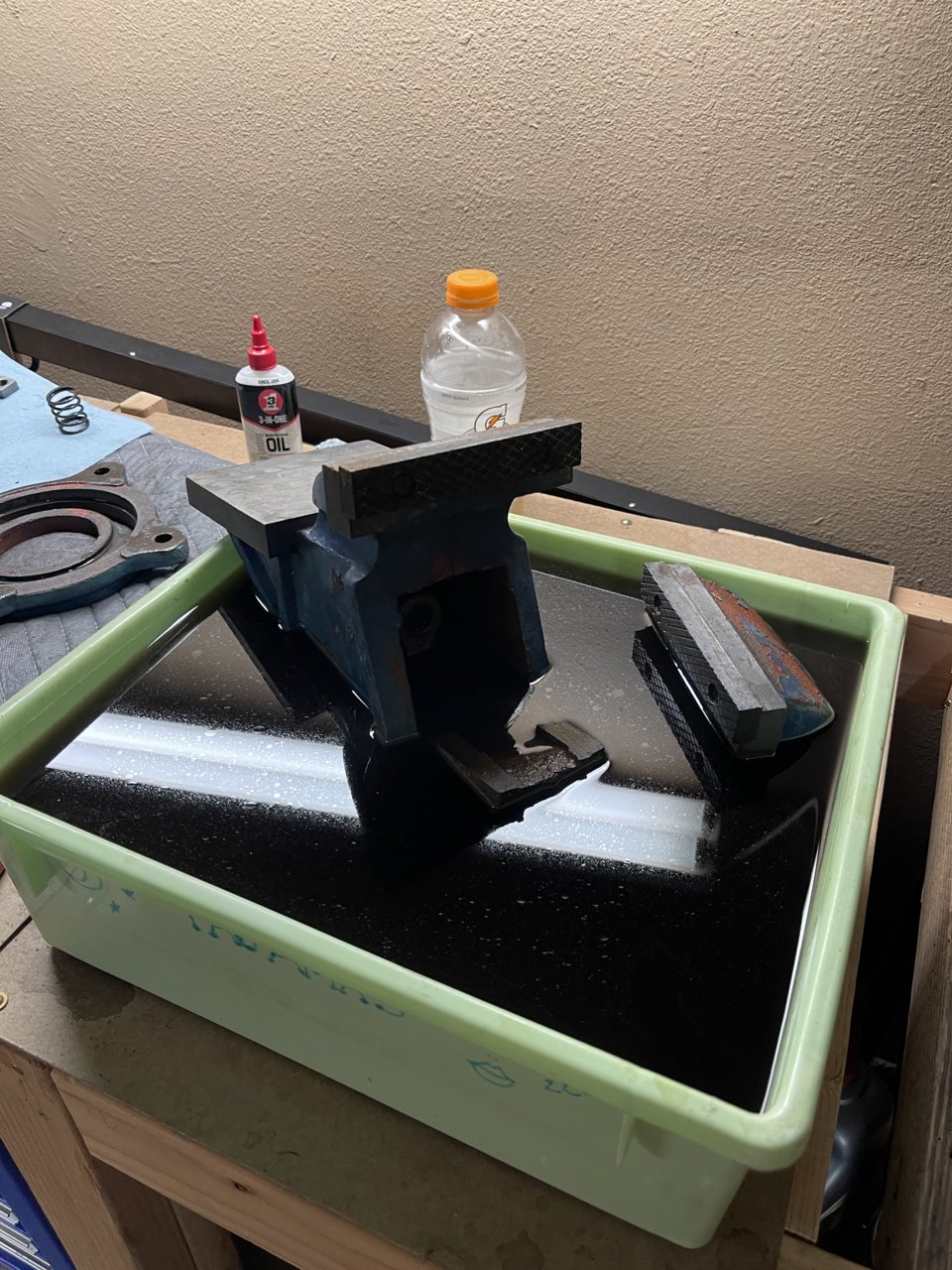

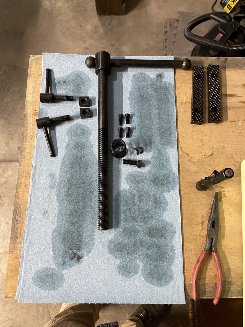

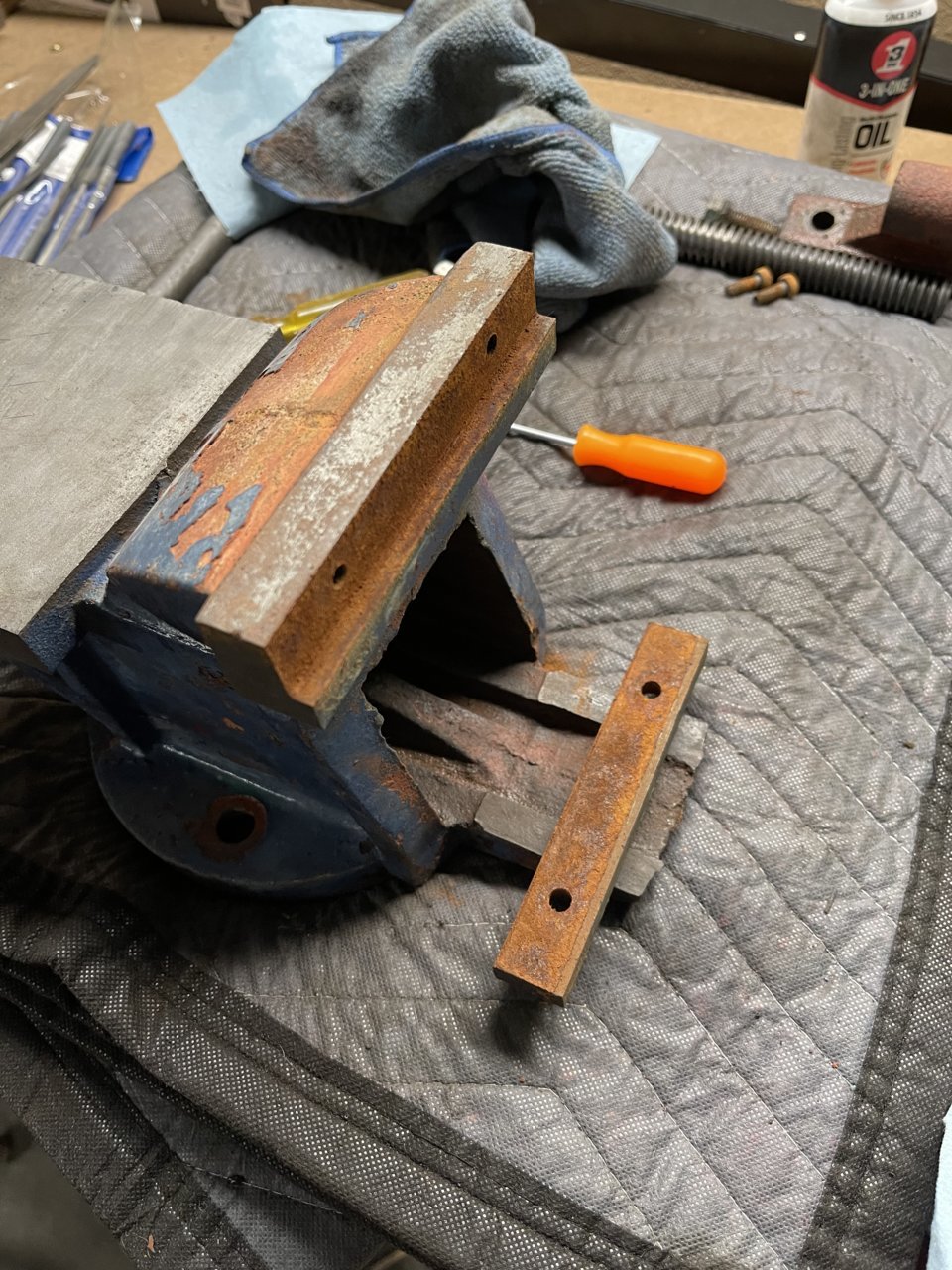

    Got a rusty bench vise for free a while back, I just finished fixing it up. I just did some cold bluing on the exposed metal bits and used some brown paint I had kicking around. I like how it turned out. It’s 45lbs.
    Here’s the journey!

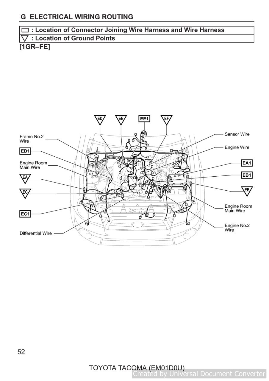

    Is your CEL on with the key on?
    Does the tach move while cranking?
    I'm kind of assuming it has spark since you say it runs on starting fluid but I have seen engines that didn't have spark try to run on it, usually carb cleaner is a better option to try to see if spark and timing is correct to run.
    Have you checked for power at the injectors & coils?
    Grounds on he back of the cylinder head are another good place to check.
