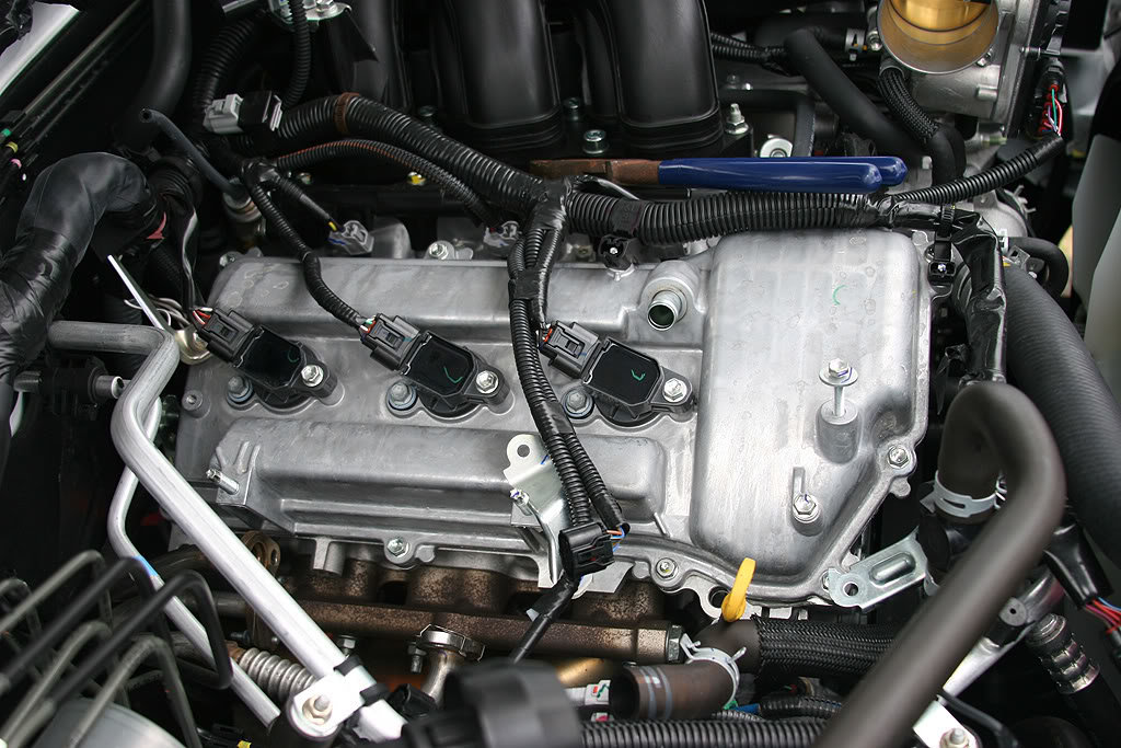

    not the best photos but just something for reference.
    2012 and up
    2005-2008. 2009-2011 have a more refined design.

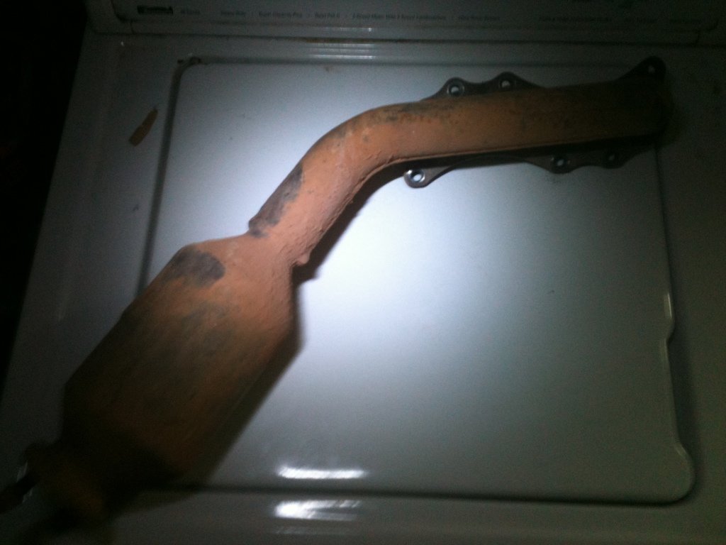

    Second picture is '05-'08. Just for added clarification.
