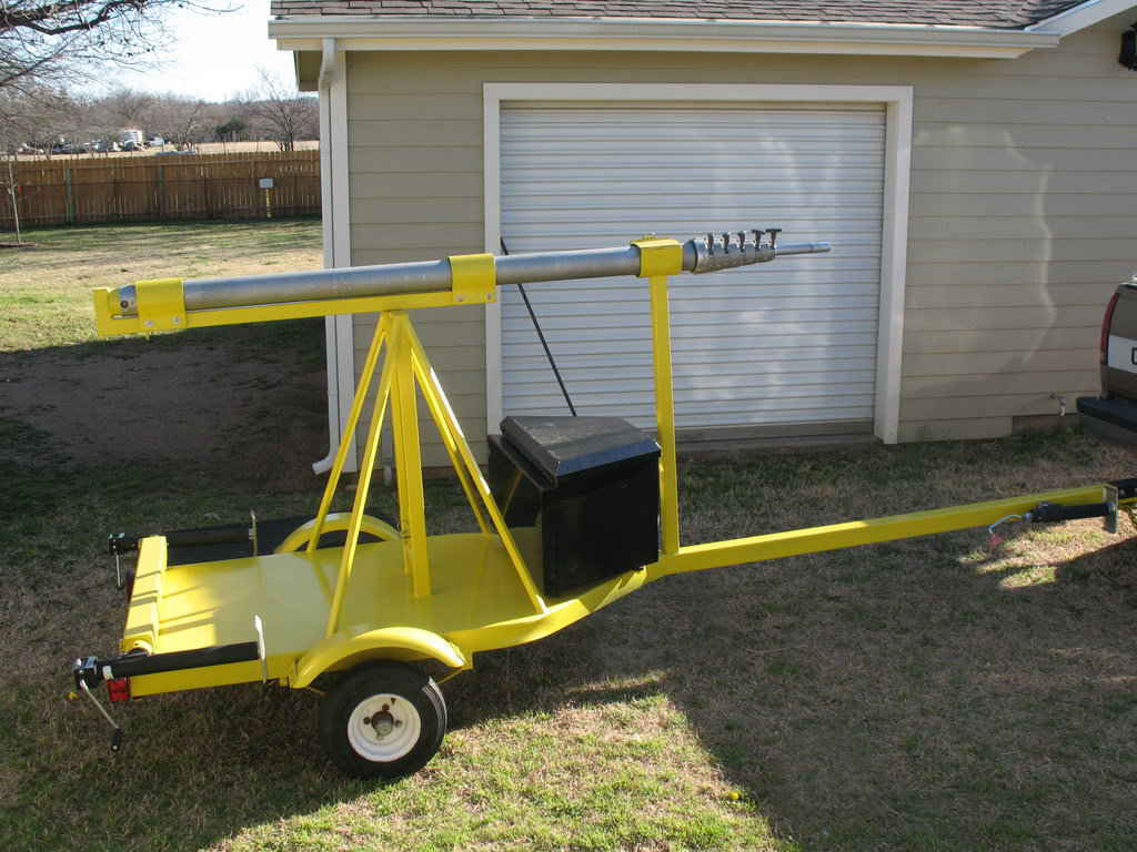

    Here is a photo I took last Saturday:
