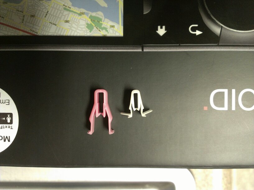

    Here is a pic of the clips. The larger is the replacement instrument panel clip, and the smaller is the mirror garnish clip that I'm looking for.

    Alright, for those that might need this in the future...
    I finally went to the dealer, and the part number is 67771-58010.
    If you order from the dealer, they are about $4 each, OR you can get them from clipsandfasteners.com, and get 25 for $12.

    Can anyone confirm that this actually fit? I asked for this part number at my dealer and they gave me a clip that looks just like it but is maybe 1/4 inch wider and will not fit. Its possible they gave me the wrong one but on clipsandfasterners it says its for a tundra 07 and up.

    I know it fits '05 Tacos, but other than that...

    I ordered it and now can confirm it to work, on a 2015!
    What a shame that I can do some googling and order the part number on the internet and it's correct, but go into the dealership and they give me the wrong ones as 12 times the price. Ugh.

    Larger, yellow clip on the left the part number is:
    90467-10203.
    Should be less than a buck a piece. I just picked some up last week for my interior / dash.
