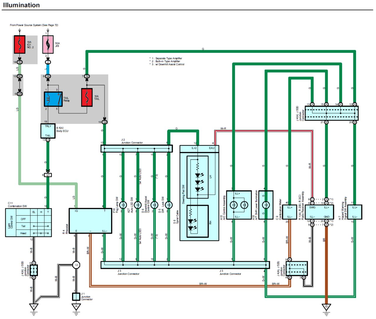

    The combination meter illumination bypasses the dimming rheostat.
